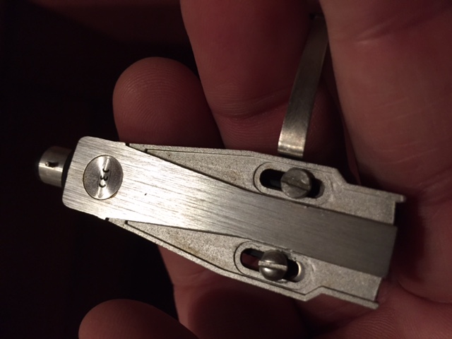

Thanks again everybody. So the history my dad bought this in the mid 70's I thought new but it may have been a trade too? It's pretty much original except for the CEC headshell and somebody has put rca terminals to the rear without an earth point! I have since earthed it but it's not right through . There's definetly something interfering in the arm /connector. I have purchased the ortofon headshell cause it came with bolts and leads. I have a spare M 95 ED cart as well so will set that up with a new stylus. I am going to rewire the tonearm and put new RCA leads through the back (with earth) try and get the strobe light going (globe is faint) oil the motor then use it again. My preamp is a rotel 990 with ability to do MM or MC It's a little bit labour of love because it was dads and I used to love playing with it as a kid and being told "to be careful" might lare it up a bit with a technics skip mat lol -

Thanks all. currently in Japan and going to pick up some wires this afternoon. The only headshell they had was the ortofon 4 which looks nice but I don't think it will be as good as my CEC as its a cast shell although if the plug is dodgy. Million needles to choose from. Might weight and go to another store in Tokyo. -
I have revived my dads old technics sl1500. It sounds overall great but there's a mild hum? I have done the weights and tracking. The wires on the cartridge are shocking and the screws look Suss! So was going to get some new wires and screws (ebay) The cartridge is an original 70s shure M95ED it never got played a lot . I have a spare too. The head shell is a CEC and looks to be cast alloy. I have attached a few photos. I like to go over it and check the wiring in the arm too. But next week I will be in Japan and just wondering if it's worth picking up a new cart for it up there? One of the denons? Are they cheaper in Japan and what would be a suitable cart for the technics 1500
