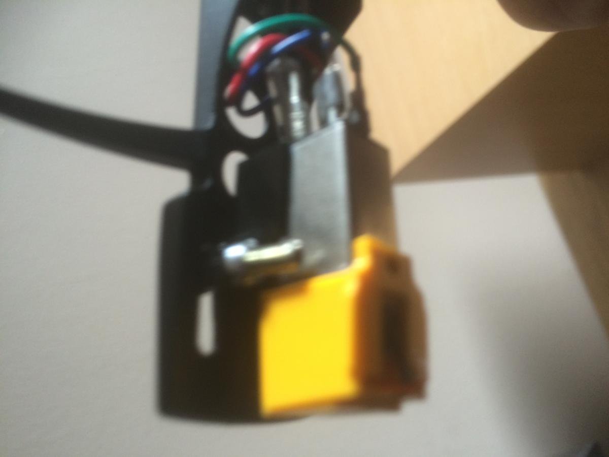

Speedycat69 Posted April 6, 2016 Posted April 6, 2016 ive had a 2nd hand numark pro tt1 for a few months . I tried fit a groovetool cartridge to it and god was awful ,put the usual one back on (,wires in cartridge don't look the best) . when I put tonearm down it makes a scraping crackling sound before music starts and during in speakers and unit .think cartridge is way too low too . plays through a denon system . Thinking I should go and buy a decent player now rega rp1 or a project debut 3 ee now. Buying a non dj tt makes sense if its for just home listening ? think pics have uploaded upside down lol
Guest Muon Posted April 6, 2016 Posted April 6, 2016 (edited) Neil, do you have a clearer pic of the underside, like that first pic you posted but a clear shot of it? That last pic is not of it in play is it? with the arm down...if it is, stop playing it now A Debut Carbon maybe, not sure of the RP1. That cartridge/stylus might just be stuffed, if that last pic is it in play, Neil. Or you have the tracking force set way too heavy. Edited April 6, 2016 by Muon
EV Cali Posted April 6, 2016 Posted April 6, 2016 Agree you have the tracking force set way too heavy. Set counter weight so that arm balances and floats ,turn front numbered section to 0 , turn the whole counter weight to 1.5 . nothi9ng wrong with your present Turntable . See my first post in you introduction.
Speedycat69 Posted April 6, 2016 Author Posted April 6, 2016 Yeah particle thats it in play ,the counterweight at back of arm is set at 2.5 , as you can tell im very new to tt set ups lol , when i had one years ago was just a hi fi and no messing about lol .
