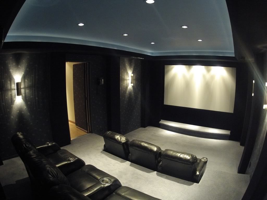

Guest Peter the Greek Posted June 3, 2016 Posted June 3, 2016 A dark ceiling is ultra important, light colours are like mirrors for lighting, especially in front of the screen. Also, we went a matt finish, this has better light absorption, but is harder to keep clean/with scuff marks. Not necessarily. Dennis Erskine has been known to make them light blue (creates a nice ambiance on all accounts): "Here's the mix numbers using Olympic Interior Latex Flat Base 3 (72003). 101 0 Y 6/48 102 3 Y 6/48 115 2 Y 2/48 113 1 Y 12/48"
Kaynin Posted June 3, 2016 Posted June 3, 2016 Nice, beautiful ceiling. I wonder if the performance would improve if he went the night sky option... 1
