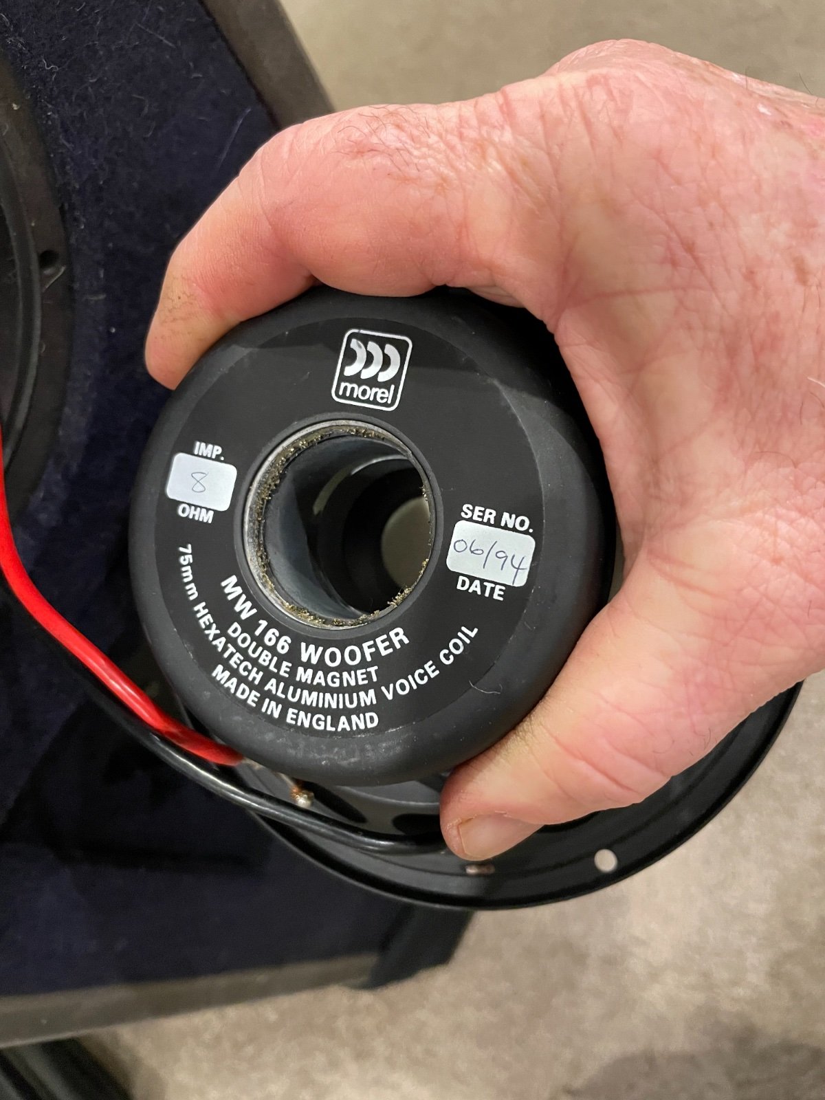

Got these little suckers recently.
Going to give them a full refurb.
Loving listening to them for now until I start stripping them.
@Grizzly is sourcing some new brass plates. @Bill125812 has supplied a bunch of wire to redo the internals.
@Sub Sonic has also supplied some very rare Duntech goodies and the cabinets will be handled by myself. Aranmar are replacing the grill cloth.
@frednork was kind enough to let me pry them out of his hands. I’ll be sure to treat them well!
