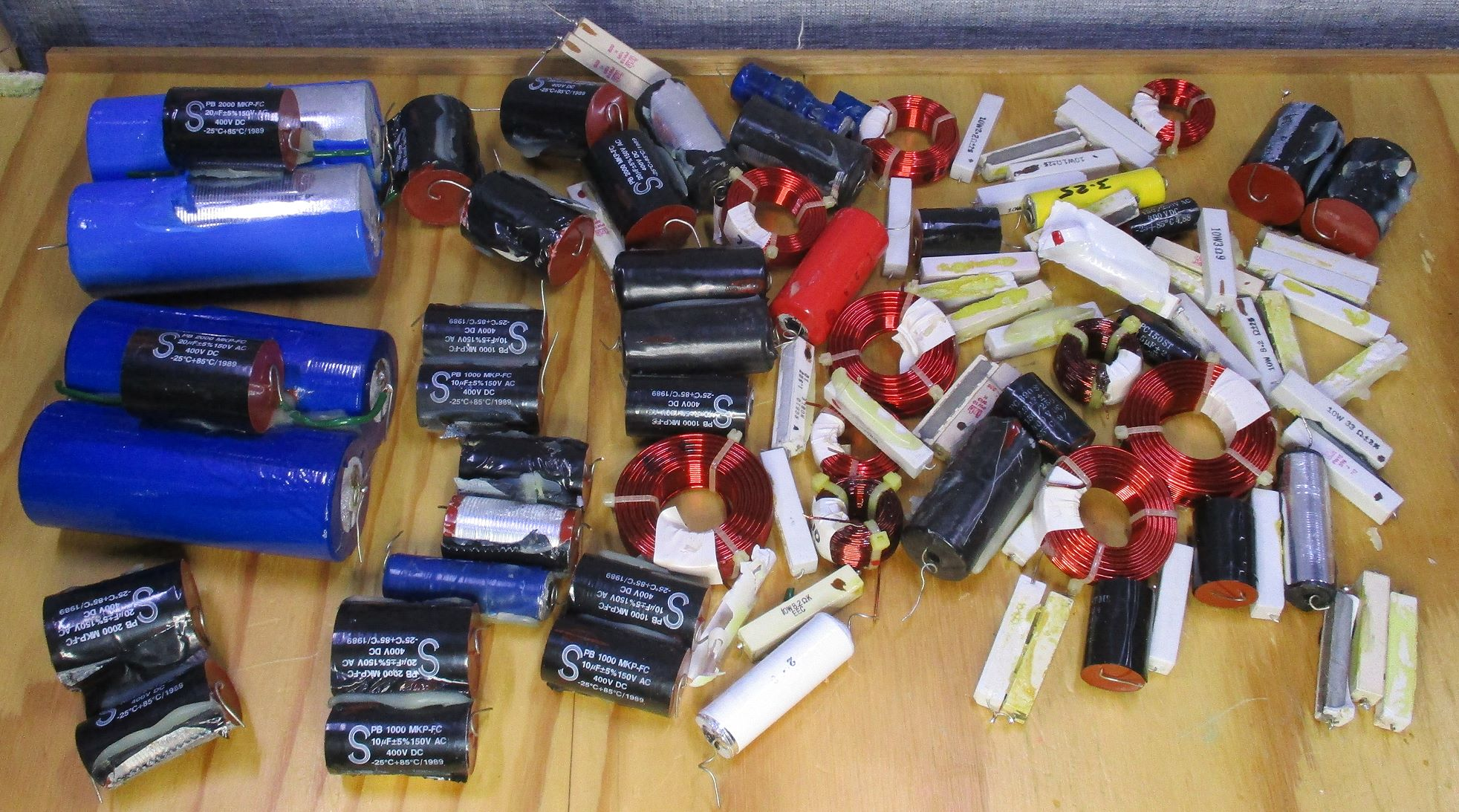

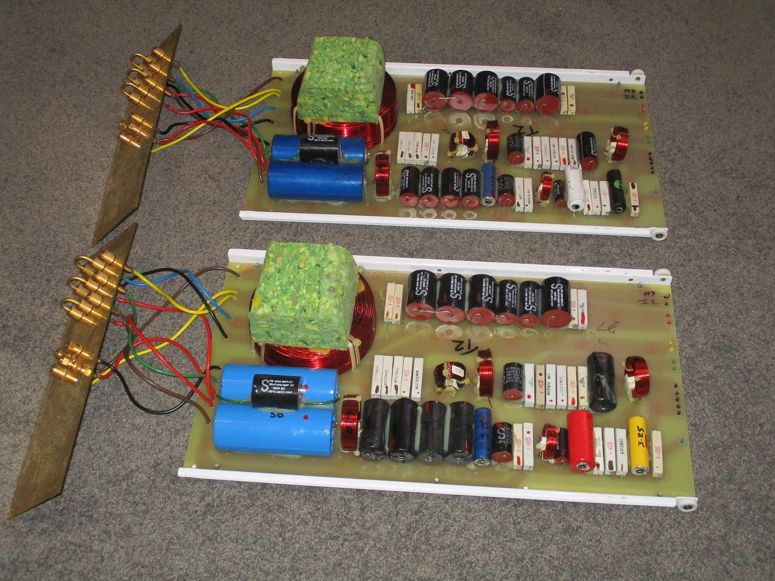

Just thought I would provide an update on my Sovereigns and the recent issues I have had. Over the last year or so I have felt like they have slowly been sounding worse with each rotation into my system. The Crown Princes, 1400 Arrays and the 4355s have been getting far more play time and I was convinced something was wrong with them.
I had Nigel from Speakerbug come over as I trust his ears and his ruthless opinion when asked. We played the Crown Princes which sounded great, they always have. Then we rotated the Sovereigns in, they showed signs off brilliance but overall something didn't sound right and I couldnt figure out what it was. Nigel mentioned the mid-bass drivers sounded down in output and if I had to guess previously what was wrong, I would have said the bass so I wasn't far off. The soundstage was no where near as large as it had been and the dynamics had suffered greatly.
Nigel has the capabilities to test the drivers so I removed all the mid-bass drivers and gave them to him. He replied back later that night saying everything measured perfectly, no issues at all. I was hoping this would be the case and the crossovers became the next target. I removed the networks and took them to Nigel for measuring and to provide a schematic to the Duntech community as there isn't one available. Upon initial tests everything seemed to measure perfect, every component was well within tolerance so I was a little dumbfounded and apprehensive to take it further. Anyway I gave the green light the to replace all the resistors with 1% MOX resistors doing away with the sand casts while keeping exact values. Also every capacitor would be replaced keeping the tolerances within 2% using exact values and paralelling multiple values just as Dunlavy did. For whatever reason I didn't want to replace the woofer caps for example with a single 120uf cap, I want to use 2x50 and a 20 just as Dunlavy did. I assume he did it for a reason, maybe not but for my peace of mind I wanted to keep it exactly as original.
Getting a little too in depth here but long story short once the boards were stripped the ESR of the caps was measured and the Solen caps showed some really high ESR's, some as high as 8 ohms and plenty ranging from 0.5 - 1 ohm. Also between the two networks different brand caps were used. My crossovers consisted of Solens and Rifa caps which had been removed from their plastic case and wrapped. One speaker had the rifa's in the mid-bass and the other had Solens. Unsure if that would make an audible difference but it was weird.
Still waiting for parts to come in stock but the capacitors being used are a mix between the Jantzen Standard Z Caps and Superiors. Will provide and update once they are up and running and a schematic once I have it.

Just a follow up on the Sovereign network rebuild. I copied the below from DIY Audio where Nigel from Speakerbug posted about the build.
Some were upset by my last Repair / Rebuild.
So all I will say is this.
They sounded like rubbish before.
No treble, and one side had almost no mid-range.
I investigated, found many issues, and it was decided to do a full rebuild.
These are factory original. Matching serial numbers. Never touched before now.
Did you notice one side using different parts ? From the factory.
After the rebuild using far superior parts, everything is now working as it should.
Plus some.
To head off all the old worn out arguments.
A lot of the capacitors are in parallel banks. The capacitance of each bank was matched to the original.
The old inductors were measured, and the new inductors were selected for correct inductance AND dcr.
If the owner wishes to comment further (they are a member here) then that is up to them.
Plus some.
lovely work from Nigel as always.
But, what do you think now Chris?
