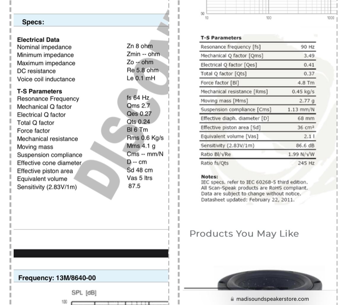

sockpuppy Posted July 19, 2023 Posted July 19, 2023 3 minutes ago, Jakeyb77_Redux said: I would buy the pair you find now and use them while waiting (if that’s what you want to do) for an original driver to come about. You could always sell the X pair then or keep for spares. Yes good advice I will do that. For those who want to Nerd up on Dynaudio 24W75 XL vs standard here are the spec sheets. 2
Jakeyb77_Redux Posted July 19, 2023 Posted July 19, 2023 3 minutes ago, sockpuppy said: Yes good advice I will do that. For those who want to Nerd up on Dynaudio 24W75 XL vs standard here are the spec sheets. Hmmm better bass, now the discussion starts. Place them as the top or bottom pair

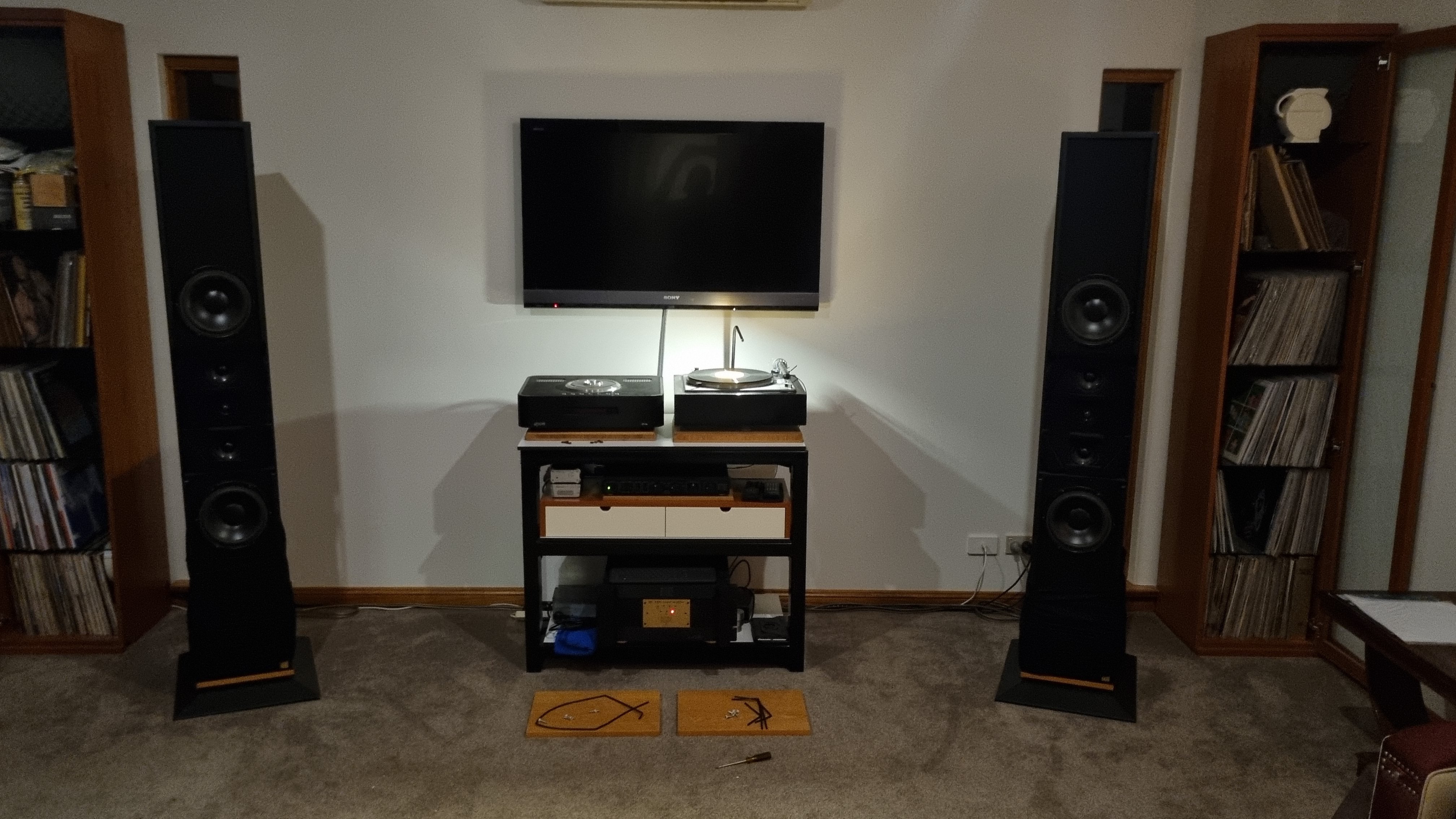

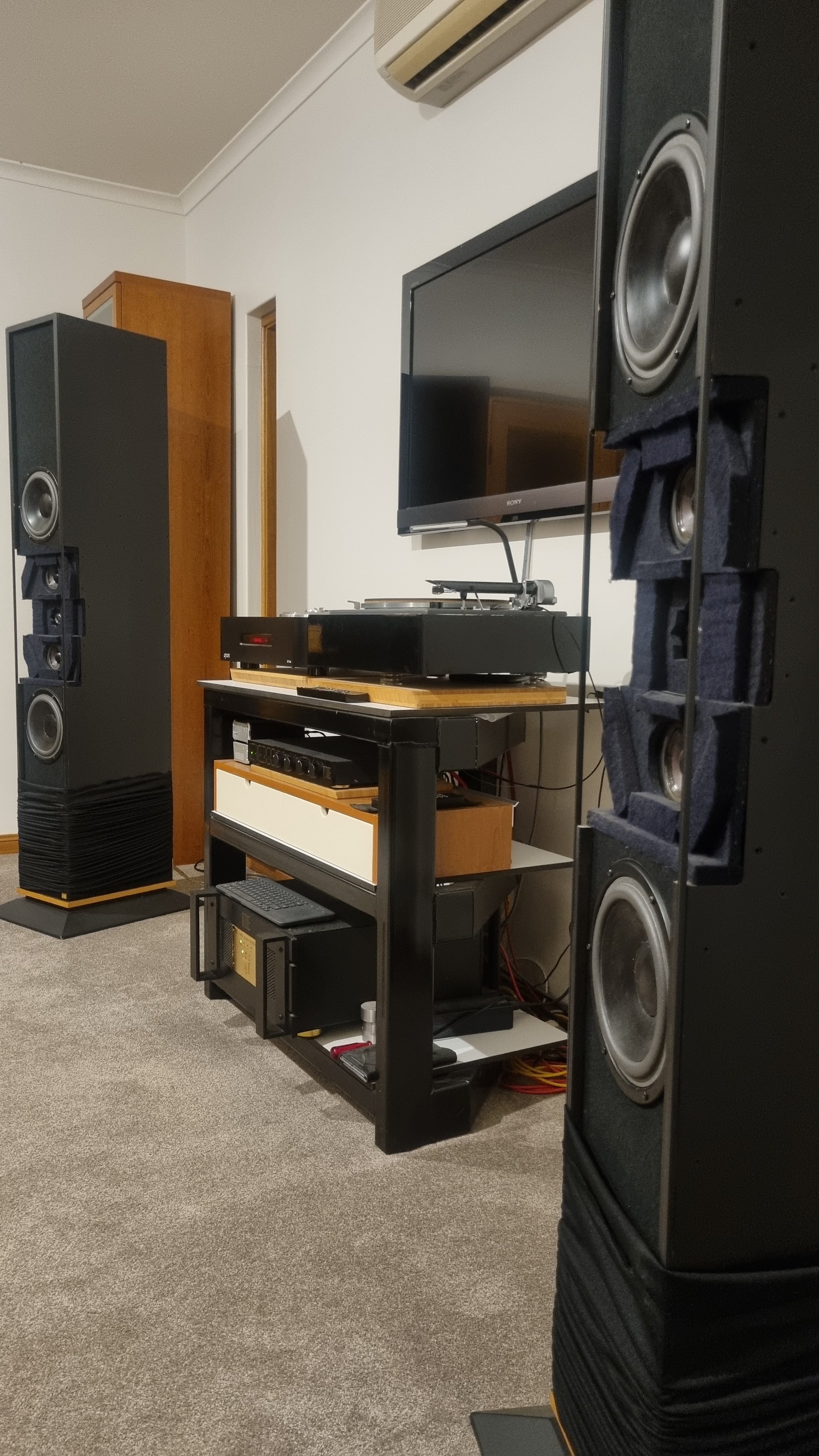

sockpuppy Posted July 20, 2023 Posted July 20, 2023 (edited) Disappointingly, after getting my drivers back, plugging them in, I tested the Princess. with an old Rotel Amp. All three drivers were working, including both tweeters. However, upon closer inspection, it appears that all four Scan-Speak 13M / 8640 drivers are silent. I could have imagined one or, at worst, two not working, but the fact that all four are malfunctioning seems odd—what are the odds of that happening? Could this issue be related to the crossover? What to do next? Crossovers look OK, cannot see anything physically wrong with the capacitors The only thing a little funky is the a few of the resistors, however I think I am just seeing solder flux rather than a problem Edited July 20, 2023 by sockpuppy
VanArn Posted July 20, 2023 Posted July 20, 2023 There are many instances of ScanSpeak drivers going open circuit as a result of electrolysis at the connection of the flexible braid to the voice coil lead out wires. The condition is indicated by a dark patch under the adhesive holding the joint to the cone. Delicate repair work is needed as the cone is fragile. 2
kelossus Posted July 20, 2023 Posted July 20, 2023 39 minutes ago, sockpuppy said: Disappointingly, after getting my drivers back, plugging them in, I tested the Princess. with an old Rotel Amp. All three drivers were working, including both tweeters. However, upon closer inspection, it appears that all four Scan-Speak 13M / 8640 drivers are silent. I could have imagined one or, at worst, two not working, but the fact that all four are malfunctioning seems odd—what are the odds of that happening? Could this issue be related to the crossover? What to do next? Had the same experience with my first pair of Princess'. All 4x Scanespeak drivers were DOA. Like VanArn stated the braid wire had gone open circuit. 1
Jakeyb77_Redux Posted July 20, 2023 Posted July 20, 2023 @sockpuppy yes the mids are a known problem speaker. This is why I have collected as many spare parts for this model speaker as I can find as they are VERY rare especially in working order. @kelossus is currently searching for some mids as well. While these Duntech speakers are great, unfortunately being so old they have major problems if you have any issues at all due to the unavailability of parts. You may be able to get the mids repaired. I think Atilla’s son Adam has been repairing speakers after his Dad passed away sadly. Search the forums for a contact number he’s in Thomastown
sockpuppy Posted July 20, 2023 Posted July 20, 2023 13 minutes ago, kelossus said: All 4x Scanespeak drivers were DOA. Hmmm, OK same problem then, all 4 silent. Has anyone had scan-speak mids repaired successfully? 8 minutes ago, Jakeyb77_Redux said: You may be able to get the mids repaired. I think Atilla’s son Adam has been repairing speakers after his Dad passed away sadly.
kelossus Posted July 20, 2023 Posted July 20, 2023 Just now, sockpuppy said: Hmmm, OK same problem then, all 4 silent. Has anyone had scan-speak mids repaired successfully? I've had all mine successfully repaired. Like most I am now looking for spares.
sockpuppy Posted July 20, 2023 Posted July 20, 2023 3 minutes ago, kelossus said: I've had all mine successfully repaired. Like most I am now looking for spares. Whas that with Atilla or someone else?
kelossus Posted July 20, 2023 Posted July 20, 2023 4 minutes ago, sockpuppy said: Whas that with Atilla or someone else? Queensland Speaker Repair
sockpuppy Posted July 20, 2023 Posted July 20, 2023 (edited) 45 minutes ago, kelossus said: Queensland Speaker Repair OK I used him to do the drivers refoam so I will ask , what sort of $ am I looking at? Edited July 20, 2023 by sockpuppy
kelossus Posted July 20, 2023 Posted July 20, 2023 1 hour ago, sockpuppy said: OK I used him to do the drivers refoam so I will ask , what sort of $ am I looking at? I believe you used Brisbane Speaker Repair. Different business but just as capable.
sockpuppy Posted July 20, 2023 Posted July 20, 2023 (edited) 39 minutes ago, kelossus said: I believe you used Brisbane Speaker Repair. Different business but just as capable. Opps ... Brisbane or Queensland ... all the same place for me Edited July 20, 2023 by sockpuppy 1

Sub Sonic Posted July 22, 2023 Posted July 22, 2023 Has anyone tried this driver as a replacement for the 13M? Not cheap but might be worth a look at if someone is really stuck. https://www.madisoundspeakerstore.com/approx-5-midrange/scan-speak-13m-midrange-replacement-speaker/
Jakeyb77_Redux Posted July 22, 2023 Posted July 22, 2023 2 hours ago, Sub Sonic said: Has anyone tried this driver as a replacement for the 13M? Not cheap but might be worth a look at if someone is really stuck. https://www.madisoundspeakerstore.com/approx-5-midrange/scan-speak-13m-midrange-replacement-speaker/ Have you compared the specs @Sub Sonic? I’d be keen to try them if they were very close.
