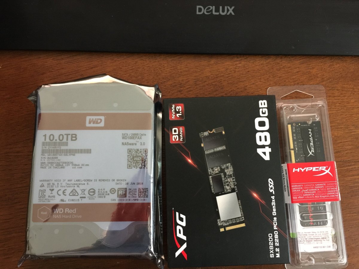

kukynas Posted July 14, 2018 Posted July 14, 2018 it took little bit longer than originally expected but finally had a chance to grab one with all the goodies third disk arrived later today with SSD cache and extra memory I don't know if it's known fact that adding extra xTB of storage into SHR array takes 4-5 days of nonstop processing but I wasn't happy with such timing so here is some quick fix how to reduce it to half link: https://forum.synology.com/enu/viewtopic.php?f=39&t=121532 command in SSH: root:~# echo 16384 >/sys/block/md2/md/stripe_cache_size I was able to process it under admin account so should be fine as well picture below showing jump in write speed from ~25MB to ~56MB (168.1MB for all 3 disks) per second
