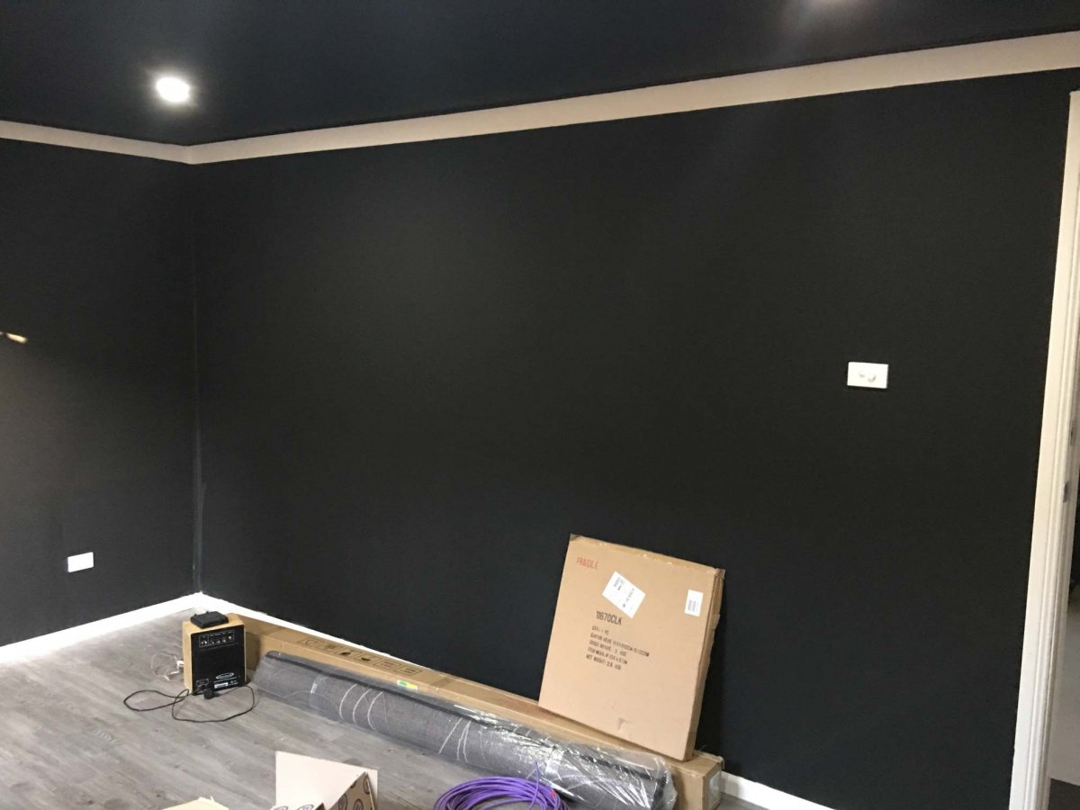

lonewolf1503560131 Posted November 22, 2016 Author Posted November 22, 2016 Here is my room with the painting and skirting etc done. I havent set up the room with the equipment yet though. 1
YourMateDyl Posted November 23, 2016 Posted November 23, 2016 12 minutes ago, lonewolf1503560131 said: Here is my room with the painting and skirting etc done. I havent set up the room with the equipment yet though. Looks good! I was un-decided on whether or not to paint the cornice and architraves with dark walls and ceiling. I think the cornice would look better black or how Ruth did hers' by using a shade lighter maybe so it doesn't distract the eye. And leaving the architrave white... but that's obviously subjective to taste By the way, Bunnings sell matt black power outlets and light switches if you want to change the colour of them And there's a company in the UK on ebay that sell matt black speaker wall plates - we just purchased from.
lonewolf1503560131 Posted November 23, 2016 Author Posted November 23, 2016 We actually initially had some of the skirting (is that what cornices and architraves are?) painted Black as well and then halfway through we asked them to change it to White as we found the white actually made it look nicer and added a little bit of contrast and style. While the black still looked good but was more dull i guess. I think they both work. I might have to take a look for those black power outlets, thanks for the tip. I actually bought all these power outlets and even the stainless steel covers from masters and then the electrician informed me that they are not for internal but for external or some other type and not the usual type :(.
