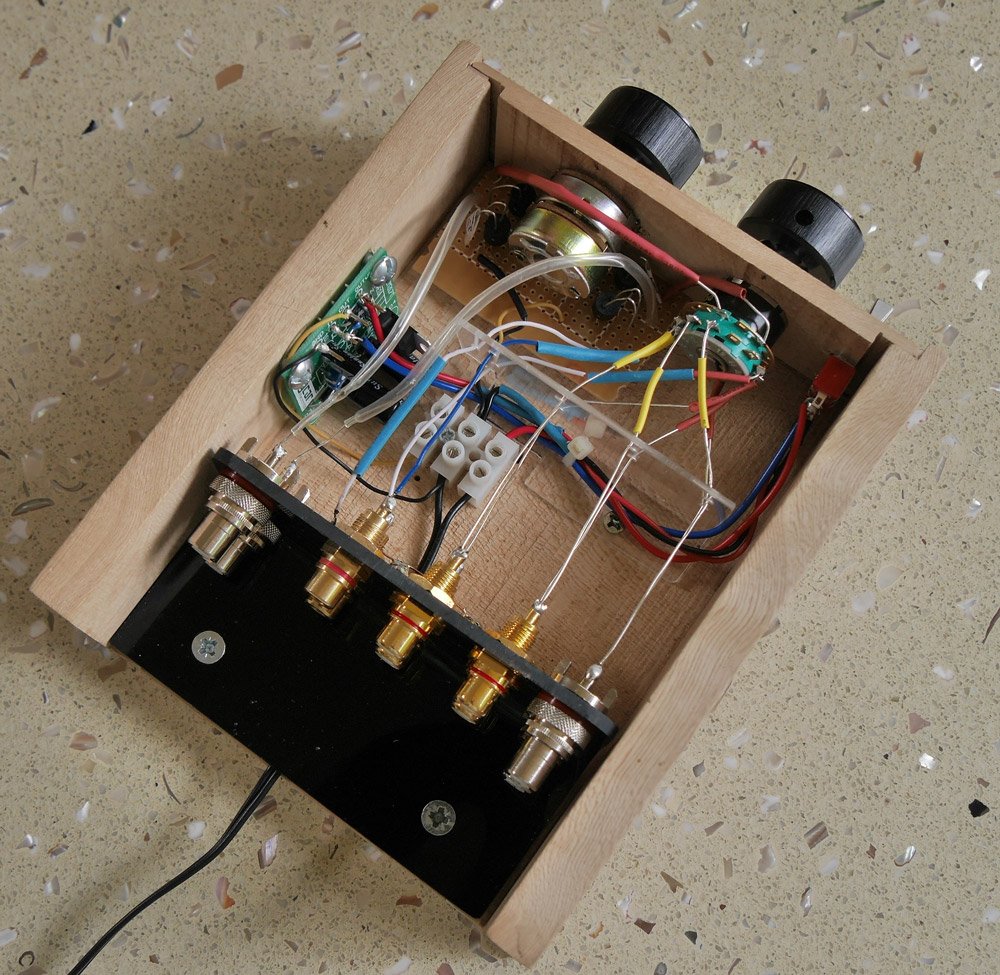

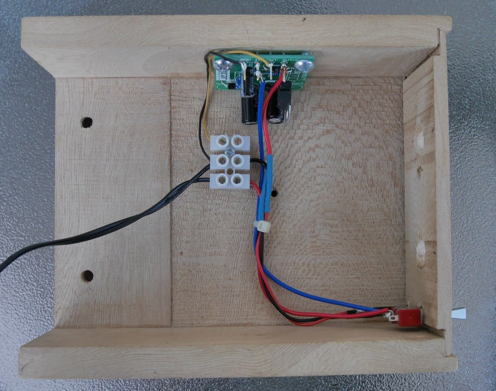

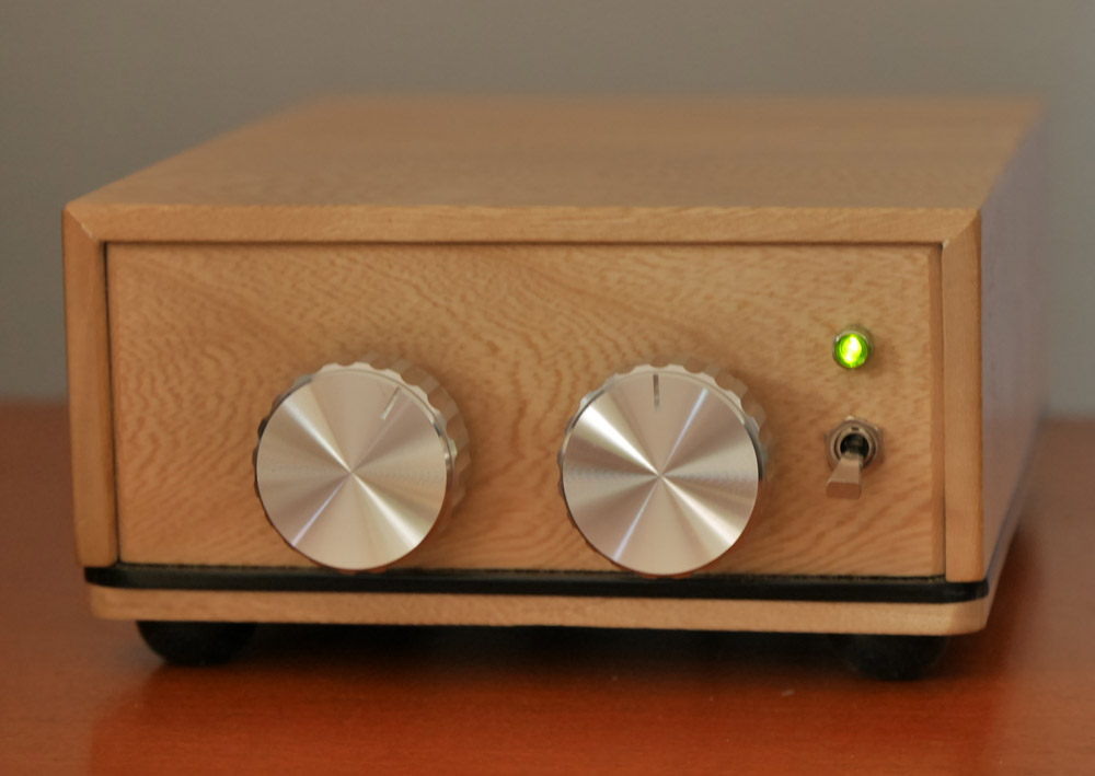

robmid Posted August 16, 2016 Posted August 16, 2016 (edited) I ordered a 23 step VALAB attenuator. They take a month to get to Aus but it vanished during shipping somehow. To save my sanity I decided to build George Stantscheff's Lightspeed Mk2 attenuator as a stand alone passive preamp so I could make a comparison. The Lightspeed has had many glowing reports, but some elecronic 'wizards' were complaining about lack of distortion figures and graphs so I was fully expecting the VALAB to sound better. I ordered 10 x NSL32SR2S opto couplers from Crest Components and got 2 sets of quad matches from 10 units. The first set of 4 matched within a range of less than 1ohm. Second set were all within 4% but 2 were way out with one being out by 30%. LIGHTSPEED SCHEMATICS HERE I grabbed a cheap 2 gang pot and 100 ohm resistors from Jaycar for a few dollars plus a $20 adjustable regulator kit which works like magic. (pic 3) It took me one day to build the reg kit and the attenuator which was built on a prototype board. After checking that the resistance on both channels varied when the volume control was rotated I hooked up the Lightspeed to my Holton amp with 33k input impedence per channel and KEF LS50's. I wasn't expecting such an enormous improvement in the already superb sound I was already getting with a shunted passive preamp and ALP Blue pot. Everything was tighter, and layered as I had never head before. Individual voices and instruments played together were not only positioned side to side but were sacked front to back and I could focus my ears to listen to individual instruments within a band. Everything sounded smoother but sharper with enormously powerful, tight, textured bass. MIND BOGGLING! Unfortunately, I had wire up the put in reverse and decided to fix my error. Stupid move. In the process, I may have cooked some of the optos because I had cut the leads too short and I mounted the opto couplers in pairs at the back of the board which is how I stuffed up the wiring. Luckily, I still had another set and more resistors and set of opto couplers but I also had learned a valuable lesson. KEEP LEADS LONG. Version two has the opto couplers mounted on each side of the pot with so they align with the appropriate input/shunt sections of the pot. (Pic 2) My box was built from jacaranda, sanded smooth and polished with Canuba wax. It not only sounds brilliant but smells great too! (Pic 1) I found the project to be fairly straight forward and parts very cheap, but I did tie myself up in knots with the first version through bad planning. Parts cost was around $160 including a Jaycar regulated power supply kit and heavy duty 2x6 position gold contact rotary switch. How does it compare to the 23 step VALAB attenuator? The VALAB was sharper (harsher) with muddier bass but better than my ALPS Blue pot. The Lightspeed is in a different league and the first note will stop you in your tracks. You must hear it to believe it. George charges around $500 for a built, single input Lightspeed which is good value if you don't want to tackle DIY. Edited August 17, 2016 by robmid 9
