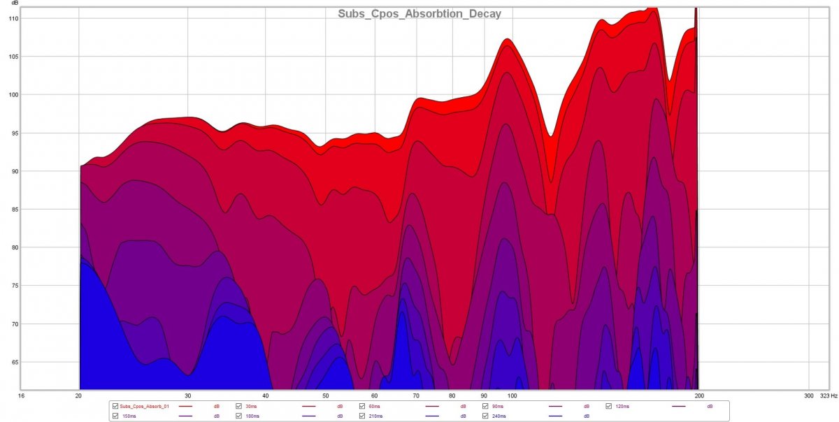

Ok, I am going to post a bunch of pictures from measurements taken yesterday.
First batch will be the Left Right and Center listen postion, before and after adding absorbtion around the room for Left, Right and Sub speakers
Second batch will be of the Center listen position Subwoofer graph with absorbtion in place. I am posting all graphs that REW can produce, but not sure how to use them.
Third batch is a picture of my left speaker and the influence on the 40-80Hz range with positioning.
I came across this post on gearslutz (year 2010) from the author of REW.
" Waterfall plots cannot be used to read decay times, unfortunately. The plot is produced by moving a window through the response and plotting the frequency content within that window. Using longer windows makes decays appear to take longer, which is at its heart a manifestation of the time/frequency trade-off of these kinds of analysis. Longer windows give increased frequency resolution, but correspondingly reduced time resolution. On the plus side, there are ways of measuring both the frequency and decay time of modal resonances with high precision, I'll include that capability in the next REW V5 beta in a few days time. "
I am not sure what method he is referring to, regarding the proper interpretation of decay time.
Legenda explanation:
First letter L_ R_ Subs_ refers to the speaker
Second letter Lpos Rpos Cpos refers to the listen postion
Base refers to the untreated room
Absorb refers to the absorption treatment put in place
Edited by Primare Knob

Sub graphs generated from the Center position with Absorbtion in place. Not sure how to interpret the distortion graph, but might this explain why there is an uneven decay rate/time at 20Hz?
Looking at the waterfall and decay graph, I would like to do more work on the room, but the RT60 graph doesn't seem to bad.
I have been trying to get rid of the nasty dip between 50Hz - 70Hz, and only moving the mic closer to the side wall seem to make an impact. I would guess that the problem here is SBIR. The same happens in the other graphs and sub and right speaker in a similar region. My biggest question is, how can I locate this SBIR? I have walked around the room along the side wall, at various distances with 200mm thick absorbtion, but never been able to make a difference.

4 hours ago, Primare Knob said:
Any thoughts or ideas you would like to share on these measurements. Are they any useful, and what does it tell me?
Why does the frequency response of the previous charts, look completely different to these??!
Example:
VS
On 13/01/2019 at 3:26 PM, Primare Knob said:
Are you moving the microphone?
In short, no.... they are useless, and impossible to interpret.
Put the mic in the listening position.
Put the subwoofer in different places, takes sweeps, choose the best place.
Apply EQ to solve problems.
Finish.

On 13/01/2019 at 3:12 PM, Primare Knob said:
Right speaker, before and after. Var smoothing has been applied to the no Absorbtion graph to make it more readable.
Impossible to see anything in these as one of them is smoothed.
