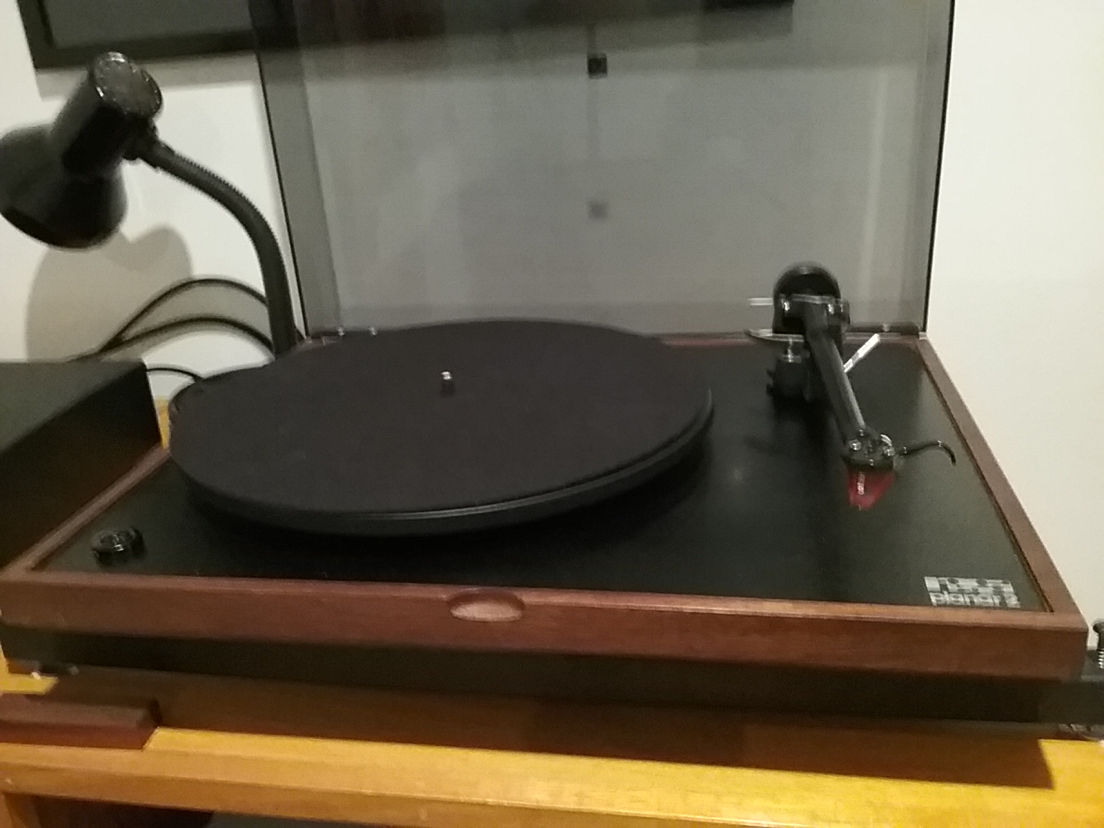

martin64 Posted February 11, 2018 Posted February 11, 2018 Hi guys i bought a Rega planar 2 last year brand new a reputable dealer in Melbourne. The planar 2 comes with the carbon cartridge and I decided to upgrade immediately to the Rega Elys 2. I had the carbon on for a month which sounded actually very good for a budget cartridge. I changed to the elys but here is where all the trouble started. It plays for a while then the sound starts distorted. A lot of humming close to the centre of the record. I took it back to the dealer and the replaced the cartridge. This did not solve the problem and the new one made exactly the same. I run it thru a musical fidelity phono amp and M6 amp. I have tested it thru my yamaha and it is exactly the same. Replaced it with the carbon and no problems what so ever. Need some expert advise please or it goes to hard rubbish

audiohifiaudio Posted February 12, 2018 Posted February 12, 2018 On 11/02/2018 at 9:13 PM, martin64 said: Hi guys i bought a Rega planar 2 last year brand new a reputable dealer in Melbourne. The planar 2 comes with the carbon cartridge and I decided to upgrade immediately to the Rega Elys 2. I had the carbon on for a month which sounded actually very good for a budget cartridge. I changed to the elys but here is where all the trouble started. It plays for a while then the sound starts distorted. A lot of humming close to the centre of the record. I took it back to the dealer and the replaced the cartridge. This did not solve the problem and the new one made exactly the same. I run it thru a musical fidelity phono amp and M6 amp. I have tested it thru my yamaha and it is exactly the same. Replaced it with the carbon and no problems what so ever. Need some expert advise please or it goes to hard rubbish Does your phono stage match the new cartridge?
martin64 Posted February 12, 2018 Author Posted February 12, 2018 Its a musical fidelity..i even tried it with my second system which is a yamaha aventage receiver and does the same thing. Somewhere i do something wrong but not sure what
martin64 Posted February 12, 2018 Author Posted February 12, 2018 But maybe it does not match both of them..not sure
Blk plastic Posted February 12, 2018 Posted February 12, 2018 My Exact also hums on my RP6 as it gets closer to the label. It's only minor and does not interfere with the music in any way. It's a common Rega cartridge thing. The distortion you're experiencing would be a cartridge alignment issue I would imagine. 2
martin64 Posted February 12, 2018 Author Posted February 12, 2018 My Exact also hums on my RP6 as it gets closer to the label. It's only minor and does not interfere with the music in any way. It's a common Rega cartridge thing. The distortion you're experiencing would be a cartridge alignment issue I would imagine. Maybe its a Rega thing. I use a very powerfull sub with my amp which make things worse. It was aligned by the dealer and i tried too but did not work. It is as it picks up more than usual static. I must maybe try a ortofon blue to see if that works 1
Hydrology Posted February 13, 2018 Posted February 13, 2018 I've come across humming on Regas that are positioned directly above some amplifiers - as the arm arcs in towards the centre, the cart is getting closer to the power transformer of the amp, resulting in audible hum. Don't suppose you have some long RCA extension cables to try?
rantan Posted February 13, 2018 Posted February 13, 2018 I am sorry to hear about the OP's problem and the fact that Rega considers this as acceptable. IMO it is 100% not acceptable and this would put me off ever buying a Rega deck or cart. I hope something works out for the OP. 2
martin64 Posted February 13, 2018 Author Posted February 13, 2018 I've come across humming on Regas that are positioned directly above some amplifiers - as the arm arcs in towards the centre, the cart is getting closer to the power transformer of the amp, resulting in audible hum. Don't suppose you have some long RCA extension cables to try? I have tried that one as that sounded electronically correct..did not help though. Om the cheaper cartridge there is no humming
martin64 Posted February 13, 2018 Author Posted February 13, 2018 I am sorry to hear about the OP's problem and the fact that Rega considers this as acceptable. IMO it is 100% not acceptable and this would put me off ever buying a Rega deck or cart. I hope something works out for the OP. I agree with you as the cartridge was a christmas present which lies now in a box. Denon or ortofon here i come?
