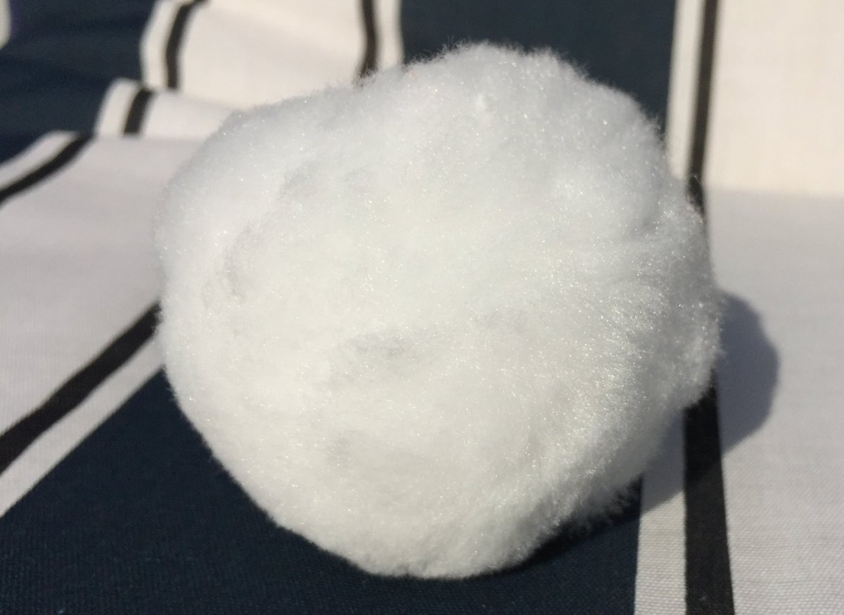

kukynas Posted June 23, 2018 Author Posted June 23, 2018 fully forgot to post some update, below picture of the ball itself, water is crystal clear, pump with much better pressure ratio, so far very happy with this solution

kukynas Posted June 26, 2018 Author Posted June 26, 2018 Steinbach's claiming 1.5 microns and I can confirm that filtration has better effect compared to Zeolit I tried 2 years ago, flow rate is improved and pump pressure went down from 0.8 to 0.5 bar, another advantage is frequency of the backwash http://web.steinbach.at/filter-balls.html?___store=en&___from_store=en#.WzH1WlUzabh
