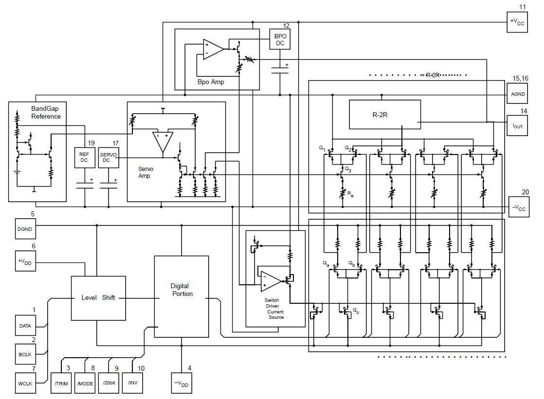

zenelectro Posted October 7, 2018 Posted October 7, 2018 They don't have to, nor would they likely anyway, make their own DAC chip. It's a simple resistor array driven by high speed logic. Or maybe they are using Sabre etc with everything disabled / bypassed. These day there are so many ways to do conversion well - we are lucky. George, on a separate subject, do you have any info on Burr Brown colinear (sign magnitude) DAC arcitecture? I've seen the usual stuff on 1704 but am after more detail on how the CCS's are arranged. I know there is an AES paper, might have to buy it. cheers Terry
zenelectro Posted October 7, 2018 Posted October 7, 2018 (edited) I checked out some other pics, it is as described earlier, a type of pulse array DAC. Edited October 7, 2018 by zenelectro 1
georgehifi Posted October 7, 2018 Author Posted October 7, 2018 (edited) 2 hours ago, zenelectro said: I've seen the usual stuff on 1704 No but I do have this on the 1704 you probably haven't seen. Japan PCM1704 pdf.pdf Cheers George Edited October 7, 2018 by georgehifi
zenelectro Posted October 8, 2018 Posted October 8, 2018 Thanks George, Yep, got that one too. It's far too simplistic. I'll get the AES paper on Colinear Architecture by Burr Brown at some stage. T

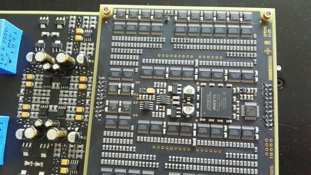

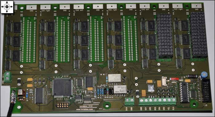

kukynas Posted October 8, 2018 Posted October 8, 2018 those transistors are Vishay MMA, those 4 ICs looks like SNXX bit shift registers, Altera FPGA front of it will be most probably just driver/logic and error correction in similar fashion like other transistor ladder DACs, but PCM to DSD conversion will be most probably done by SHARC DSP as Dave pointed out earlier, Altera won't have enough juice for that It looks as very promising concept, something like combined Chord/Denafrips approach 1

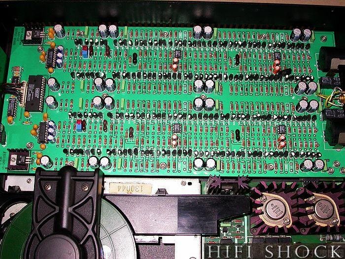

georgehifi Posted October 8, 2018 Author Posted October 8, 2018 (edited) 5 hours ago, kukynas said: those transistors are Vishay MMA Yeah Daniel, but why so many in the output stage, must be over 100 of them, unless the top half are doing I/V duties aka Krell CD300 did after the PMD100/PCM1702's with all their transistors, supposed to be nice sounding machine. And then there's all those lined up resistors, like discrete low bit R2R as well on the Marantz. Cheers George Krell CD300 Edited October 8, 2018 by georgehifi

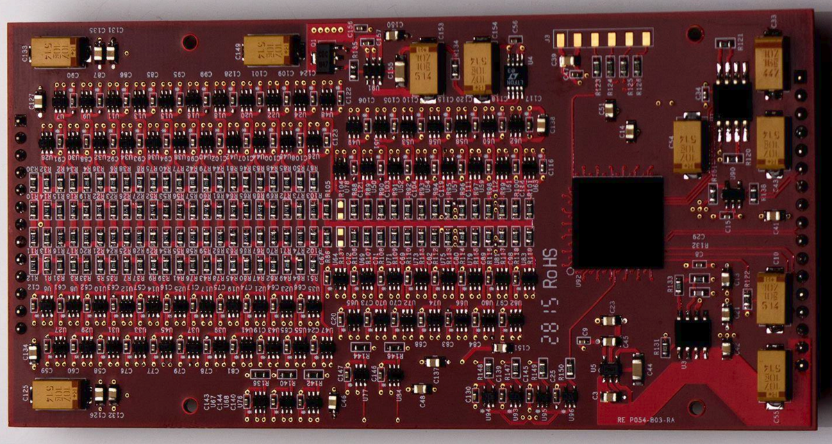

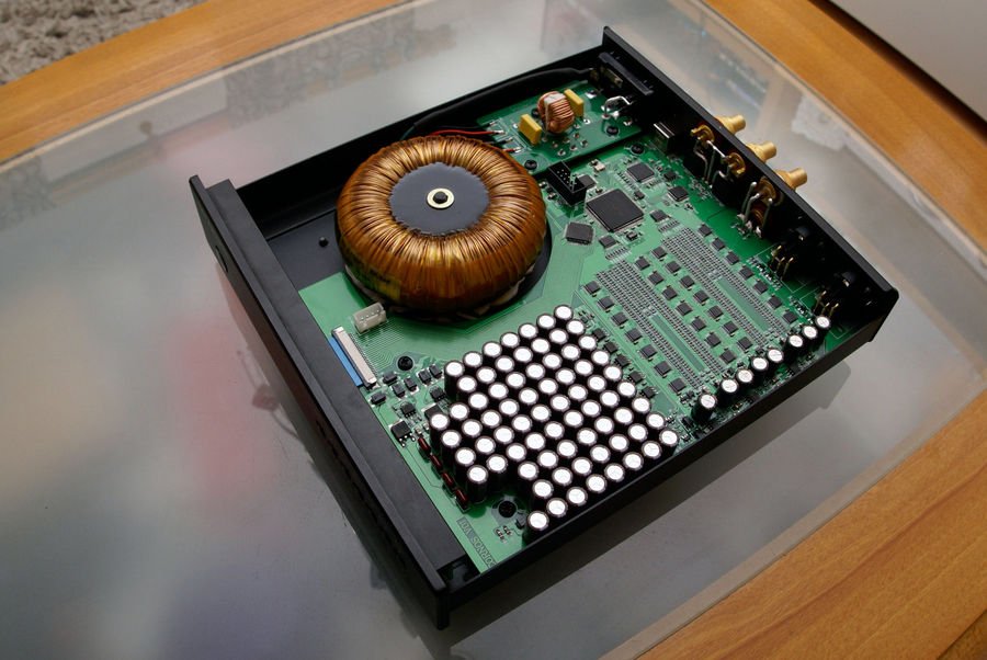

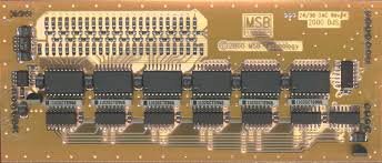

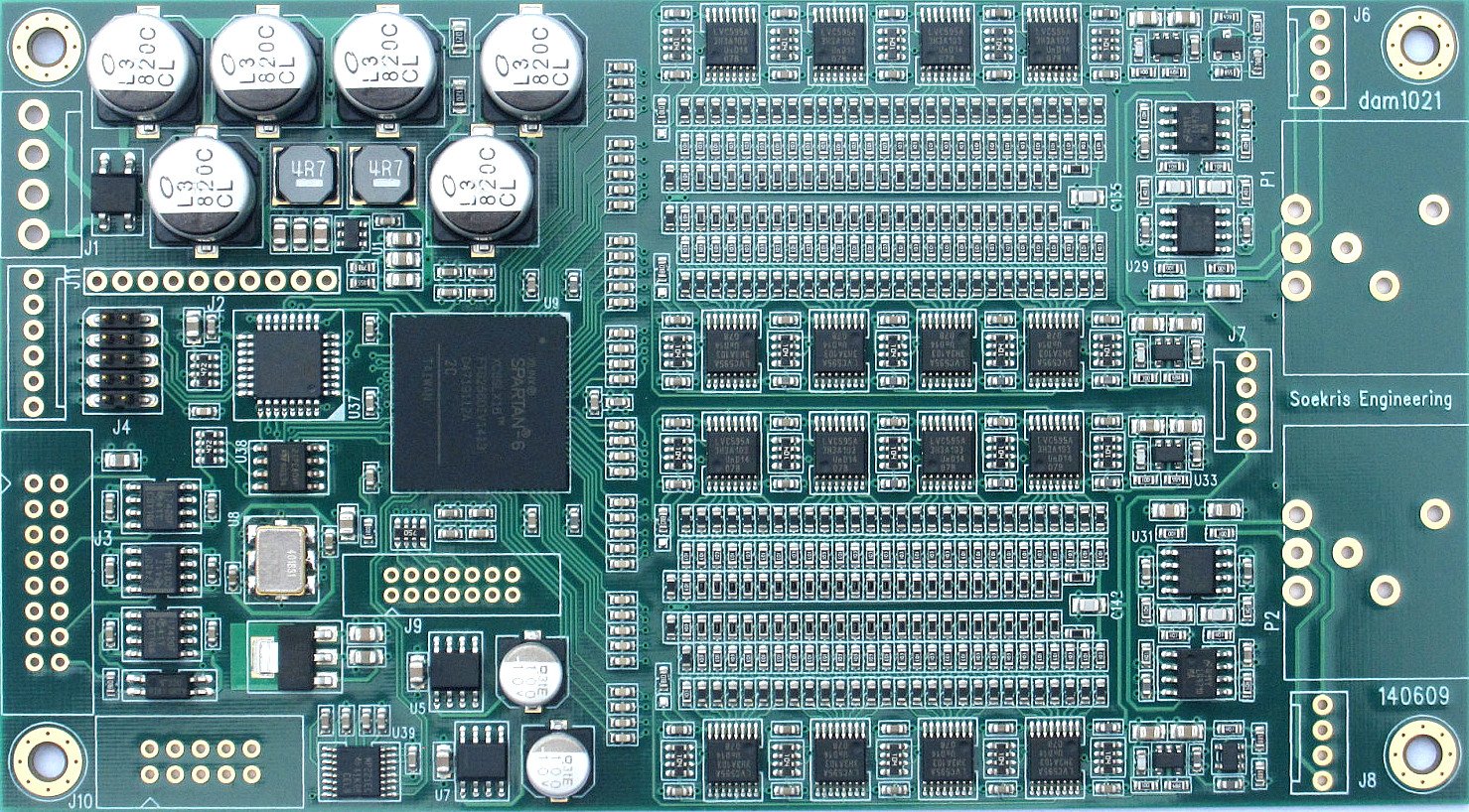

kukynas Posted October 8, 2018 Posted October 8, 2018 32 minutes ago, georgehifi said: Yeah Daniel, but why so many in the output stage, must be over 100 of them, unless the top half are doing I/V duties aka Krell CD300 did after the PMD100/PCM1702's with all their transistors, supposed to be nice sounding machine. And then there's all those lined up resistors, like discrete low bit R2R as well on the Marantz. Cheers George it's not output stage as in traditional DAC architecture (I/V or whatever), that entire part after FPGA is basically discrete D/A conversion stage you would normally find inside of DAC chip but in this case with 1 bit architecture, may be Dave oversimplified it when he mentioned low pass filter but it's bit more complex, I'm not resistor ladder architecture guru but there's plenty of info on google and on DIYaudio forum (no DAC project and similar) you can find more of such designs in typical discrete R2R ladder DACs such as Denafrips, Holo, Soekris and as many knows MSB, some pictures of similar concepts below Marantz seems to take slightly more complex approach with combining of resistor ladder and some discrete stage but I'm just guessing here because there's not enough resistor to complete entire bit shift cycle, may be something on the other side? or they used different techniques how to do it...
georgehifi Posted October 8, 2018 Author Posted October 8, 2018 21 minutes ago, kukynas said: you can find more of such designs in typical discrete R2R ladder DACs such as Denafrips, Holo, Soekris and as many knows MSB, some pictures of similar concepts below Yes they all use discrete R2R resistors, hundreds of them for 16 18 or 24bit resolution . But here in this Marantz there's only what looks to be 28 of them (after what you say are 4 x shift registers) followed by the 100 x smd transistors. Then after this comes the output rca's and xlr's Cheers George
kukynas Posted October 8, 2018 Posted October 8, 2018 4 minutes ago, georgehifi said: Then after this comes the output rca's and xlr's Cheers George yes, sure, sorry I should have been more clear... because this is 1 bit (DSD) conversion you don't need as much of them as in case of PCM conversion but not sure if 28 is enough

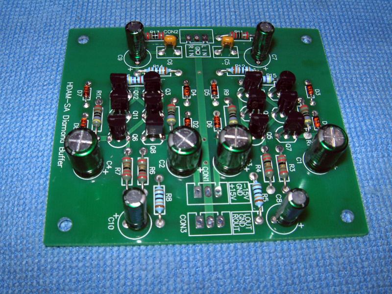

davewantsmoore Posted October 8, 2018 Posted October 8, 2018 2 hours ago, georgehifi said: Yeah Daniel, but why so many in the output stage, must be over 100 of them, unless the top half are doing I/V duties aka Krell CD300 did after the PMD100/PCM1702's with all their transistors, supposed to be nice sounding machine. Looking at other pictures of recent HDAM circuits, it seems pretty standard to use that many .... A quick discrete buffer circuit like this on the back of an envelope (like a WJ buffer) could use ~15 per channel .... and that's just my caveman sketch of it (Marantz could surely use more parts to improve the performance). 1 hour ago, kukynas said: yes, sure, sorry I should have been more clear... because this is 1 bit (DSD) conversion you don't need as much of them as in case of PCM conversion but not sure if 28 is enough As I said before, it doesn't work at all the same way as a resistor ladder architecture. The long line of 28 resistors are a red-herring
georgehifi Posted October 8, 2018 Author Posted October 8, 2018 (edited) 3 hours ago, kukynas said: it seems they are using their HDAM discrete output stage instead of traditional opamps stage so most probably that’s why so complex looking... Yes they are, but HDAM outputs are no where near as complicated as that, as you can get discrete HDAM knockoffs on ebay. The Marantz's one's that are in the output stage before the RCA and XLR outputs I counted at over 112 transistors!!! Ok a few could be smd regulators, but still??? Cheers George Edited October 9, 2018 by georgehifi
