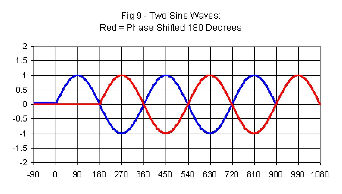

Monkeyboi Posted December 8, 2018 Posted December 8, 2018 15 hours ago, andyr said: Not so much "out of phase" - as it's AC - but simply that the output sockets of this 'power box' (or the power board attached to this device, which you mentioned) have 'neutral' swapped with 'live'. This can be a problem for power transformers, due to capacitative coupling between primary and secondary windings - and, yes, it affects the sound you hear! Andy a.c can certainly be out of phase. The signal going into your speakers is alternating current (a.c.) and we all know what the effect is if one speaker is reversed (180 degrees out of phase) relative to the other(s). The mains is no different and reversing active and neutral wires will have exactly the same effect in terms of phase, however the degree this is likely to affect the sound is a matter of circumstance and question. IME out of phase mains power connections to power amplifiers where high currents are involved and the d.c. ripple is more likely to be higher there is a difference. With low power devices the effect is generally less pronounced. With switch-mode supplies, reversing the active and neutral connections is IMHO definitely not recommended although it probably happens more than often with US, Japanese and some other Asian countries that use either 2 pin round or flat mains plugs without a third pin for earthing. Cheers, Alan R. 1

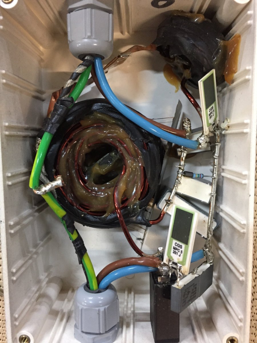

Guzzista Posted December 8, 2018 Author Posted December 8, 2018 16 hours ago, audiofeline said: It would be interesting to dismantle this device and see if there is anything inside it. I have done this and taken a picture of the inside, I'm reluctant to post it though, I'm cautious of litigation.

Monkeyboi Posted December 8, 2018 Posted December 8, 2018 1 minute ago, Guzzista said: I have done this and taken a picture of the inside, I'm reluctant to post it though, I'm cautious of litigation. If there is a visible branding just put the image into an image manipulation program and "fuzz out" the brand. However having said that, if the product has the active and neutral connections reversed it doesn't comply with Australian standards and should either be withdrawn from the market or recalled / replaced with a compliant model. That's why you can no longer buy those old triangular shaped double adapters from the 70s. One side had the active and neutral reversed due to the way they were manufactured back then. Cheers, Alan R.
Guzzista Posted December 8, 2018 Author Posted December 8, 2018 12 minutes ago, Monkeyboi said: If there is a visible branding just put the image into an image manipulation program and "fuzz out" the brand. However having said that, if the product has the active and neutral connections reversed it doesn't comply with Australian standards and should either be withdrawn from the market or recalled / replaced with a compliant model. Cheers, Alan R.
andyr Posted December 8, 2018 Posted December 8, 2018 1 hour ago, Monkeyboi said: a.c can certainly be out of phase. The signal going into your speakers is alternating current (a.c.) and we all know what the effect is if one speaker is reversed (180 degrees out of phase) relative to the other(s). The mains is no different and reversing active and neutral wires will have exactly the same effect in terms of phase, however the degree this is likely to affect the sound is a matter of circumstance and question. IME out of phase mains power connections to power amplifiers where high currents are involved and the d.c. ripple is more likely to be higher there is a difference. With low power devices the effect is generally less pronounced. With switch-mode supplies, reversing the active and neutral connections is IMHO definitely not recommended although it probably happens more than often with US, Japanese and some other Asian countries that use either 2 pin round or flat mains plugs without a third pin for earthing. Cheers, Alan R. Thanks for pointing out my error, Alan. Your graphs present the issue quite simply. Andy

Monkeyboi Posted December 8, 2018 Posted December 8, 2018 55 minutes ago, t_mike said: Is that a solder only earth? Better than just twisted and not soldered. Anyhow IMHO it's a dog's breakfast at best. Cheap and nasty assembly. I wouldn't use it, but that's just my opinion. Cheers, Alan R.
