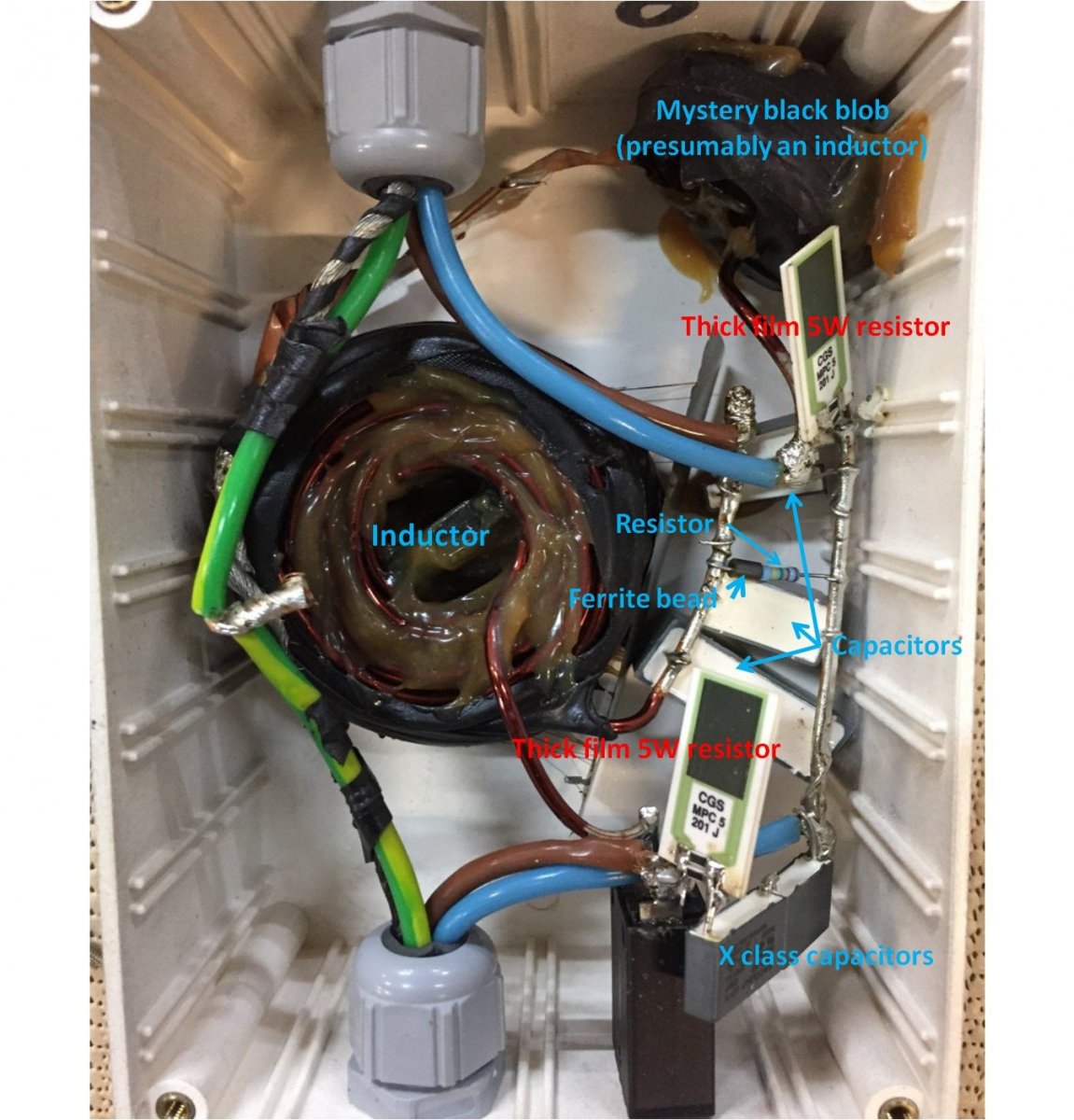

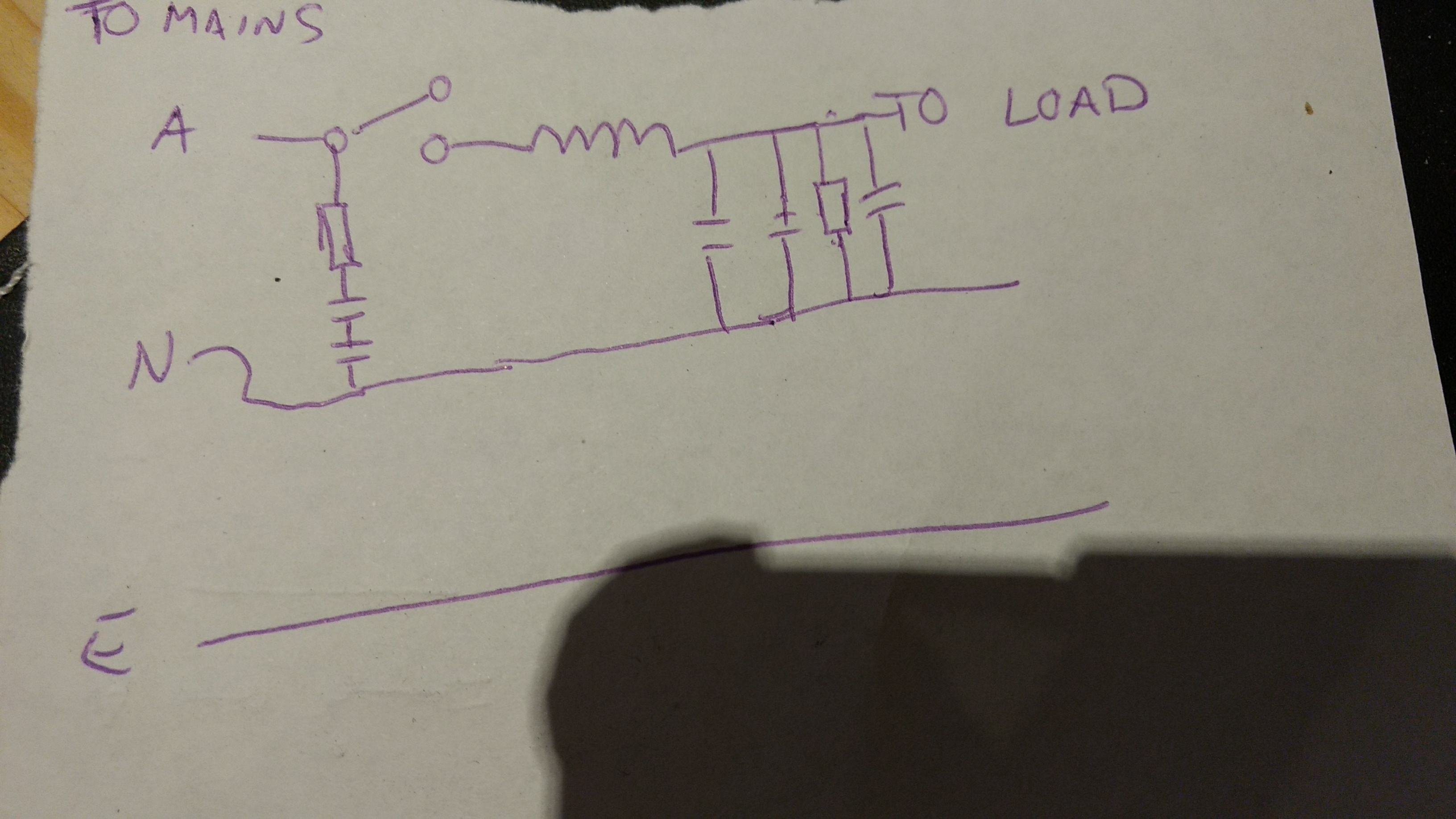

eltech Posted December 16, 2018 Posted December 16, 2018 On 08/12/2018 at 3:28 PM, Guzzista said: Active and neutral are not swapped. I drew out the schematic. Correct me if I'm wrong, but here it is....
MLXXX Posted December 16, 2018 Posted December 16, 2018 7 minutes ago, eltech said: On 08/12/2018 at 2:28 PM, Guzzista said: Active and neutral are not swapped. I agree they don't appear to be swapped inside the case. It's still an open question whether there's a wiring error outside the case.
eltech Posted December 16, 2018 Posted December 16, 2018 (edited) Hmm.. something weird going on at the load end. There is a shielded cable connected to an inductor which connects to neutral. But is that a resistor in line with the neutral??? I'm having trouble making it out from that photo. Edited December 16, 2018 by eltech
eltech Posted December 16, 2018 Posted December 16, 2018 The inductor from shield to neutral will be negating any effect of the shield...

Monkeyboi Posted December 16, 2018 Posted December 16, 2018 3 hours ago, eltech said: Active and neutral are not swapped. I drew out the schematic. Correct me if I'm wrong, but here it is.... The ferrite bead over one of the leads of the low power resistor is a low value inductor. What is the back blob in the top right hand corner of the box? Looks like there is an enamel coated wire going to it???? Cheers, Alan R. 2
