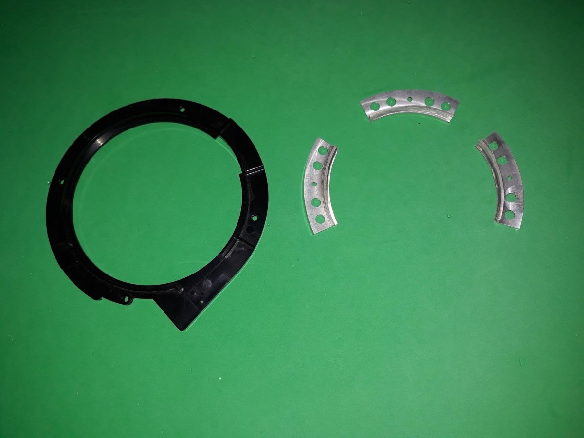

kwtools Posted April 18, 2019 Posted April 18, 2019 22 minutes ago, Owen Y said: Sorry @andyr - poor choice of words. The Terminator's Effective Length is only around 75mm, so you can appreciate that variations on record thickness will generate much more dramatic changes in VTA/SRA. Fortunately, the Terminator is designed for convenient VTA adjustment. @kwtools - (back on topic ) what 'mechanical modifications' did you feel necessary to make to your SP-10? Cheers, Owen Dark Lantern blog - http://darklanternforowen.wordpress.com/ As mentioned earlier I did make up new arm wands and they are 120 mm long. The weird looking thing next is the first generation Trans-Fi knife edge arm that I bought before its call Terminator. Can't remember much (for a 75yo) on the mechanical changes as it was done many years ago, did remember replacing the black plastic ring under the big thick greyish rubber ring with three shorter segments of 7000 series Alu to reduce internal motor resonance/vibration to ensure the motor runs quieter. I happen to have made a spare set just in case a new SP10 joins my collection. Those three pieces next to the black ring were the replacements for the black ring. Attached photos.
Owen Y Posted April 19, 2019 Posted April 19, 2019 I agree, the way the SP-10's high torque DD motor is screw-fixed down to its chassis frame, is less than structurally ideal... (i) 4 small M4 machine screws. (ii) A black plastic guide for the mechanical brake interfaces between these motor screws & the SP-10 chassis frame Your metal replacement ring pcs should be an improvement. (Of course you might argue that the oroginal softer plastic material might provide some motor isolation.) Terminator wand: The longer wand will help relieve the VTA sensitivity issue with this tonearm.. Cheers, Owen Dark Lantern blog - http://darklanternforowen.wordpress.com/

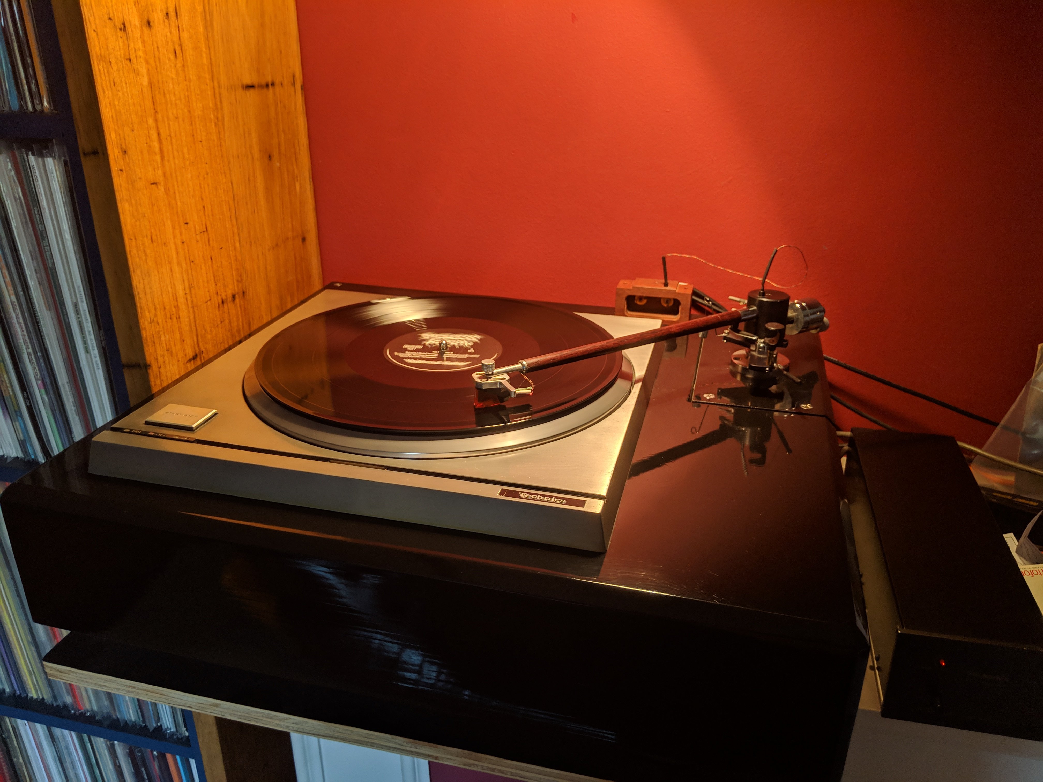

plastercasts Posted April 21, 2019 Posted April 21, 2019 Here's my sp10 in goldenage plinth and 12" univector. Would like some suggestions for service in Melbourne the 45 button is a bit dicky. and was hoping to get it polished up and top plate brushed aswell as having the start button replaced. Cheers Tommy 4
