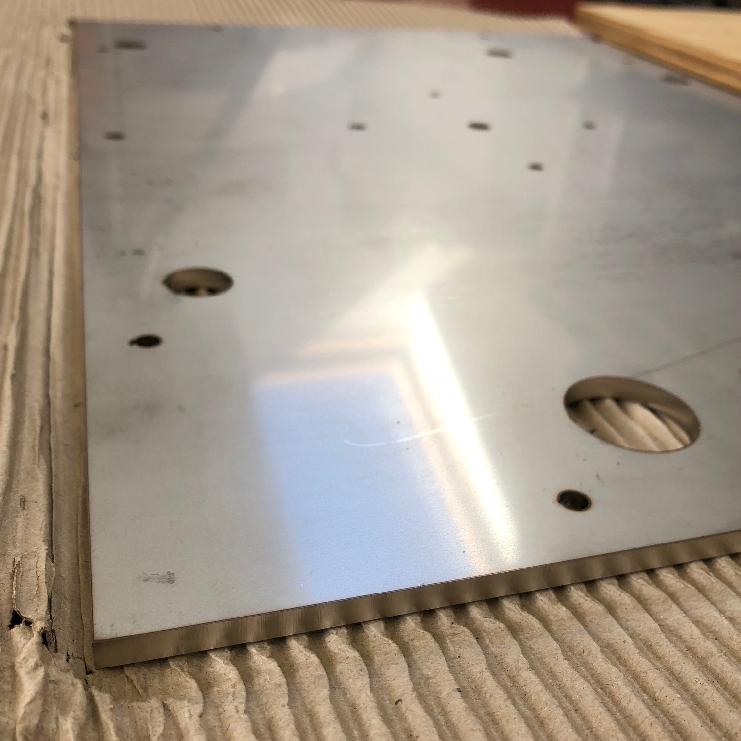

Owen Y Posted June 13, 2019 Posted June 13, 2019 (edited) Hi @mloutfie - the one across the rear is an Analog Instruments Apparition 12" (a unipivot Cocobolo wood arm). The other a Kenwood L-07D arm (with an Ortofon headshell LH-9000). The plinth is laminated plywood, not solid but CNC profiled inside, with Stainless Steel baseplate carrying a M12 'noise sink' hex bolt under the main bearing. The whole shebang sits on 4 x mag-lev supports. Cheers, Owen Dark Lantern blog - http://darklanternforowen.wordpress.com/ Edited June 18, 2019 by Owen Y 2

Guest Mr Thorens Posted June 17, 2019 Posted June 17, 2019 On 13/06/2019 at 12:53 PM, Owen Y said: Hi @mloutfie - the one across the rear is an Analog Instruments Apparition 12" (a unipivot Cocobolo wood arm). The other a Kenwood L-07D arm (with an Ortofon headshell LH-9000). The plinth is laminated plywood, not solid but CNC profiled inside, with Stainless Steel baseplate carrying a Mi12 'noise sink' hex bolt under the main bearing. The whole shebang sits on 4 x mag-lev supports. Cheers, Owen Dark Lantern blog - http://darklanternforowen.wordpress.com/ I’d be very interested as to the source of the heavy base plate and how you did it.
Owen Y Posted June 18, 2019 Posted June 18, 2019 Hi @Mr Thorens - sorry, real work getting in the way . We had a 6mm Stainless Steel plate laser-cut to size, with holes for screw-fixing, to access the SP-10 hold-down screws & for tapping M12 fine thread for the centre 'noise-sink' screw . It ended up a bit over 9kg mass. Not costly. After hole-countersinking, de-burring, wet & dry sanding & washing.... Cheers, Owen Dark Lantern blog - http://darklanternforowen.wordpress.com/ 1
Guest Mr Thorens Posted June 18, 2019 Posted June 18, 2019 Thanks Owen. I’m going to try something similar. Just need to find a local steel supplier to do it.
Owen Y Posted June 20, 2019 Posted June 20, 2019 @Mr Thorens - we went to a metal cutting / metalworking workshop - they sourced & supplied the SS. Cheers, Owen Dark Lantern blog - http://darklanternforowen.wordpress.com/
