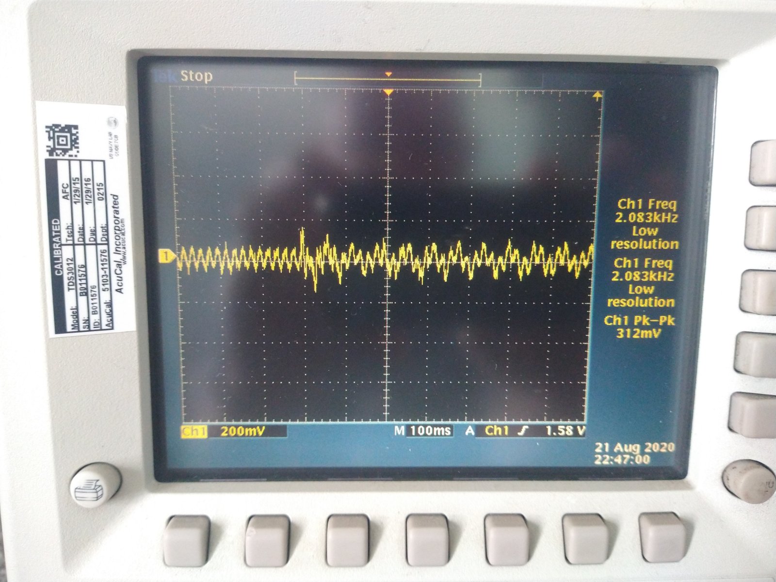

The impulse response is about as good as gets. First trace is the OEM second is the Stainless/Delrin platter. Testing was done in the plinth in the first pic with different setup to the previous plots so these will differ, it's the relative measurement between the 2 platters that we are interested in. Damping of the SS/Delrin is far superior. The ringing before and after is an artifact of tonearm resonance I did these measurements with tonearm damping off. This platter doesn't fit a stock SP10 so I couldn't do the measurements in the previous setup.

Both the SP10R and mk2 have SME IV arms. From my measurements the stock mk2 platter resonates, the SS/Delrin dampens this resonance far better than just the SS platter alone which is better than the OEM. Technics made a point of showing platter resonance test results in 10R blurb. The 10R platter is extremely well damped.
Once I get the platter to the user I will get him to do impulse tests between the 10R and the SS/Delrin mk2, this will be interesting.

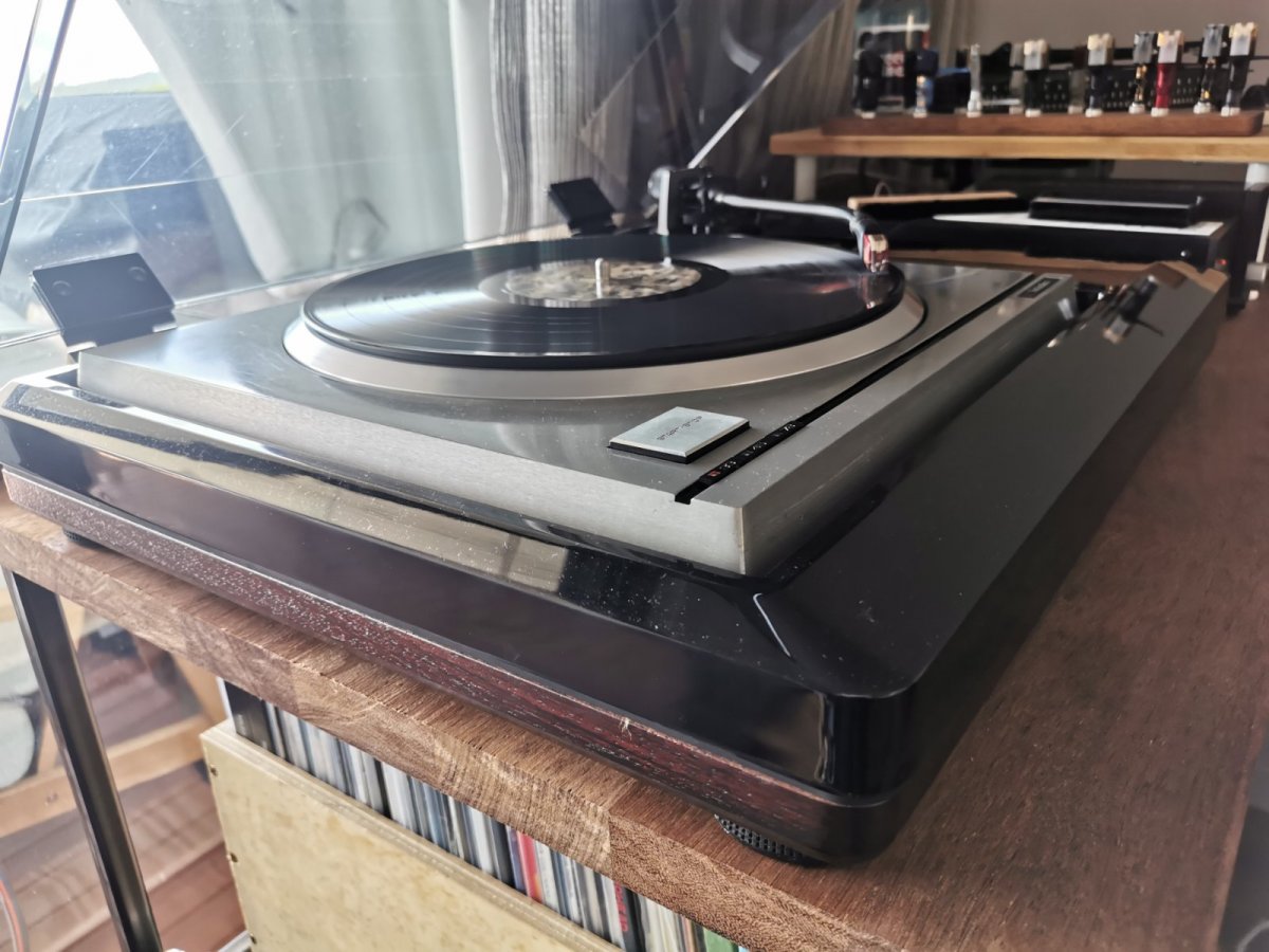

I'm also a big fan of the SP10.  With some help from Owen (in thread above) I built a stacked plywood, MDF with lead/resin loading, layered plinth and installed two tonearms - the Transfi Terminator with AT33EV cart, and an SME3012 with a Ortofon SL15 ELL in SPU headshell.  Setup sounds excellent and compares favourably to my Luxman PD444 rig.
Thanks to Owen for his assistance in laying out the plinth and tips on setting up the Terminator!
  • Like 3
