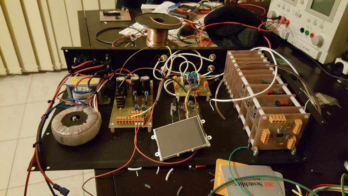

mwhouston Posted July 15, 2016 Posted July 15, 2016 Here is yet another of my "Mimic" phono stages. This is also for an SNA member who wanted two switchable inputs and the ability to switch between MM and MC thus the switches on the back. There is also a battery test point at the front. All the drilling is done and the preamp assembled now for the internals. 3
