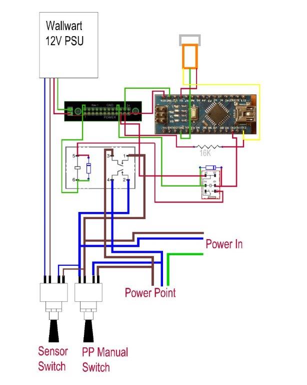

DQ828 Posted May 29, 2015 Posted May 29, 2015 Not exactly audio but it helps me when I'm building audio It's a sensor driven power point to use mainly with my vacuum cleaner. I got sick to death of bending down & fighting with the switch to turn it on & off over & over & over. Now all I have to do is wave my hand in front of the sensor and it turns the vac on, wave my hand again and its off. I can turn the sensor off & just use it as a normal power point as well. 5

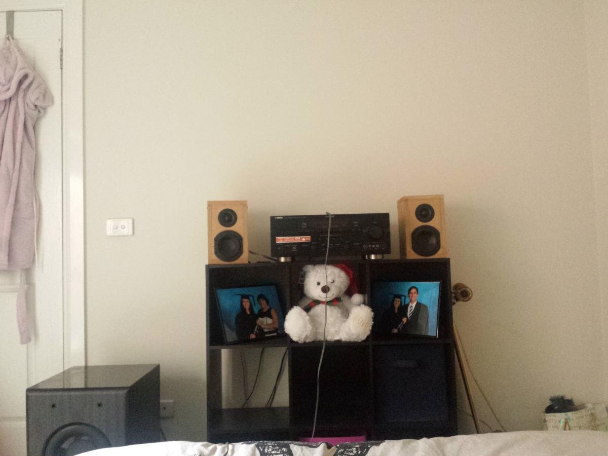

bullet Posted May 30, 2015 Posted May 30, 2015 built some tiny bookshelf speakers using 4" Peerless HDS driver and SB Acoustics SB26STCN and im surprised how well they turned out.. Sealed box of 3lts so bass isnt very impressive, but the midrange and top end clarity and detail is pretty awesome.. I paired them up with a smaller woofer system comprising of twin 5" SB15NRX drivers in a 20lt box to keep is smallish with a built in 160 watt amp. Altogether they sound a large pair of floor standers haha very happy for a small bedroom application :-) 2
DQ828 Posted May 30, 2015 Posted May 30, 2015 (edited) Where did you get the sensor from? From here http://www.ebay.com.au/itm/181626812998?_trksid=p2057872.m2749.l2649&ssPageName=STRK%3AMEBIDX%3AIT & the Nano from here http://www.ebay.com.au/itm/181417343726?_trksid=p2057872.m2749.l2649&ssPageName=STRK%3AMEBIDX%3AIT And this is what I did. I already had the PP, relays & PSU Edited May 30, 2015 by DQ828

Silent Screamer Posted May 30, 2015 Posted May 30, 2015 http://www.ebay.com.au/itm/Automatic-DC-12V-24V-8A-Infrared-PIR-Motion-Sensor-Switch-For-LED-light-Stylish-/351172615781 Would these make it any easier?
DQ828 Posted May 30, 2015 Posted May 30, 2015 http://www.ebay.com.au/itm/Automatic-DC-12V-24V-8A-Infrared-PIR-Motion-Sensor-Switch-For-LED-light-Stylish-/351172615781 Would these make it any easier? It might do, ideally should should be able to adjust the sensitivity, Ive got mine set so I have to almost touch the sensor to turn it on & off, otherwise it will go off accidentally much more often. Aldi were selling some sort of remote PP that looked like it might work but I cannot find them on their website now.
bullet Posted May 30, 2015 Posted May 30, 2015 Will do @@DQ828 Ill have to take some when i go to the gfs place again.. i built them for her :-P
bullet Posted May 31, 2015 Posted May 31, 2015 Only ones i took while i was making sure they sounded ok haha stayed in here listening to tunes for a good 2-3 hrs coz the sounded so nice 4
Silent Screamer Posted June 1, 2015 Posted June 1, 2015 It might do, ideally should should be able to adjust the sensitivity, Ive got mine set so I have to almost touch the sensor to turn it on & off, otherwise it will go off accidentally much more often. Aldi were selling some sort of remote PP that looked like it might work but I cannot find them on their website now. I was looking at them in-store the other day when the better half was shopping, but it still brings you back to having to press a button.
