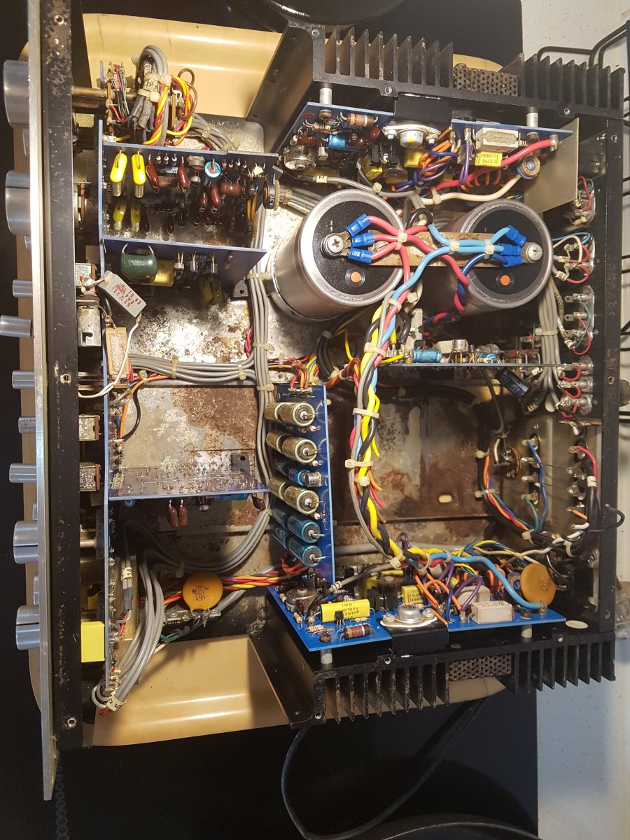

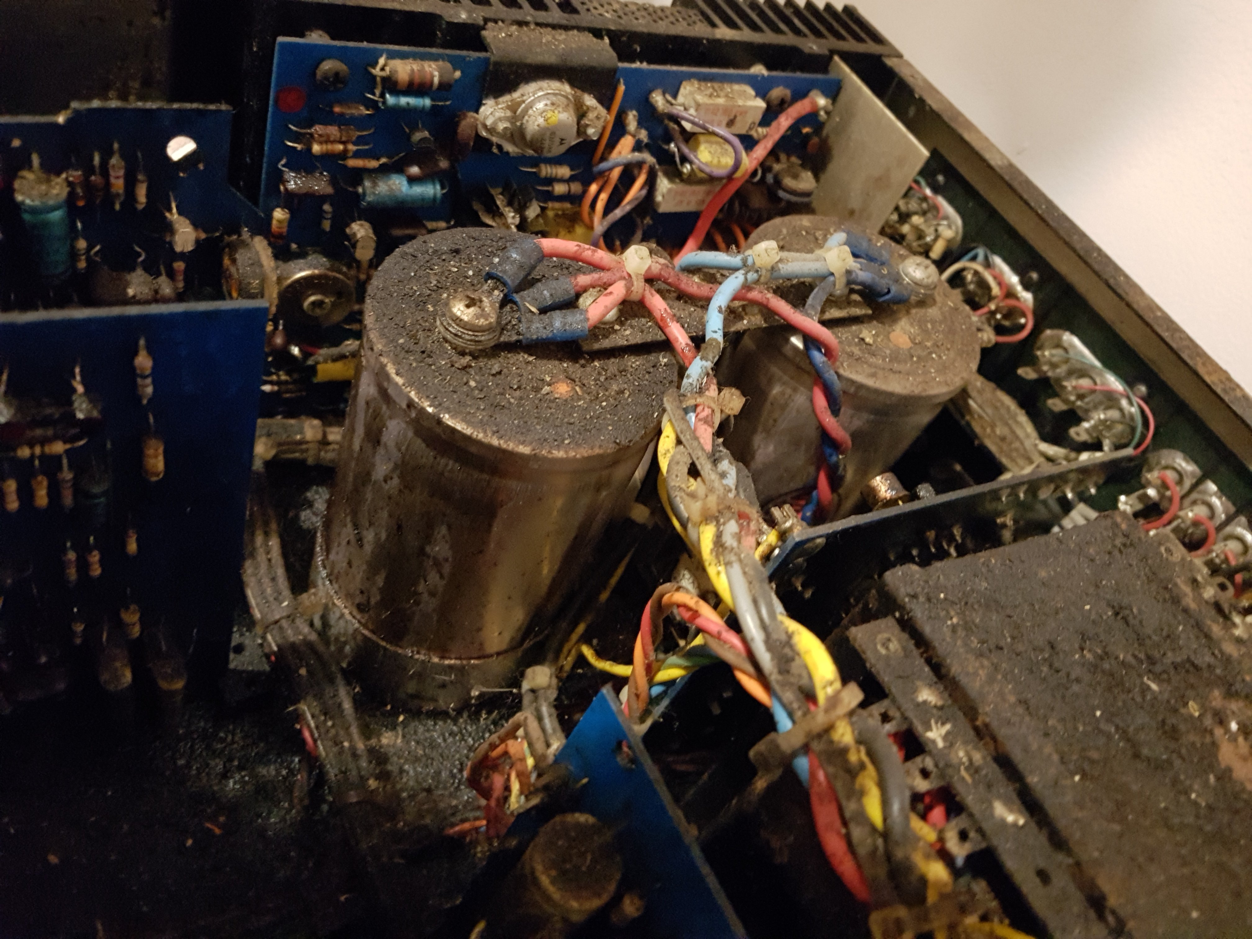

Leonie Elrick Posted June 9, 2019 Posted June 9, 2019 I'll be giving this one a bath and hose down after the sale. If anyone interested, I'm up for a better idea. please approach me. Before you do, this is 30yrs of possums. On the top ladies and gentlemen.
Guest Simonon Posted June 9, 2019 Posted June 9, 2019 I have restored some bad cases but that one is the worst I have seen. A good scrub with soapy water and rinse looks like the only answer. I would be careful soaking the mains transformer and remove it before soaking and look at an alternate way to clean it. The transformer windings will need to be checked for shorted turns and meggered for leakage to ground. After cleaning the unit I would place overnight in an oven at around 60 degrees to dry. Possum wee is highly corrosive and I would expect eaten copper tracks and component leads. Hopefully it has not penetrated the mains transformer or even the printed circuit boards. Good luck with that one.
Leonie Elrick Posted June 9, 2019 Author Posted June 9, 2019 11 hours ago, Simonon said: I have restored some bad cases but that one is the worst I have seen. A good scrub with soapy water and rinse looks like the only answer. I would be careful soaking the mains transformer and remove it before soaking and look at an alternate way to clean it. The transformer windings will need to be checked for shorted turns and meggered for leakage to ground. After cleaning the unit I would place overnight in an oven at around 60 degrees to dry. Possum wee is highly corrosive and I would expect eaten copper tracks and component leads. Hopefully it has not penetrated the mains transformer or even the printed circuit boards. Good luck with that one. Thanks for the tips! I was going to use a hairdryer, but I like the oven idea. And I wouldn't have taken out the transformer.
RonnieG Posted June 20, 2019 Posted June 20, 2019 . Wow, some job in hand, I would take out all the main units (amp, caps, boards, transformer and then probably scrub and wash with brush and use a blower, then the oven). If you can save the boards (not so much the components on it, except maybe a few) and the transformer, you can save this unit, hard to find a donor transformer and an equivalent toroidal does not fit in that small space. So take some small steps to clean, don't rush. also have handy some acetone to get that stubborn gunk off. Do not use water on the preamp connector board (the one with the pots on it). clean it manually with Deoxit D5 or acetone only. Have you fixed a 1200/1200B or a 240/250/250M before?.
Leonie Elrick Posted June 26, 2019 Author Posted June 26, 2019 On 20/06/2019 at 9:06 PM, RonnieG said: . Wow, some job in hand, I would take out all the main units (amp, caps, boards, transformer and then probably scrub and wash with brush and use a blower, then the oven). If you can save the boards (not so much the components on it, except maybe a few) and the transformer, you can save this unit, hard to find a donor transformer and an equivalent toroidal does not fit in that small space. So take some small steps to clean, don't rush. also have handy some acetone to get that stubborn gunk off. Do not use water on the preamp connector board (the one with the pots on it). clean it manually with Deoxit D5 or acetone only. Have you fixed a 1200/1200B or a 240/250/250M before?. Ah no, I have a bit of a fear of electronics. Was badly electrocuted as a toddler. But I'm working on it! Mechanically minded though. 5

Leonie Elrick Posted July 17, 2019 Author Posted July 17, 2019 It made that sweet click, with the smoke stopper, and no fluctuation in the globe either! So she's on the variac now 1
VA50 Posted July 17, 2019 Posted July 17, 2019 Can't believe how well she cleaned up. I bet it going to smell awful when it warms up though. Had possums in the roof of an old queenslander when i was a little kid. Never will forget how bad that stuff smells. Can only imagine what age and heat would do to it. Good work though! looks like you got the most of it out.
Leonie Elrick Posted July 17, 2019 Author Posted July 17, 2019 I have sound! Squeaky, dirty sound! I honestly don't believe it
Leonie Elrick Posted July 17, 2019 Author Posted July 17, 2019 14 hours ago, VA50 said: Can't believe how well she cleaned up. I bet it going to smell awful when it warms up though. Had possums in the roof of an old queenslander when i was a little kid. Never will forget how bad that stuff smells. Can only imagine what age and heat would do to it. Good work though! looks like you got the most of it out. I have to say I was a bit worried about the smell, especially in my oven, and I didn't want to have to do it again. So when I bathed it, I really bathed it! I gave it a good spray with a product from ecoworx. Then a couple of wash and rinses with pine-0-cleen floor cleaner. Only lingering smell as it warmed up was a hint of pomegranate blossom. 1
