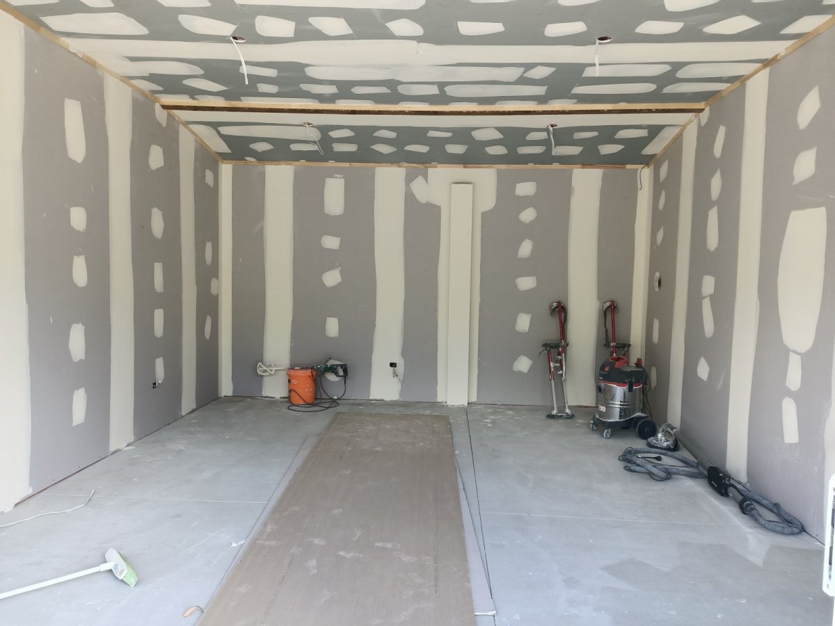

Ceiling decided..... Gyprock but not completely flat, compromise with existing structure. Just need to frame up 2 walls then we can start insulation and lining.
Next have to decide on lighting, was thinking of 6 downlights for full lighting if required and maybe 2 low wattage wall lights down each side on a separate circuit for darker times. Photo is of one side wall.

Just about ready for paint and was thinking about making front wall a feature. Vertical timber slats or batterns sort of like this feature wall.
Your thoughts?

Vertical timber slats in a 1D BAD pattern would look cool and provide diffusion and fairly simple to DIY...but more important than feature walls, what are you planning to do with the brick walls?
You should consider furring channel and gyprock with insulation behind otherwise you'll never get the bass under control. The gyprock walls (and ceiling) provide "compliance" to the room soaking up low bass.
mike

Yea, this is the room now. The walls ended up with a 6" cavity filled with insulation.
That end wall is where I'm thinking of doing the feature, will also help hide the pillar we had to leave just off center.

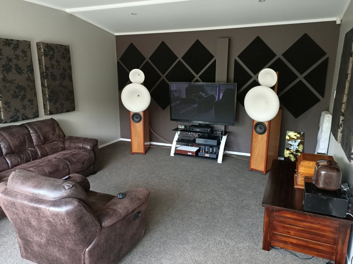

Happy camper!
Still a bit lively in the upper range, sounds good as a starting point.

21 hours ago, TerryO said:
Very Impressive conversion, shame there aren’t a few more pics of the room finished, it would also be good to see how the room and set up looks now.
cheers,
Terry
Sorry Terry, not much more to show...... still thinking about extra absorption panels but the wife wants some wall space for photos/art so I think there'll have to be a bit of a compromise....
Behind the listen chair is a 4.5mtr sliding door (double glazed) so that has a heavy acoustic curtain covering it which means we loose a full wall for art or whatever.
Originally it was just going to be my music room, but as its come up so good it might get commandeered!
