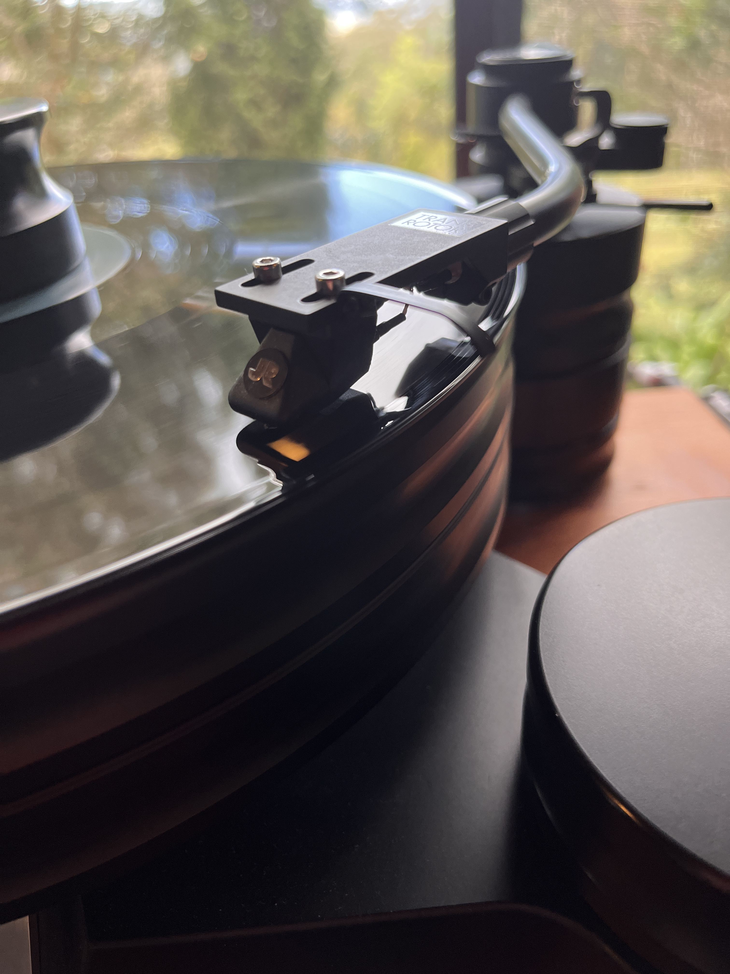

Warren M. Posted February 12, 2023 Posted February 12, 2023 6 hours ago, Warren Jones said: An Allclear Audio re-tipped Grado Opus 3, this has a Boron CL and MR diamond. It's only done 20 or so LP sides and it sounds fantastic, the separation is clearly audible and reminiscent of the Stanton 881s. Anyone with a Grado Opus 3 that needs re-tipping this is worth additional $$. This is the low output version and works with either my MM at 54dB or MC at 64dB. It's currently in the MC with 22kR loading. I found it a little too bright with 47kR. If It's the same rebuild as my JLTi-branded Grado (jlti.com.au) then it's a LOT more than retipped! It really is an astonishing upgrade. I've set the impedance on mine to 10K Ohms. I've also tried 3K. It sounds great at either impedance. I agree that it's a bit too brash at 47K. And lifeless at 100 Ohms. Somewhere in the 1K to 20K range is it's sweet spot (and how wonderfully sweet it is!)
buzz lightyear Posted February 12, 2023 Posted February 12, 2023 6 hours ago, Warren Jones said: An Allclear Audio re-tipped Grado Opus 3, this has a Boron CL and MR diamond. It's only done 20 or so LP sides and it sounds fantastic, the separation is clearly audible and reminiscent of the Stanton 881s. Anyone with a Grado Opus 3 that needs re-tipping this is worth additional $$. This is the low output version and works with either my MM at 54dB or MC at 64dB. It's currently in the MC with 22kR loading. I found it a little too bright with 47kR. That Sp10 looks awesome Warren what arterial did you use to make the plinth.
Warren Jones Posted February 12, 2023 Posted February 12, 2023 @Warren M. It's similar in the CL and diamond but mine hasn't got the damping paint on the cartridge body as it was a re-tip.
Warren Jones Posted February 12, 2023 Posted February 12, 2023 1 minute ago, buzz lightyear said: That Sp10 looks awesome Warren what arterial did you use to make the plinth. The plinth is Permalli. I'll PM you with the details rather than post in this thread. 1
