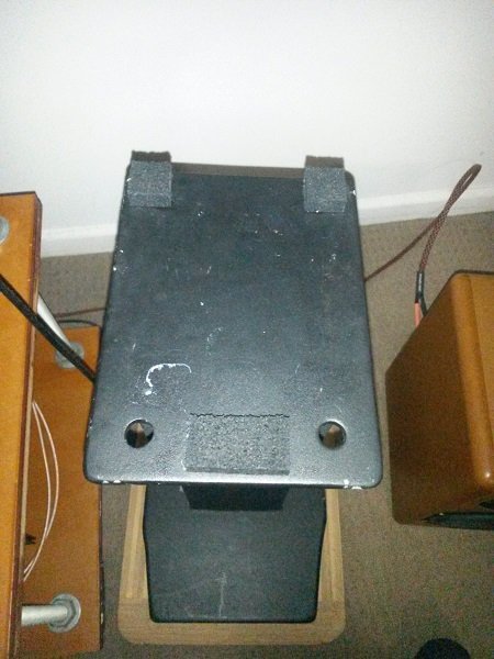

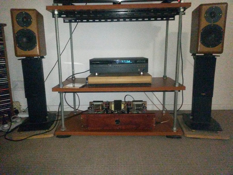

Guest Muon N' Posted January 11, 2020 Posted January 11, 2020 Used litter provides more damping :D I have been going to do my stands for years but still haven't done them, they are made from quarter inch steal but would still benefit from being done, but they weigh a heap now and I'd likely bust a nut moving them when filled if I needed too I really should follow your example :)

Guest Muon N' Posted January 11, 2020 Posted January 11, 2020 (edited) @Spukee yes, you can over damp like with lots of things But I'll have to drill some filler holes at the top through the quarter inch steel, not looking forward to that, and will need to wait till I can buy a good bit. Edit: one cat per post should do the trick! Edited January 11, 2020 by Muon N'

Guest Muon N' Posted January 17, 2020 Posted January 17, 2020 (edited) 14 hours ago, Dave O))) said: Without isolation, damping on it own is not going to give much benefit, it will simply change the resonant frequency of the stand and (hopefully) speed up the rate at which vibrations are dissipated away from the structure of the stand and into the damping material. I think its self evident from reading some posts here that altering the amount of fill in your speaker stands is altering the resonant frequency, referred by many as tuning, of the stands to suit particular tastes, but not completely removing the vibration feedback loop, which is created when the stands are still vibrating (which is still measurable even though you can't feel the vibrations by touch) in sympathy with the speakers. In my experience you will get more benefit primarily from isolation. Damping the support structure underneath the isolation material will provide the icing on the cake. When you have effective isolation under your speakers you can forget about tuning the stands, (but damp them if you can) the speakers simply float. Physically and sonically. My stands are heavy steel and isolated from the floor, but ML-1's sitting on the top plate of the stands with just some small bits of blu tac between. Not sure if they have any kind of fill as I bought these from a guy that used them with BOSE 901's and they were made custom, I am presuming they have no fill but It's difficult to tell with such thick steel I find. Now I like to experiment when something tweaks my interest (see that pun?), and this does! So have just cut up a pair of the small white's anti-vibration blocks you buy from Bunnings and placed those between top plate and ML-1's. There is a difference, not huge....but I think for the better, I'll need to listen more then revert again to qualify any change I am perceiving. Edited January 17, 2020 by Muon N'

Guest Muon N' Posted January 17, 2020 Posted January 17, 2020 (edited) 30 minutes ago, dbastin said: Try IsoAcoustics IsoPucks - a cost effective version of Gaia. They work wonders under my subs. Very far from cost effective on my budget and compared to $1.75 for what I have used, those are $79 per pair and I'd need 3 pairs so that would be $237. Edit: my investment of $1.75 has helped, noticing a little better clarity with some instruments more distinct in the mix, and the sound stage is a little better also. Not the huge difference I noticed when I isolated the stands from the floor, but still It's an improvement. Thanks @Dave O))) Edited January 17, 2020 by Muon N'

Guest Muon N' Posted January 17, 2020 Posted January 17, 2020 (edited) 8 minutes ago, Dave O))) said: I bought a set of isoacoustics pucks for the purpose of testing against a few other products, including some that I am developing in collaboration with a couple of very bright SNA sparks. @Muon N' it shouldn't take a large spend to achieve noticeable results as you have found. I'm hopful that my friends and I will be able to offer a range of cost effective engineered isolation solutions, but the proof is in the pudding and we intend to find out out whether the budget conscious audiophile will be able to have his pud and eat it too Sounds good, I'm thinking about a constrained layer solution right now based on these anti-vibration blocks as a layer. Edit: I'm thinking of two layers of this with a thin Bamboo sheet between, likely won't reach the level of something better engineered but will suit my budget and I'm using materials I have found to work together. Edited January 17, 2020 by Muon N'
Soundscape Posted January 17, 2020 Posted January 17, 2020 7 minutes ago, Muon N' said: Sounds good, I'm thinking about a constrained layer solution right now based on these anti-vibration blocks as a layer. Edit: I'm thinking of two layers of this with a thin Bamboo sheet between, likely won't reach the level of something better engineered but will suit my budget and I'm using materials I have found to work together. Could I suggest that you try the bamboo pieces as a damping layer fixed to the top of the speaker stands with glue and/or screws then use the bunnings pads as the isolation interface between that and your speakers? I reckon you'll get good results that way
Guest Muon N' Posted January 17, 2020 Posted January 17, 2020 15 minutes ago, Dave O))) said: Could I suggest that you try the bamboo pieces as a damping layer fixed to the top of the speaker stands with glue and/or screws then use the bunnings pads as the isolation interface between that and your speakers? I reckon you'll get good results that way That's similar to what I have done under the stands, Bamboo on top of the Anti-vibration pads This R&D is hot sweaty work, oh wait! that's just this weather
Soundscape Posted January 17, 2020 Posted January 17, 2020 Ah yes, water trickling down skin... I can do that sitting on my bum So long as the bamboo has a strong bond with the steel plate it should work well. There's always a compromise between damping/isolation and ultimate stability. Lettuce know how it goes
Guest Muon N' Posted January 17, 2020 Posted January 17, 2020 (edited) Will seek out some Bamboo of appropriate thickness, I think IKEA has some small boards that may do. I'm actually thinking the other way around with the Bamboo on top, but will experiment Edited January 17, 2020 by Muon N'
