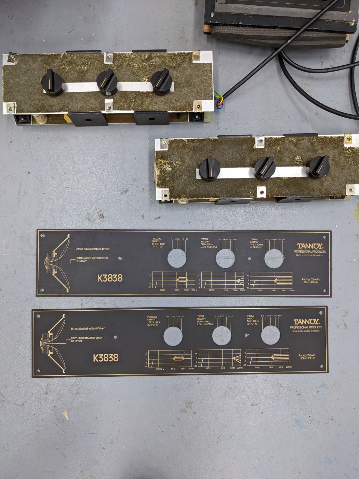

On 07/01/2022 at 4:14 PM, naggots said:
They finally arrived just before Christmas, I didn’t have chance to connect them until now and WoW
The location is temporary but I had to hear them, this room is 10 x 6m and the Tannoys have no problem filling it to party levels, no subs required….. I had no idea they be this good.
Lx4man did an incredible job fixing these up. One woofer was seized and voice coil melted. He replaced both the cones with the last NOS 12” monitor gold cones with rubber surrounds known to exist by Mainly Tannoy. He also recapped the crossover and realigned the tweeters etc…… they are as good or probably better than when my Dad bought them in 1967, the year I was born.
Internally re wired with new MainlyTannoy 4pin plugs. The crossover adjustment knobs are in tact and cleaned. Custom engraved and paint filled Aluminium rear plate with ETI posts from Mallards Signs.
The 120L ish cabinets Aranmar made are about 2x the size of the dilapidated originals, fully lined and braced and specifically designed to suit the drivers rebuilt measurements after 20-30hr continuous run in.
They sound fantastic, I wasn’t expecting the bass to be so deep and the soundstage so open. I’m using a Blusound Node2i  for now. My dads Technics TT doesn’t sound as good and there’s a hum in the L channel so a little more investigation required with Phono input. The Blusound on Aux1 however is clean, deep and wide…… gives my Zu Druids and Weston KT120  competition for sure.
The fit and finish from Aranmar cannot be faulted……..I haven’t seen timberwork this good in a long time……. flawless.
John also remade the wood box for my recently serviced Marantz 1060. It looks equally amazing and drives these Golds perfectly……. Amazing how good a 1974 amp and large diameter, efficient speakers can sound…….. goes to show that my parents partied as hard as we can with a lot more power at hand nowadays

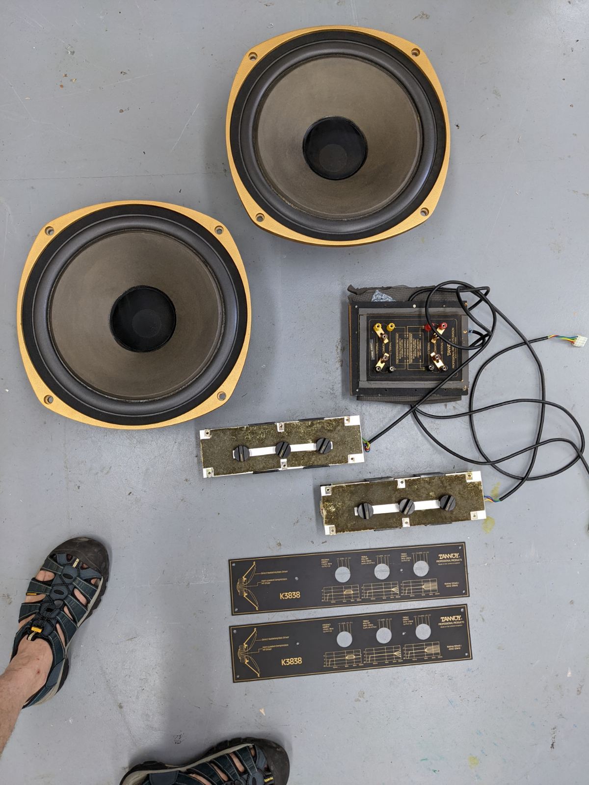

On 12/12/2021 at 2:44 PM, sleach said:
My plan is build some basic cabinets to the tannoy recommended specs. I might experiment with some of the horn loaded designs down the track
I've finally started construction of the cabinets. The build is based on the largest cabinet recommended in the k3838 Manuel. I have 4 100mm port tubes per speaker, hoping to get something that looks like an m1000. Any suggestions from experts at this stage would be great, the manual is not overly detailed.IMG_20220502_163333.thumb.jpg.687b1ba2869a454d83fb7440991a766f.jpg
I would suggest that having the T & S parameters measured would be the first step to take . Once these important figures have been established then a suitable  cabinet  can be designed.

Finally my Tannoy project is complete and the speakers have been shipped back to me in New Zealand. Aranmar Acoustics did a great job and Brian Arnstein did a really nice job on the drivers (regaussed, rewired and fettled.
I had the XOs built by Mainly Tannoy. Cabinets are 107 liters internal, Birch Ply construction and lead lined.
