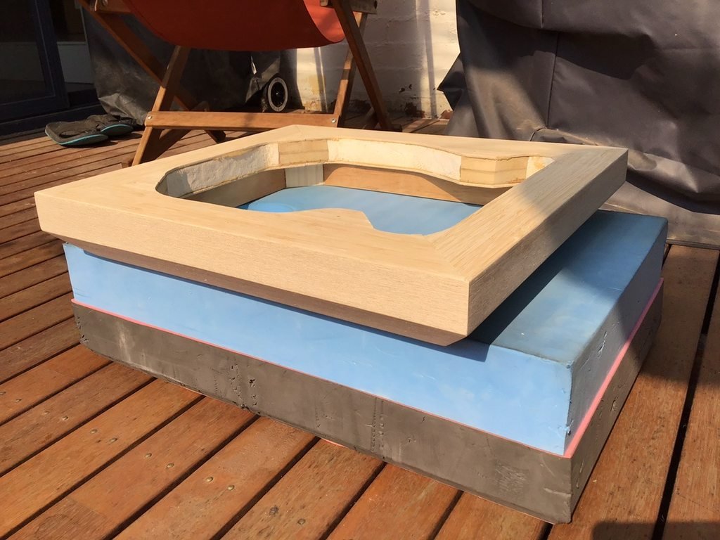

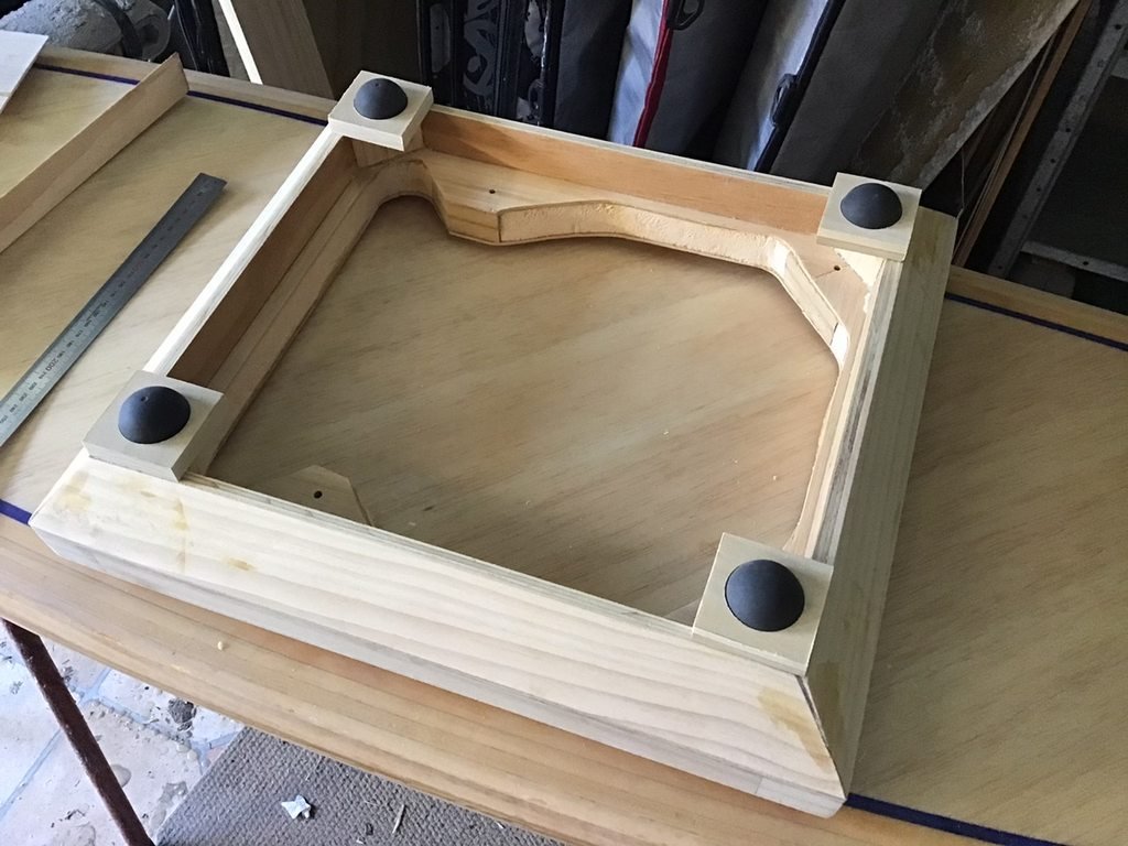

There seems to be a few turntable manufacturers currently dabbling in light weight, minimalist plinth designs, in contrast to the more traditional designs.
If stiffness and damping are more important for a plinth than mass, does mass actually add anything, apart from better stability against external forces?
Here is my attempt at this concept, which is still yet to be tested. Extruded polystyrene and bamboo ply sandwich, with pine and paulownia sides, and a simple veneer.  Simple to make, very stiff, well damped, and weighs in under 2kg.

Super lightweight! I’m planning to imitate the Loricraft lightweight approach for the Lenco - shares the use of sorbothane spheres I see : D
interested to here more impressions, it looks great

Nice looking plinth.
But as for the theory, I am sure it isn't the light weight that is the parameter actively making it work in these modern plinths.  It's the exotic materials and construction that work to make it sound good, and the ability to make it lightweight is a plus for the consumer, not the sound.     However added  mass could further improve things as it acts in a different way.  So, I would think you could combine the skeletal foam filled sandwich design by coupling any remaining vibrations to a massive sound/vibration sink.

That’s a very nice piece of work. As a once-was picture framer I’ve been toying with idea of having ‘picture frame’ plinth made up. There are some oversized mouldings available - 60mm in depth - made from some solid timber species and in a variety of finishes including some nice coloured timbers and black of course. They could be perfect for a drop-in toplate such as the one in your photograph. Watch this space...

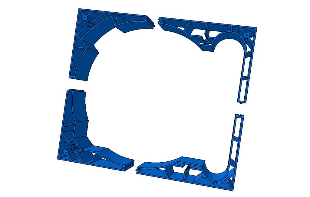

I’ve also got another idea on the go for the Lenco. A 3D printed plinth chassis which could then be clad in something a little more visually pleasing, and the voids filled with a dampening/stiffening material of choice (epoxy resin, concrete, sand, etc). I have already modelled the design, but it will be a while before I get around to getting it printed. I’ve separated it into four parts so they’re small enough to be printed on a domestic 3D printer and then glued together.

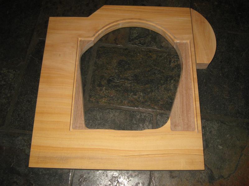

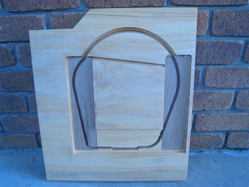

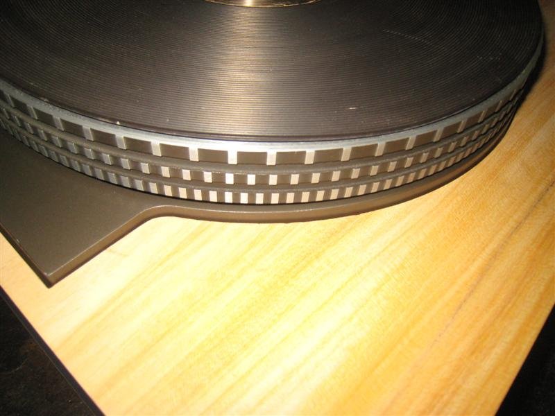

Built a skeletal plinth a few years ago
Used two different timbers to counteract resonance - the main timber used is called Crows Ash
This plinth would be the 4th or 5th plinth build since the early 70s when I purchased the Garrard 401
And so far it’s the best sounding plinth build so far and still in use to this day.
Full build details here
https://www.stereo.net.au/forums/topic/82084-garrard-401-rebuild-for-the-22nd-century/
Here are some photos for you
post-112724-0-54521000-1350956370_thumb.
post-112724-0-35262500-1350956422_thumb.post-112724-0-53556400-1350956550_thumb.
post-112724-0-59889300-1350956592_thumb.

Before I talk about the plinth itself in the picture you plinth is also the cupboard. Your feet are wood and I hope sorbothane?You need to isolate the plinth form the shelf it sits on in your case the plinth is sitting on a sound box. For isolation, think Sorbothane not spikes as they couple the plinth more to what it sits on.
