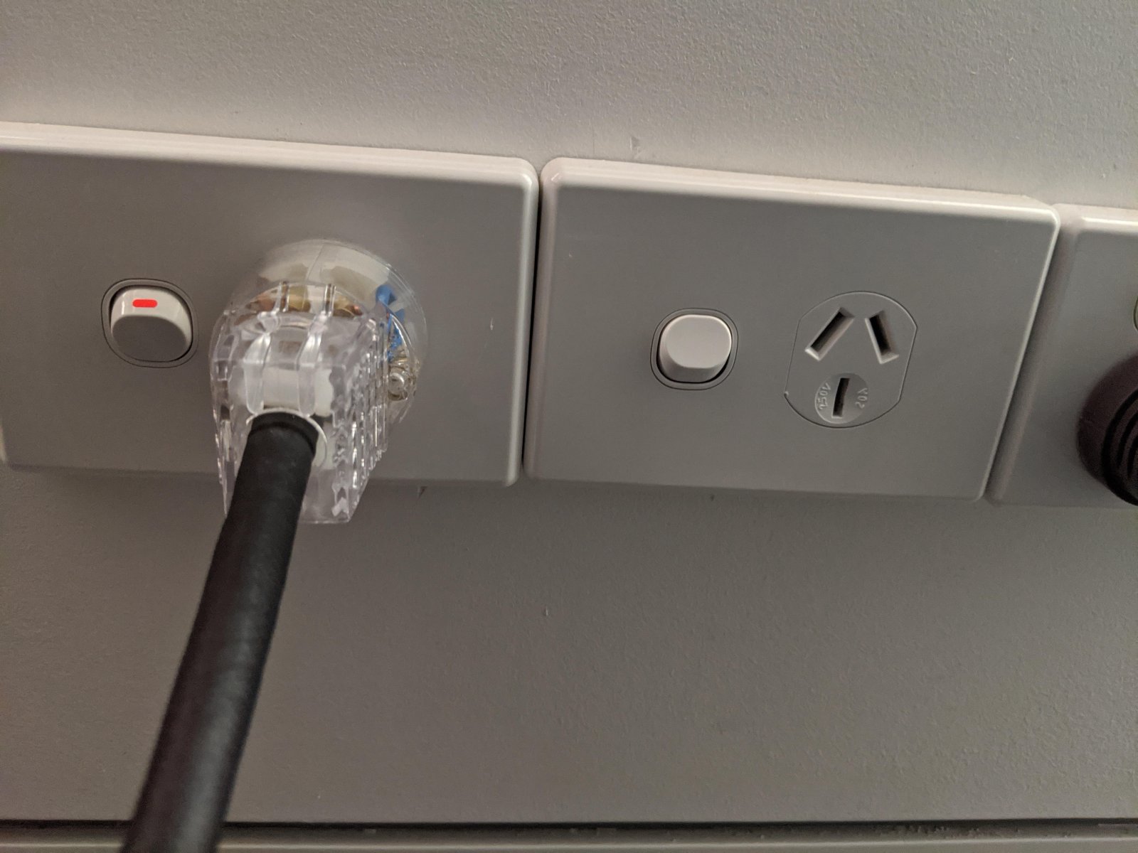

Ittaku Posted August 8, 2020 Posted August 8, 2020 Multiple runs have the potential for inducing earth loops between components. Go with one super fat one instead. Given the option, you could put 20A powerpoints on the wall as well - you can plug ordinary 10A leads into it but it gives you the option of using 20A plugs if you end up getting custom made power cables which have more contact area. I had 3 separate lines put in - one for each power amp and one for the rest of the components, and it only introduced problems with my sensitive preamp and found everything worked better off the one line. You can see the 20A connectors below. The power cord on the left now powers everything (to a regenerator) using a custom modified power cord with the CLIPSAL 1439/20TR | 3 Pin 20Amp PlugTop connector. In my experience all of the rewiring made zero positive difference to the sound, but at least I need not worry about tripping breakers in combination with other components that were on the same circuit before the rewiring. 2

Lochawe Posted August 9, 2020 Posted August 9, 2020 (edited) 43 minutes ago, Ittaku said: Multiple runs have the potential for inducing earth loops between components. Go with one super fat one instead. Given the option, you could put 20A powerpoints on the wall as well - you can plug ordinary 10A leads into it but it gives you the option of using 20A plugs if you end up getting custom made power cables which have more contact area. I had 3 separate lines put in - one for each power amp and one for the rest of the components, and it only introduced problems with my sensitive preamp and found everything worked better off the one line. You can see the 20A connectors below. The power cord on the left now powers everything (to a regenerator) using a custom modified power cord with the CLIPSAL 1439/20TR | 3 Pin 20Amp PlugTop connector. In my experience all of the rewiring made zero positive difference to the sound, but at least I need not worry about tripping breakers in combination with other components that were on the same circuit before the rewiring. I also concur that one single circuit is worth considering (in spite of widespread recommendations for 'more circuits are better') and it worked better for my system compared to multiple dedicate circuits. I tried this in my own room after being advised by a number of good friends around the world (who had transitioned from very well considered systems with multiple dedicated circuits), confirmed their were advantages to running the entire system from one single circuit. In. my case, it has enabled an unparalleled sense of coherence, which was remarkable given this was already a hallmark characteristic of my system. @Sean Perth – I still recommend 56 Series outlets which gives you advantage of 20A connection without needing to use 20A AUS AC plugs. The 56 Series outlets have a 20A rated backend with a 10A fascia with which will allow you to use premium AC plugs like Furutech AU3112 for example with snug fit which will easily outperform any 20 A plug with inferior metallurgy (brass versus Furutech's high purity copper). The switch comparison between 10A domestic GPO and 56 Series 32A makes that choice a no brainer from what I can see. 1 hour ago, rmpfyf said: Lapp sells direct to public - their website is worth a look, particularly the VSD stuff. It's the basis of a LOT of 'audiophile' power cable. Regarding the Gigawatt cable and Circuit Breaker (which IS a rebadged Magnetic Circuit Breaker manufactured by world leading industrial manufacturer CarlingSwitch in US) – and whether the cable is simply rebadged LAPP or some other manufacturer's 'readily available' VSD cable, I am not entirely sure – but I know many people that have installed the Gigawatt LCY cables across Australia and it seems that the supplier cannot actually keep up with demand because word of mouth testimony has ben so strong. I understood the cable is certified for use in Australia but I am not able to personally confirm this as factual or not. Given it is being widely installed would suggest that there are numerous electricians willing to install it which I would have assumed could not be the case if this cable was obviously non-compliant. Either way @Sean Perth, here is a review of the Gigawatt cable and Circuit Breaker that makes for interesting reading and compares several other more standard in-wall cabling options: https://www.hifi-advice.com/blog/review/accessories-reviews/gigawatt-part-1/ Edited August 9, 2020 by Aperalim typo
