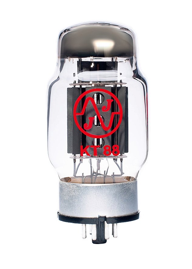

Relaxasaurus Posted December 3, 2020 Posted December 3, 2020 True! It's a never ending journey it seems, not really in a bad way. Pardon the dust but currently breaking in the Gold Lions: I dig the look of the Gold Lions branding On the stock Muzishare KT88 tubes, I don't think they're exactly JJ's. Notice the JJ's have round circles in their plates while the Muzi's do not. More clearance after the bottom spacers too, though spacer sizes are similar. The Gold Lions definitely have beefier internals: Another note is the stock Muzishare 12au7's seem a bit cheaply made. Not sure how much this matters but the spacers are very slanted compared to 3 other brands of the same tube I have here. 1 1

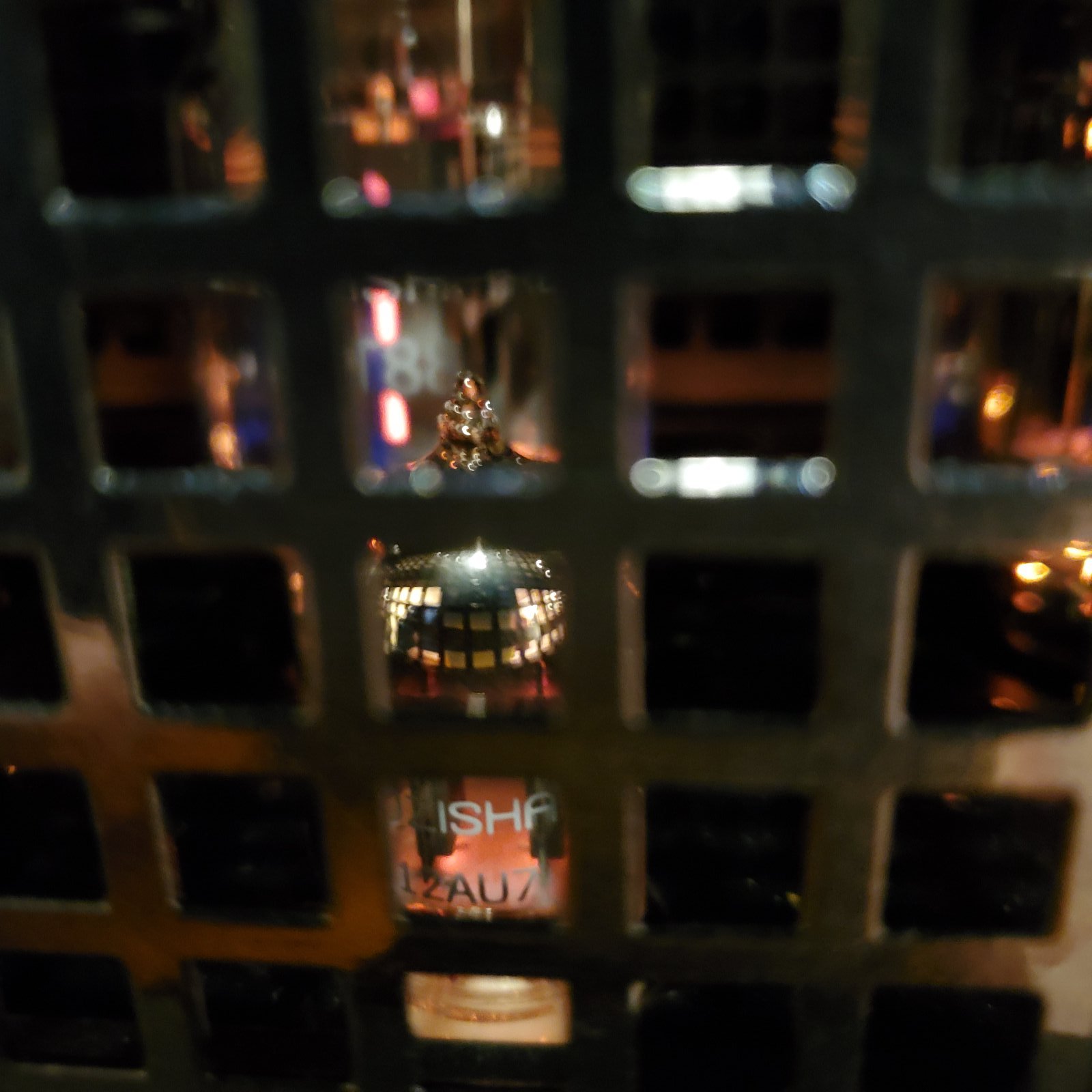

artur56 Posted December 4, 2020 Posted December 4, 2020 Hello! I wonder if U can check my bias adjustment - the scale in manual is different than in my muzishare X7. Is the value right - 40mA ? Thanks for help. I am thinking about step up to Genalex Gold Lion KT88. Is it a good choice ? Photo of my bias adj 1
xlr8or Posted December 4, 2020 Posted December 4, 2020 (edited) Yes - it's 40 mA. Ignore the scale below 20 mA, as its divisions are different - split into divisions of 5 mA between 10 to 20 mA. Between 20 and 60 mA each division represents 10 mA. Edited December 4, 2020 by xlr8or 4
artur56 Posted December 4, 2020 Posted December 4, 2020 Thank You! After 3 hours of playing, bias has changed on V4 to almost 80mA. Is it normal ?
xlr8or Posted December 4, 2020 Posted December 4, 2020 20 minutes ago, artur56 said: Thank You! After 3 hours of playing, bias has changed on V4 to almost 80mA. Is it normal ? No - this is not normal. When checking/adjusting bias make sure that no signal is passing through the circuit. Can you adjust it back down to 40 mA? You want to avoid any red plating of the tubes as this may take out the output transformer or the grid circuit. Let us know how you get along. You may have a faulty tube. 2
artur56 Posted December 4, 2020 Posted December 4, 2020 1 hour ago, xlr8or said: No - this is not normal. When checking/adjusting bias make sure that no signal is passing through the circuit. Can you adjust it back down to 40 mA? You want to avoid any red plating of the tubes as this may take out the output transformer or the grid circuit. Let us know how you get along. You may have a faulty tube. I have re-adjust all tubes from 0 mA to ~40mA with disconnected all intputs. Will see how manny mA will we get after 2 hours of playing. 1
artur56 Posted December 5, 2020 Posted December 5, 2020 I think, You are right. Today I have replaced tube from V3 and change its position to V2, and V2 landed in V3 slot. I readjusted bias, and after some time the value has increased above 55 mA. If I set bias on this tube lower than 37-36 mA, after some time the value is decreasing, falling to 30mA. I think it is a time to change KT88 tubes ? 1
xlr8or Posted December 5, 2020 Posted December 5, 2020 (edited) 4 hours ago, artur56 said: I think it is a time to change KT88 tubes ? Unfortunately, yes. It appears the tube is faulty and drifting away from its set bias value. I would recommend getting yourself another single tube if the existing other 3 are still new. If not, get yourself a new quad set. Made in Russia Genalex Gold Lion KT88's are quite reliable. Edited December 5, 2020 by xlr8or 4 1
