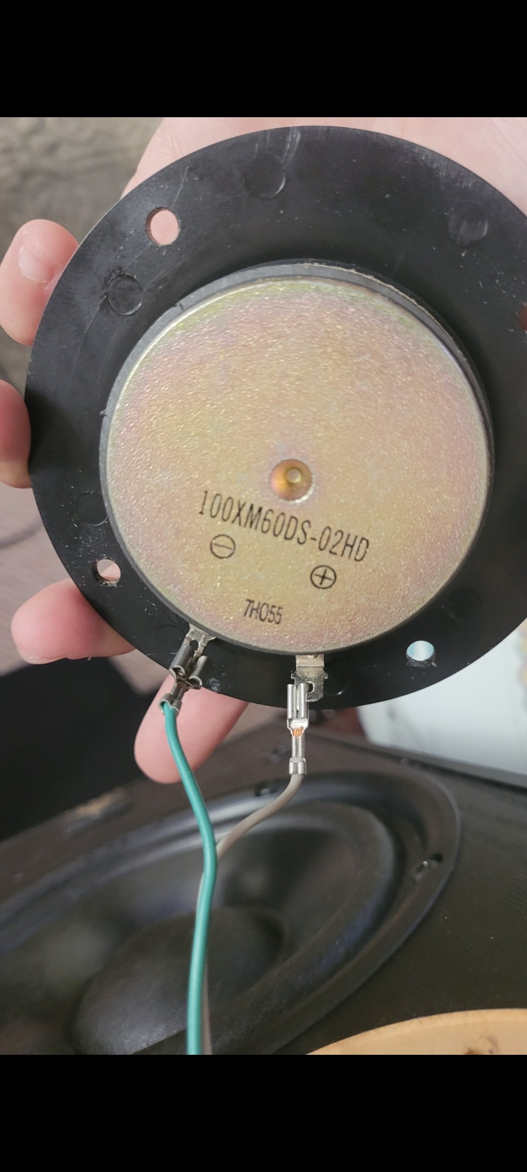

So I got my tweeter repaired.
But was surprised to find that the small spade terminal was fitted to the large (positive?) Terminal by clipping it in half. I.e reverse polarity?
Has anybody else noticed this ?
The speaker schematic doesn't suggest this. I've had them since new
