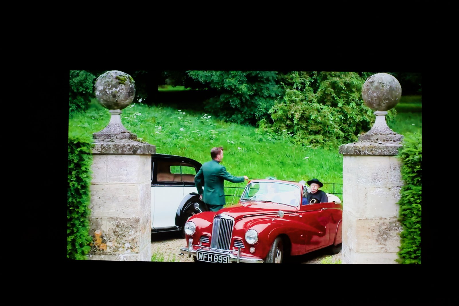

TP1 Posted October 2, 2020 Posted October 2, 2020 For comparison purposes I used a still frame in a 1080 streaming video on Apple TV. This image is with standard SMPS Next Image was with Linear PSU in place. Differences are more noticeable with video running but essentially colour seems better saturated and rendered with Linear PSU and contrast a touch better too. On the big screen, the green and red looked more realistic. I use the same LPSU to power Lumagen and Zappiti. 1
