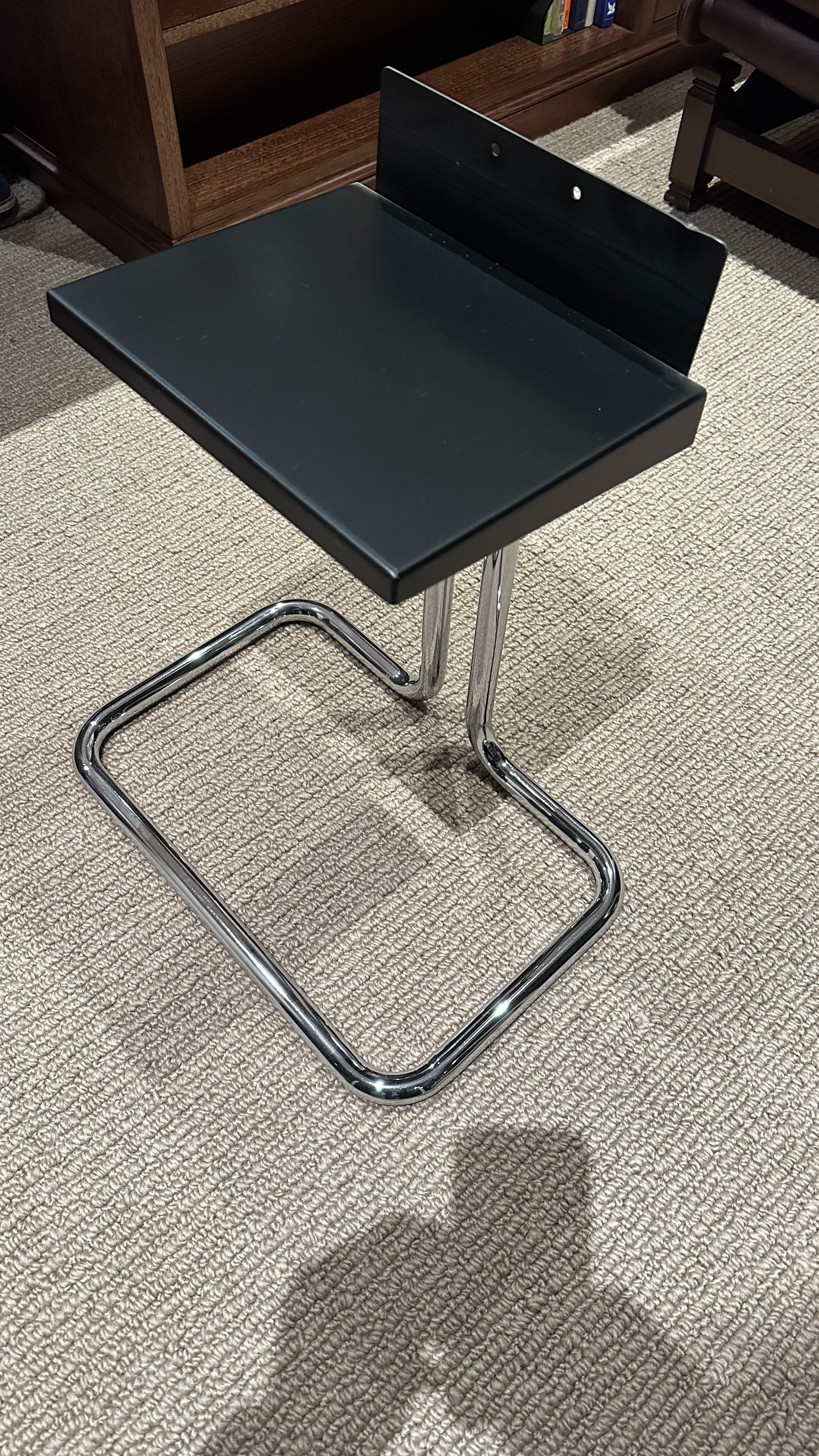

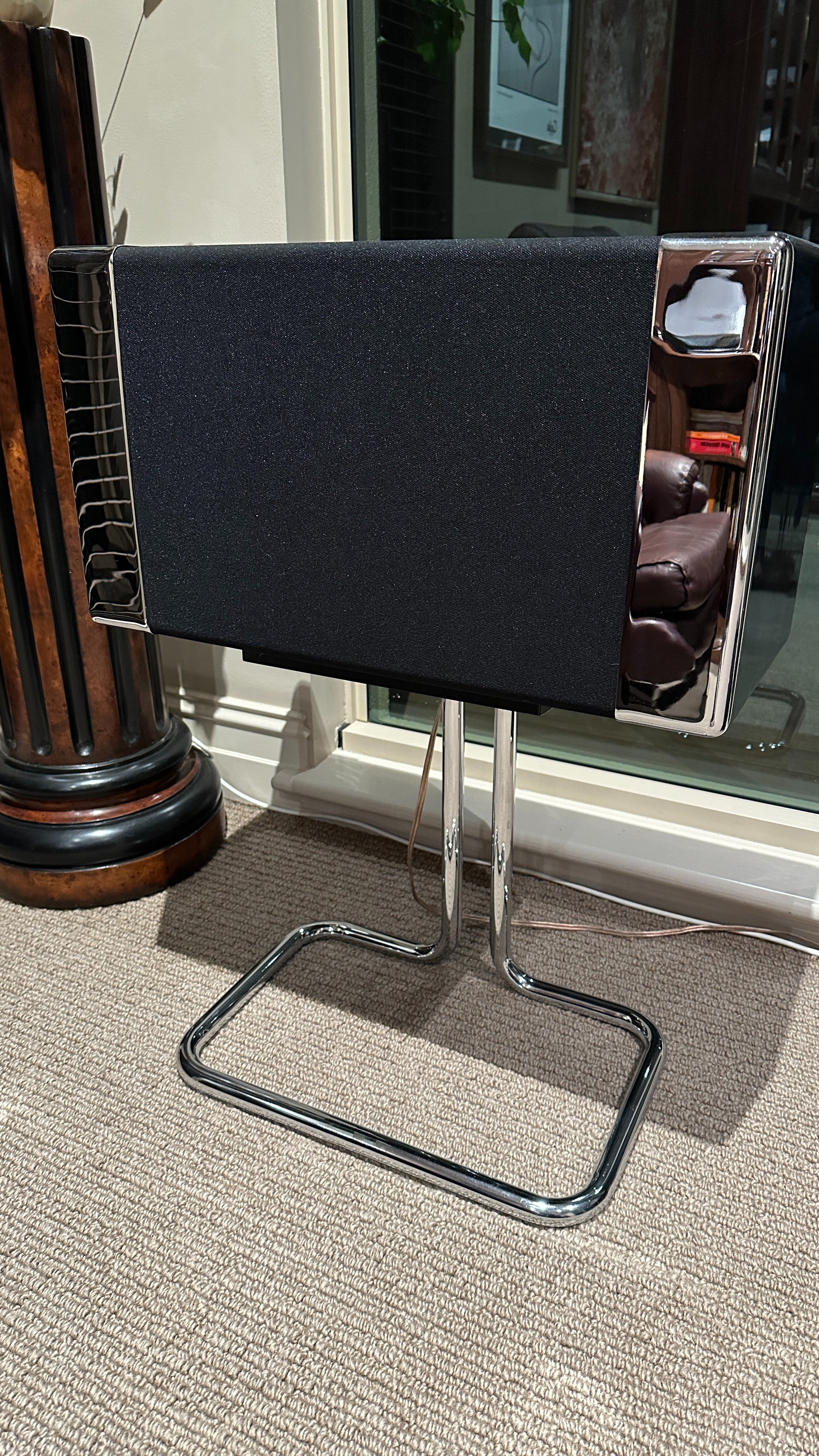

Peter_F Posted September 15, 2011 Posted September 15, 2011 Despite all the Gales I have owned I have never laid eyes on a set of original Gale stands for the 401's. IMO they look sensational but i have concerns about how they would effect the bottom end due to what appears the speakers float or bounce as opposed to being rigidly secured. I would be interested to hear what others would experience with this new production. Cheers, flemo.

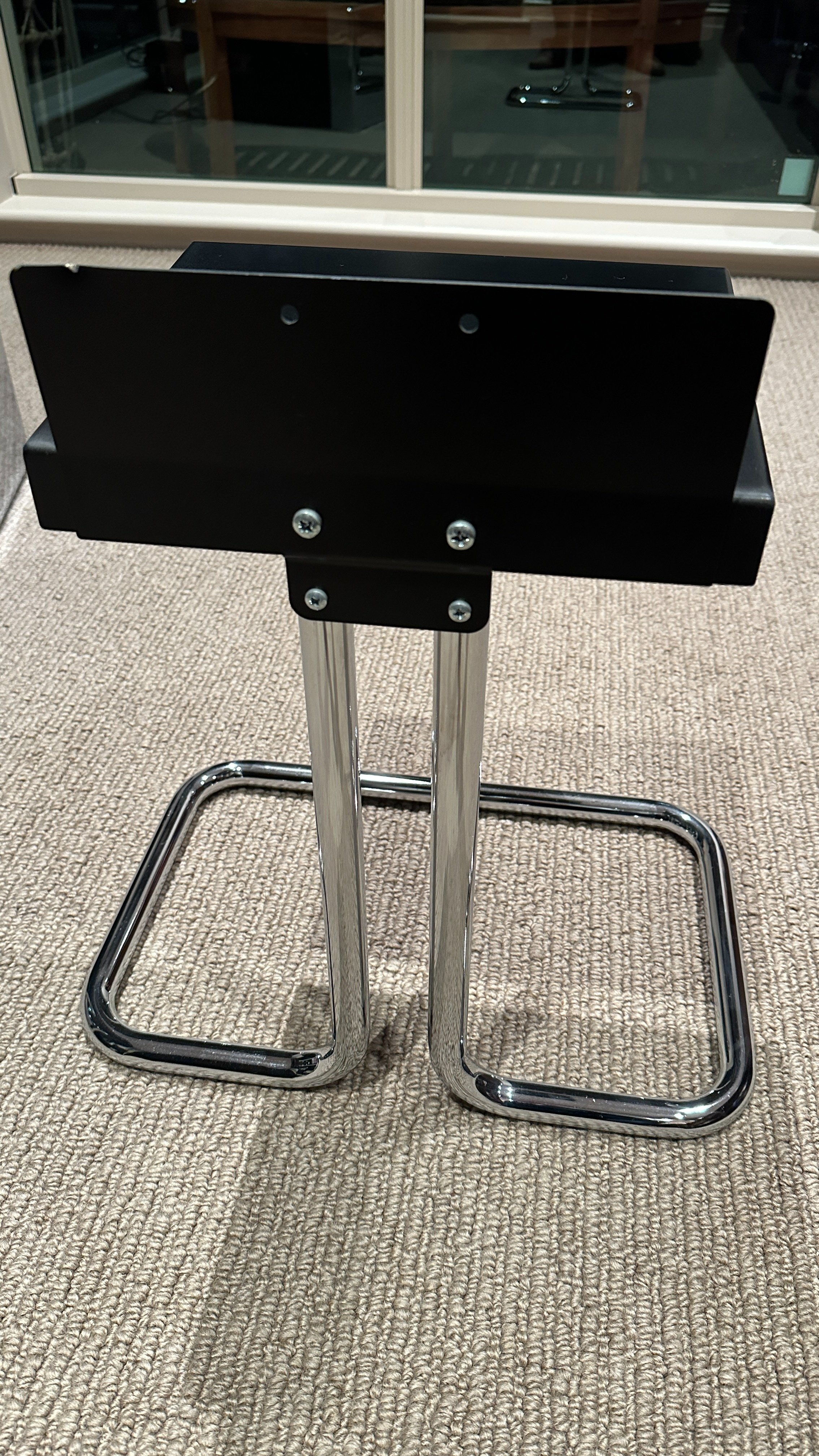

Tony M Posted September 15, 2011 Author Posted September 15, 2011 (edited) Here's a bit more info on the new stands. I will be ordering at least one pair. The cheapest shipping quoted is Fedex @ about 150 British Pounds. Exxy, but not OTT IMHO. "We discussed getting tooled up to make the stands starting about 2 years ago but the cost was high and it remained on the shelf until now. The stands are being made by a company in Norfolk who in the past have made casework for the HiFi industry including EAR and the old Cambridge Audio, they had the facilities to laser scan a full size original stand to get exact measurements so these copie will be 'exact' copies. The old tube was obviously not metric way back in the 70's it was around 20mm equivalent so I have upped the tube size to modern day 25mm. The old originals had a joint at front floor level as back then they could not bend the tube as one piece and had to do it in two halves today with new technology they can bend the whole thing in one go. They are made in three parts, the tube section which is chrome plated, the shelf section which is black powder coated and the rear brace which is black powder coated. You could before assembling them fill the tube section with fine sand or even go mad and pour in some lead shot!" Overall, it sounds cheaper and less of a hassle than trying to get them made locally. Filling with lead shot sounds like a good option. At least the speakers can be popped on and off different stands as required. Edited September 15, 2011 by Tony M

TP1 Posted December 13, 2011 Posted December 13, 2011 Are yours spring loaded like the originals so that when you place the speakers on them they compress slightly and remain under tension?Cheers, flemo. Actually, there was no springs involved in the original stands. They had originally a 5 degree upward lift on the shelf which was there to compensate for the 20 kilo load that is dropped on it. The new stands built in the UK also have this.

ozcal Posted December 13, 2011 Posted December 13, 2011 T , I thought the unloaded upward tilt was a lot more than 5 degrees. Putting the speaker on the stand gave the speaker a 5 degree tilt with the stand in it's loaded position ?
Guest Posted December 13, 2011 Posted December 13, 2011 Actually, there was no springs involved in the original stands. They had originally a 5 degree upward lift on the shelf which was there to compensate for the 20 kilo load that is dropped on it. The new stands built in the UK also have this. I don't think anyone suggested there were actual springs in the construction, rather that when under load the natural tension created acted somewhat like a spring.
