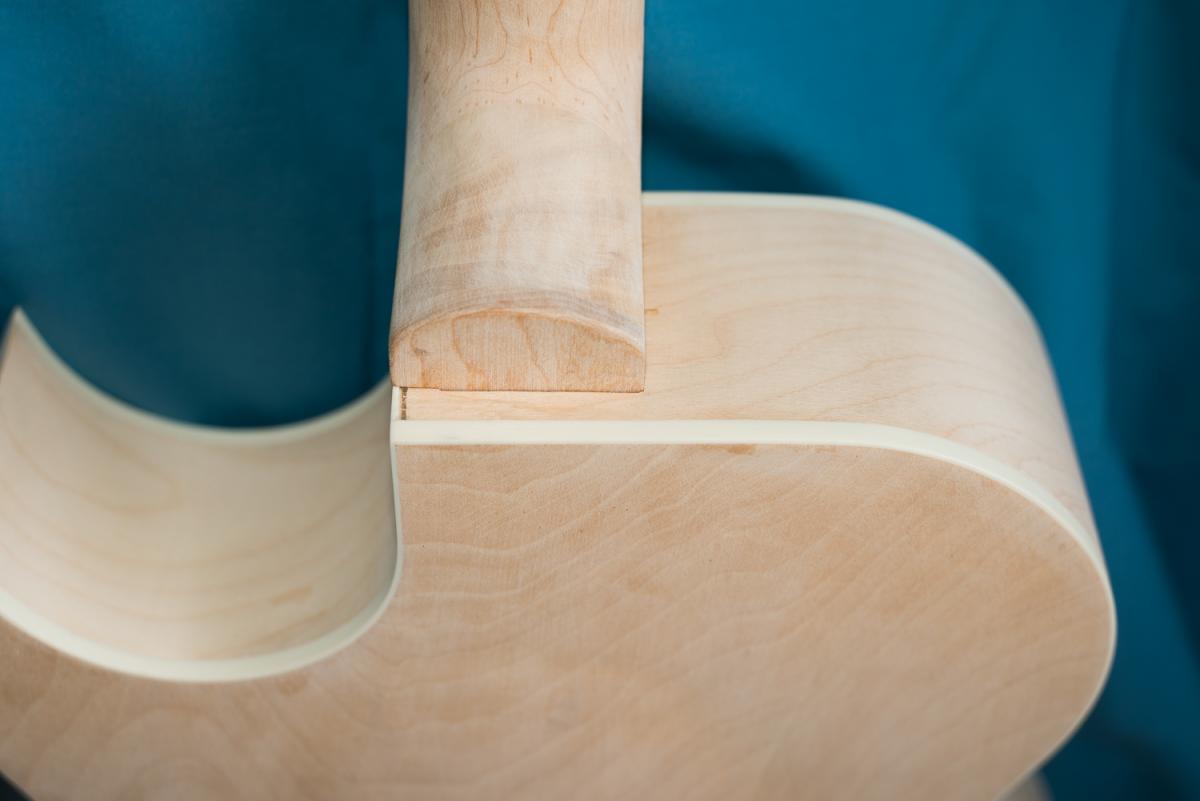

zenikoy Posted February 17, 2016 Posted February 17, 2016 (edited) On 27/01/2016 at 10:03 AM, Tweaky said: The thing with semi's is that they are a lot of work to upgrade if you buy a copy and find it lacking. Secondhand Gibson semi's still cost a lot, and they probably need some work on them as well. I had given it some thought to both, but then I discover Pitbull guitar kits. https://www.pitbullguitars.com/guitars/ I bought a ES- 1G, ES-3 and a Bass kit....I only wanted the bodies and necks, everything is being modified to suit what I want....a unique custom shop guitar at a bargain basement price.....the only limitation is my imagination and my construction expertise. Since real Gibsons and the kits of these two models are both made of Ply and either Maple or Mahogany, it seemed a no brainer to at least try theses particular kits out.....especially when you see the quality of some of the current guitars coming out of Gibson's Nashville factory , not that good...their Acoustics from their Montana factory are still good. I've bought totally new hardware, electronics, tuners and Kinman noiseless pickups for both [each set of pickups cost $250 more than each kit did LOL ] Hey @@Tweaky, how are these builds going? I've just pulled the pin on a ES-175 kit from DIY guitars which seem to be much the same as the Pitbulls. Was going to also try the Jazzmaster but thought better to invest the elbowgrease and swearing into a flashy big semi accoustic. Going for the stock build and depending how it turns out aesthetics & playability wise I may upgrade the electrics. Like yourself I have a real 335 to use as a comparison base. http://www.diyguitars.com.au/product/gibson-es-175-hollow-body-guitar-kit-ath25/ Man if I could make it look any near like this http://www.diyguitars.com.au/topic/my-ath-25-archtop-full-hollow-body-guitar-kit-build/page/2/#post-5882 Edit: OK found you http://www.buildyourownguitar.com.au/forum/showthread.php?t=4988&highlight=tweaky Edited February 17, 2016 by enikoy 1
Muad Dib Posted February 17, 2016 Posted February 17, 2016 On 17/02/2016 at 1:44 AM, enikoy said: Hey @@Tweaky, how are these builds going? I've just pulled the pin on a ES-175 kit from DIY guitars which seem to be much the same as the Pitbulls. Was going to also try the Jazzmaster but thought better to invest the elbowgrease and swearing into a flashy big semi accoustic. Going for the stock build and depending how it turns out aesthetics & playability wise I may upgrade the electrics. Like yourself I have a real 335 to use as a comparison base. http://www.diyguitars.com.au/product/gibson-es-175-hollow-body-guitar-kit-ath25/ Man if I could make it look any near like this http://www.diyguitars.com.au/topic/my-ath-25-archtop-full-hollow-body-guitar-kit-build/page/2/#post-5882 Edit: OK found you http://www.buildyourownguitar.com.au/forum/showthread.php?t=4988&highlight=tweaky on upgrading electrics. 1) PITA to do once you have them installed in a semi. 2) Better pots (CTS, even Alpha) cost bugger all. Same with caps, unless you believe the ju ju. Even PIO vitamin Qs are only about 10 bucks. 3) Do it right first time, then you don't have to worry. Good luck. These guys are good for parts- https://www.guitaraust.com.au/ and I suggest Mick Brierly pickups. Strongly suggest, give him a buzz. 1
Tweaky Posted February 17, 2016 Posted February 17, 2016 (edited) Well I sort of got side tracked for a while doing other things, so the only real effort started earlier last week. This is the neck of the ES-175 build, I shaped the headstock to look like a 50's Gibson....the inlays are stock, but when I got my micro mesh sanding stuff, I thought I'd try it out on them, it really made the inlays pop....then staring at them for a week and a bit I though, No, they are not going to suit the build, so I have removed them and I'm going to replace them with MOP. Here's a easy way to remove inlays if you ever want to do it, just get a piece of old cotton T-shirt material and a 40w soldering iron, wet the material and place over the inlay, then heat with the soldering iron, it heats the glue holding them in and you can just pick them out with a exacto knife..... it also doesn't heat up the frets, so there is no danger of then coming out, which is what would happen if you used a heat gun. Here's some of the different shell I bought and have been testing, from L to R, White MOP, Gold MOP, Red Abalone, Green lipped Abalone...the pieces at the back are how the come from the supplier, the front bits have been polished up to 12000 grit. I extended the neck heel on both necks, on the ES-175 build it was to cover a gap in the binding [before and after shots]...still needs some work, but it came out ok. Same sort of thing with the ES335 build, except in a different place, I want to remove that piece of binding arrowed....the neck heel is now flush to the back of the guitar like my Gibson. The ES335 build was routed for Humbuckers, here it is with the Kinman template for the P90's, and after I stuffed them up, sorry routed them out. [ the top cavity is a bit rough - but fixable] I also had to enlarge the Tone / Volume pot holes from 8mm to 10mm on both guitars for the upgrade. So that's basically where these builds are at ATM. Edited February 17, 2016 by Tweaky 5
zenikoy Posted February 17, 2016 Posted February 17, 2016 (edited) On 17/02/2016 at 6:17 AM, Tweaky said: DSC0347.jpg Wow, that top is going to have some flame when finished. Looking great as raw timber. I'm thinking a "vintage" amber/honey stain for mine sealed with a satin lacquer. Edited February 17, 2016 by enikoy
Tweaky Posted February 17, 2016 Posted February 17, 2016 On 17/02/2016 at 7:29 AM, enikoy said: Wow, that top is going to have some flame when finished. Looking great as raw timber. I'm thinking a "vintage" amber/honey stain for mine sealed with a satin lacquer. Do yourself a favour and try to find as many build diaries of the same model you have to see both what people have done right, and how they have stuffed up [plenty of those as well, especially regarding finishes ] I see plenty of guitar builds around the forums, and you see other builders posting and saying it looks great and the such, but for around 15% -20% of them I'm thinking, are you just being nice, or are you blind?....I know taste is personal, but God I've seen some ugly colour combinations and potato head headstocks. I see those sort of builds and it immediately reminds me of the Simpson's episode where Homer designs a car It does help if you have a Gibson or Fender etc to compare the kits against, I see how the kit suppliers have had to change the kits to circumvent copyright infringements, so I've come up with a few mods to improve them [like the heel extensions - still another extension for the ES175 build to come] , I've had these kits for several months, so I have had time to find solutions to little things that I know will irritate me if I leave them as is. Trust us to pick two of the hardest guitar kits to build LoL ...oh well, they are cheap enough that if you did make a major stuff up you could just get another one [Pitbull has the option of ordering the kits without the hardware ]

zenikoy Posted March 1, 2016 Posted March 1, 2016 On 17/02/2016 at 8:32 AM, Tweaky said: Do yourself a favour and try to find as many build diaries of the same model you have to see both what people have done right, and how they have stuffed up [plenty of those as well, especially regarding finishes ] I see plenty of guitar builds around the forums, and you see other builders posting and saying it looks great and the such, but for around 15% -20% of them I'm thinking, are you just being nice, or are you blind?....I know taste is personal, but God I've seen some ugly colour combinations and potato head headstocks. I see those sort of builds and it immediately reminds me of the Simpson's episode where Homer designs a car It does help if you have a Gibson or Fender etc to compare the kits against, I see how the kit suppliers have had to change the kits to circumvent copyright infringements, so I've come up with a few mods to improve them [like the heel extensions - still another extension for the ES175 build to come] , I've had these kits for several months, so I have had time to find solutions to little things that I know will irritate me if I leave them as is. Trust us to pick two of the hardest guitar kits to build LoL ...oh well, they are cheap enough that if you did make a major stuff up you could just get another one [Pitbull has the option of ordering the kits without the hardware ] Well the ES-175ish kit arrived yesterday and I'm pleasantly surprised with the body quality and keen to get on with it. I was half prepared for disaster. I neck looks good and it fitted to the body as well as I had hoped for, tightness, position and aesthetically (gaps & fit) wise. Actually mocked up a couple of strings over the nut to the bridge (held in position by hand) and things line up, so a good start. Fittings, yeah that's another story, not looking too great on that front. Hoping for adequate at best. Plan is to get the body together, do the finish, string it up and set up without electricals. Then dependent on how I feel with it, either install the supplied electrics or buy some nice stuff or mix. Think I'll start another thread for when I start putting it together. 2
Tweaky Posted March 1, 2016 Posted March 1, 2016 (edited) On 01/03/2016 at 1:28 AM, enikoy said: Well the ES-175ish kit arrived yesterday and I'm pleasantly surprised with the body quality and keen to get on with it. I was half prepared for disaster. I neck looks good and it fitted to the body as well as I had hoped for, tightness, position and aesthetically (gaps & fit) wise. Actually mocked up a couple of strings over the nut to the bridge (held in position by hand) and things line up, so a good start. Fittings, yeah that's another story, not looking too great on that front. Hoping for adequate at best. Plan is to get the body together, do the finish, string it up and set up without electricals. Then dependent on how I feel with it, either install the supplied electrics or buy some nice stuff or mix. Think I'll start another thread for when I start putting it together. A couple of things. First is with this kit, unless you intend to have both body and neck totally the same colour, do all need work on each first, including the finish, then join the neck to the body...... That's the way Gibson does it, and they do it for a reason. I've planned some mod's on my kit where the neck joins the body [they were supposed to be finished this weekend, but it ended up I didn't get the free time to do it],you can see the heel extension in one of my previous posts above. Also I'm not going to use the stud bridge holder on mine, I'm going to plug those holes on the body with maple...... I just got a Ebony floating bridge that fits the Tunomatic bridge onto it, that will cover up those holes. The best upgrades for this kit, IMHO this is in order of how you would want to do it. I'd do the electronics/ wiring first, as it's both relatively cheap, and upgrading the Tone/Volume pots means enlarging the holes on the body [The kit has Jap spec'd 8mm holes, where Boyle replacement types are 10mm ], so best to do that before you start putting a finish on the body....also, wiring semi's up is really something you only want to do once if you can help it, it's the biggest PITA job of the whole kit.....although wiring a ES175 would be considerably easier than a ES335, just because you have a lot more room to work with. Example of the upgrade I went with http://www.realparts.com.au/wiring-kits/gibson-style/wiring-upgrade-kit-for-335-guitars.html The NUT, it's a horrible plastic thing ..... here is a tip... contact Dingobone [ a mod at the Pitbull forum ], tell him what kit you have and get him to make you a new bone replacement nut.... he has offered to do it for anybody at the forum [for a nominal fee], as he just bought a new gizmo from Stewart Mac that allows him to make nut's in about 15 minutes ...cheaper than having to buy blanks, and nut files then doing the job yourself. Pickups you can do later, but I would choose sooner rather than later, as the supplied ones are pretty much rubbish from what I've read.... you don't have to spend a fortune, maybe look for some used Gibson P.A.F's on Ebay, as people tend to change those out from Les Pauls and put in hotter pickups in their place.....these would be perfect for this build as they are to Gibson spec. Tuners aren't that expensive to replace, depends what you want.... but I would definitely replace those supplied with the kit. If you want any help regarding this build/ upgrades just post here or PM me. I've found this Aus site : Realtone : to be the best for getting all the stuff needed to upgrade you guitar at a fair price, and they are super quick with delivery, pretty much next day from my experience. http://www.realparts.com.au/ Edited March 1, 2016 by Tweaky 2
zenikoy Posted March 1, 2016 Posted March 1, 2016 Short thanks for all that advice! Taking it all on board. We need to move this to another thread. The full upgrade from real parts looks very tempting. Also looking to re-store my 335 to Kluson tuners as it had been converted to Gotoh/Grovers before I bought it, so those would be freed up for the kit.
Tweaky Posted March 1, 2016 Posted March 1, 2016 (edited) Well I think the Gotoh/ Grovers might actually be better than the Klusons ...??? I think the reason they might of been changed on your Gibson is because Clapton and others changed theirs years ago, and I also reckon that if you do a lot of string bending [ to the extreme ] like them, maybe the Klusons weren't cutting it. [A lot of this stuff is subjective anyway, as a lot of people have never learned to string a guitar up properly so the strings don't slip from the tuners ] I bought Gold Klusons for my same build, mainly for atheistic reasons and knowing that this guitar will pretty much be set up as a Jazz box, and not much string bending is going to be done on it, so the Kluson's should be OK for this build.....I opted for button knob Gotoh kluson type on my ES-335 build though, for the reason above. I've got the sort of reverse situation as you on my Fender US Tele, it's got locking tuners on it which I have come to dislike, and want to put replacement standard Fender tuners on it. PS: RE changing the wiring / pots, if you do it you are going to need get new knobs for them as well, for the same reason... the ones supplied won't fit on the new pot shaft Edited March 1, 2016 by Tweaky
