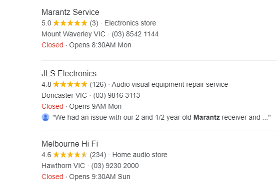

Mr_Gadget Posted August 7, 2021 Author Posted August 7, 2021 Who services Marantz these days anyway? found these couple of google hits. JLS is actually quite close by.
Quark Posted August 7, 2021 Posted August 7, 2021 1 hour ago, Mr_Gadget said: Who services Marantz these days anyway? found these couple of google hits. JLS is actually quite close by. The Mt Waverley one will be the former Qualifi business who were taken over by D&M when they decided to cut out the middleman for local distributorship. I'd go to them.
