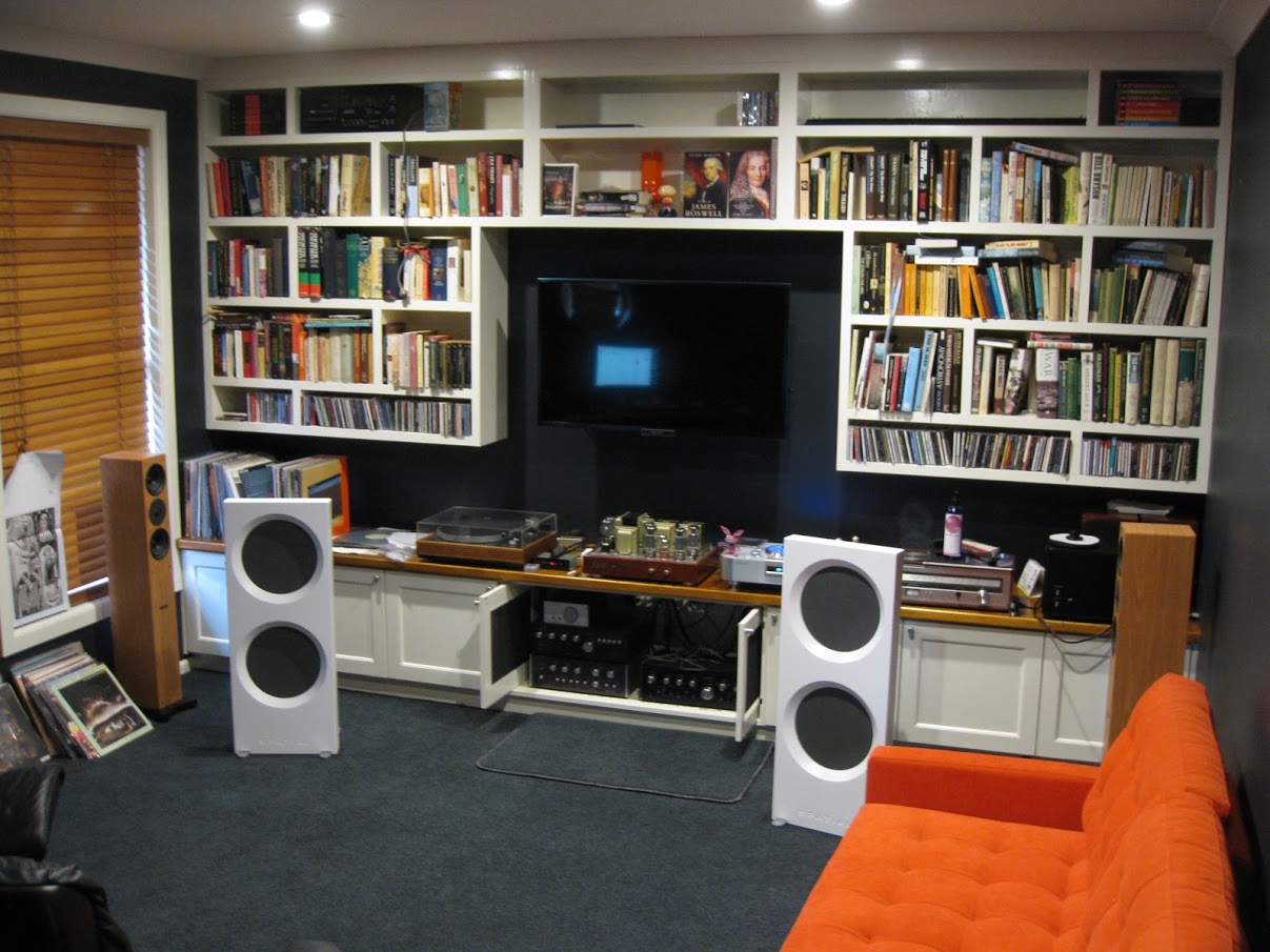

Adrian123 Posted March 30, 2022 Posted March 30, 2022 (edited) Good morning everyone. C anyone recommend someone knowledgeable to replace light glass double French doors to something more appropriate or acoustic I guess in Perth. The existing ones shake and rattle already with with a 5.1 system. I’ve an incoming upgrade for 5.2.2. Current setup Edited March 30, 2022 by Adrian123
2Brix Posted March 30, 2022 Posted March 30, 2022 (edited) 1 hour ago, Adrian123 said: Good morning everyone. C anyone recommend someone knowledgeable to replace light glass double French doors to something more appropriate or acoustic I guess in Perth. The existing ones shake and rattle already with with a 5.1 system. I’ve an incoming upgrade for 5.2.2. Current setup @Adrian123 bruh, yo camera flash aint working :0) I reckon laminated glass might solve the resonance issue and a quick gooogle revealed this https://www.toughglass.com.au/product/custom-laminated-glass/ Cheers 2B Edited March 30, 2022 by 2Brix

LogicprObe Posted April 3, 2022 Posted April 3, 2022 On 31/03/2022 at 8:46 PM, Pops110 said: Are the doors to replace the ones on the cabinet? Do you really need them on there? As they are clear glass you can still see all components in there so I would just remove them altogether. I'm sure it's not the cabinet doors. The doors are not in the picture. Double french style doors are hard to sound proof. They need to be replaced with a single solid door or one with proper glass in it. Yeah.........look at the gap under the doors for starters!
