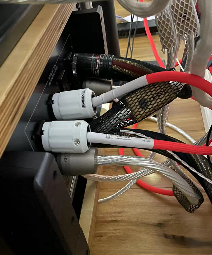

Hi,
I see you use an adapter between AUS wall and Stealth V16, did you swap the Active / Natural ?

On 07/04/2022 at 11:14 AM, mitchlim said:
Hi,
Removing the Australian wall outlet, swapping the active and neutral wiring to it, and replacing the wall outlet with swapped active and neutral would be illegal even if done by an electrician.  As for travel adaptors it wouldn't be straightforward to change their internal connections. Probably not feasible.
