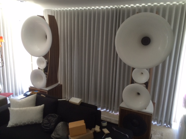

Great project, well done for giving this a go. I think you'll enjoy the sound.
I built a large two using the same horn and a Lowther 8 inch. Bass was 15-inch Voxativ in 225 litre cabinet.
Another OB was dual 18-inch AE di-poles with 300Hz Iwata horn (with Radian 950 berylium drivers), crossed at 500Hz.
I've also built an Avant Garde Trio / Cessaro homage, using Azura 160 (B&C 8 inch), 340 (JBL 2-inch CD) and 550 (JBL 1-inch CD) horns, with 15-inch Faital Pro subs. All active using MiniDSP. CNC'd walnut cabinetry, over euro birch ply. (For fun, I placed the big 160 horn up high to test in large listening room.)

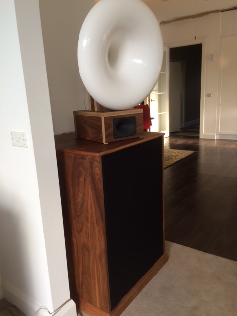

My own humble system was 15-inch Altec 416, Azura 340 and Faital Pro tweeter horn. Large 300 litre box in walnut.
Something nice about OB and horns.
Andrew
