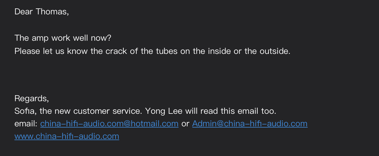

ThoFi Posted March 8, 2023 Author Posted March 8, 2023 Today I found some curious issue. First. I am not able to pull out the 6SL7 and 6SN7s….??? Second. I found some marks on both 300B tubes. What’s your thoughts? Are this scratches critical? what happens when the glass cracks… will the tube show red plate…?? Many thanks I did send china hifi an email…
Zed Zed Posted March 8, 2023 Posted March 8, 2023 1 minute ago, ThoFi said: Today I found some curious issue. First. I am not able to pull out the 6SL7 and 6SN7s….??? Second. I found some marks on both 300B tubes. What’s your thoughts? Are this scratches critical? what happens when the glass cracks… will the tube show red plate…?? Many thanks I did send china hifi an email… Whatever those marks are, they shouldn't be there on brand new tubes, so I'd be expecting a replacement set from China HiFi. I have no idea if they are dangerous, so it might be worth posting in the R8 thread to see if anyone has a view. As for not being able to pull the other tubes, that's strange too. Have you tried rocking them from side to side a little as you try to ease them out? I saw this on a YT video some time ago. The guy used a 'rolling' motion as he extracted them, hence, I guess, the term 'tube rolling' which we are familair with.
ThoFi Posted March 8, 2023 Author Posted March 8, 2023 4 minutes ago, Zed Zed said: Whatever those marks are, they shouldn't be there on brand new tubes, so I'd be expecting a replacement set from China HiFi. I have no idea if they are dangerous, so it might be worth posting in the R8 thread to see if anyone has a view. As for not being able to pull the other tubes, that's strange too. Have you tried rocking them from side to side a little as you try to ease them out? I saw this on a YT video some time ago. The guy used a 'rolling' motion as he extracted them, hence, I guess, the term 'tube rolling' which we are familair with. Zed, thanks for your quick support Now I was able to remove the tubes….but man…hard work and finally rocking did help And yes, the mark shouldn’t be there. I am afraid to turn on the amp because I want to avoid any damage! 1

Zed Zed Posted March 8, 2023 Posted March 8, 2023 1 hour ago, ThoFi said: Zed, thanks for your quick support Now I was able to remove the tubes….but man…hard work and finally rocking did help And yes, the mark shouldn’t be there. I am afraid to turn on the amp because I want to avoid any damage! Yes, I;d be the same. See if you can get an informed opinion from XLR8OR on the other thread. 1
xlr8or Posted March 9, 2023 Posted March 9, 2023 (edited) I'm sorry to see the presence of those scratches on the new 300B tubes that you have acquired with the R300. Are they a problem? Yes and no. Yes from the perspective that they are a physical flaw on the glass envelope's surface. The glass thickness is thinner in this particular location compared to the other adjacent areas. More importantly though the presence of scratches in the glass can easily turn into propagating cracks, as the tube cycles heat on and off. Once a crack develops in the glass envelope its a matter of time before air enters in and the vacuum is lost rendering the tube instantly dead and useless from any further operation. No from the perspective that the scratches are superficial and great care is taken to ensure that heat cycles are reduced to a minimum and no vibrations are apparent that can transform the scratches into potential cracks. Edited March 9, 2023 by xlr8or 1
ThoFi Posted March 9, 2023 Author Posted March 9, 2023 1 hour ago, xlr8or said: I'm sorry to see the presence of those scratches on the new 300B tubes that you have acquired with the R300. Are they a problem? Yes and no. Yes from the perspective that they are a physical flaw on the glass envelope's surface. The glass thickness is thinner in this particular location compared to the other adjacent areas. More importantly though the presence of scratches in the glass can easily turn into propagating cracks, as the tube cycles heat on and off. Once a crack develops in the glass envelope its a matter of time before air enters in and the vacuum is lost rendering the tube instantly dead and useless from any further operation. No from the perspective that the scratches are superficial and great care is taken to ensure that heat cycles are reduced to a minimum and no vibrations are apparent that can transform the scratches into potential cracks. Hi Kirk, many thanks for your reply. i do have the same understanding. Do you know what happens when the vacuum is lost. I can live with that the tube dies, transmitte no music. But I can’t accept it will cause further damages….blow a fuse, resistor. thanks
Zed Zed Posted March 9, 2023 Posted March 9, 2023 1 minute ago, ThoFi said: Hi Kirk, many thanks for your reply. i do have the same understanding. Do you know what happens when the vacuum is lost. I can live with that the tube dies, transmitte no music. But I can’t accept it will cause further damages….blow a fuse, resistor. thanks That would be my worry too, Thomas. A tube is a tube and can be easily replaced. But if the tube takes the rest of the amp with it . . . Unless you get an unequivocal, crystal-clear answer that the amp will be OK no matter what happens to the tube, I personally wouldn't use the amp until I had a new set of tubes. I can imagine how disappointing this must be for you, after all the anticipation, and then the elation of hearing the R300 for the first time. But you can't risk destroying your new amp. Have you had a response yet from China Hi-Fi? I'd hope they would be sending you replacement tubes by the fastest courier means possible.
ThoFi Posted March 9, 2023 Author Posted March 9, 2023 2 minutes ago, Zed Zed said: That would be my worry too, Thomas. A tube is a tube and can be easily replaced. But if the tube takes the rest of the amp with it . . . Unless you get an unequivocal, crystal-clear answer that the amp will be OK no matter what happens to the tube, I personally wouldn't use the amp until I had a new set of tubes. I can imagine how disappointing this must be for you, after all the anticipation, and then the elation of hearing the R300 for the first time. But you can't risk destroying your new amp. Have you had a response yet from China Hi-Fi? I'd hope they would be sending you replacement tubes by the fastest courier means possible. thank you. Yes china hifi respond to me. first they ask if the amp still works. later they ask if I would like to return the tubes to China. No option for me of course some answers from china hifi 1

xlr8or Posted March 9, 2023 Posted March 9, 2023 3 hours ago, ThoFi said: Do you know what happens when the vacuum is lost. Yes, it simply won't work at all. There is no risk of damaging any other component. It will be as if no power is being sent to that channel and the amp is switched off. Adjusting the volume knob will have no effect on that channel. Dead as door nails, as they say. 1 1
xlr8or Posted March 9, 2023 Posted March 9, 2023 @ThoFi As the 300B tubes are still new you can always buy a single one (of the exact same construction and brand) to pair up with the other existing one that has no scratches and also to have peace of mind. 2
