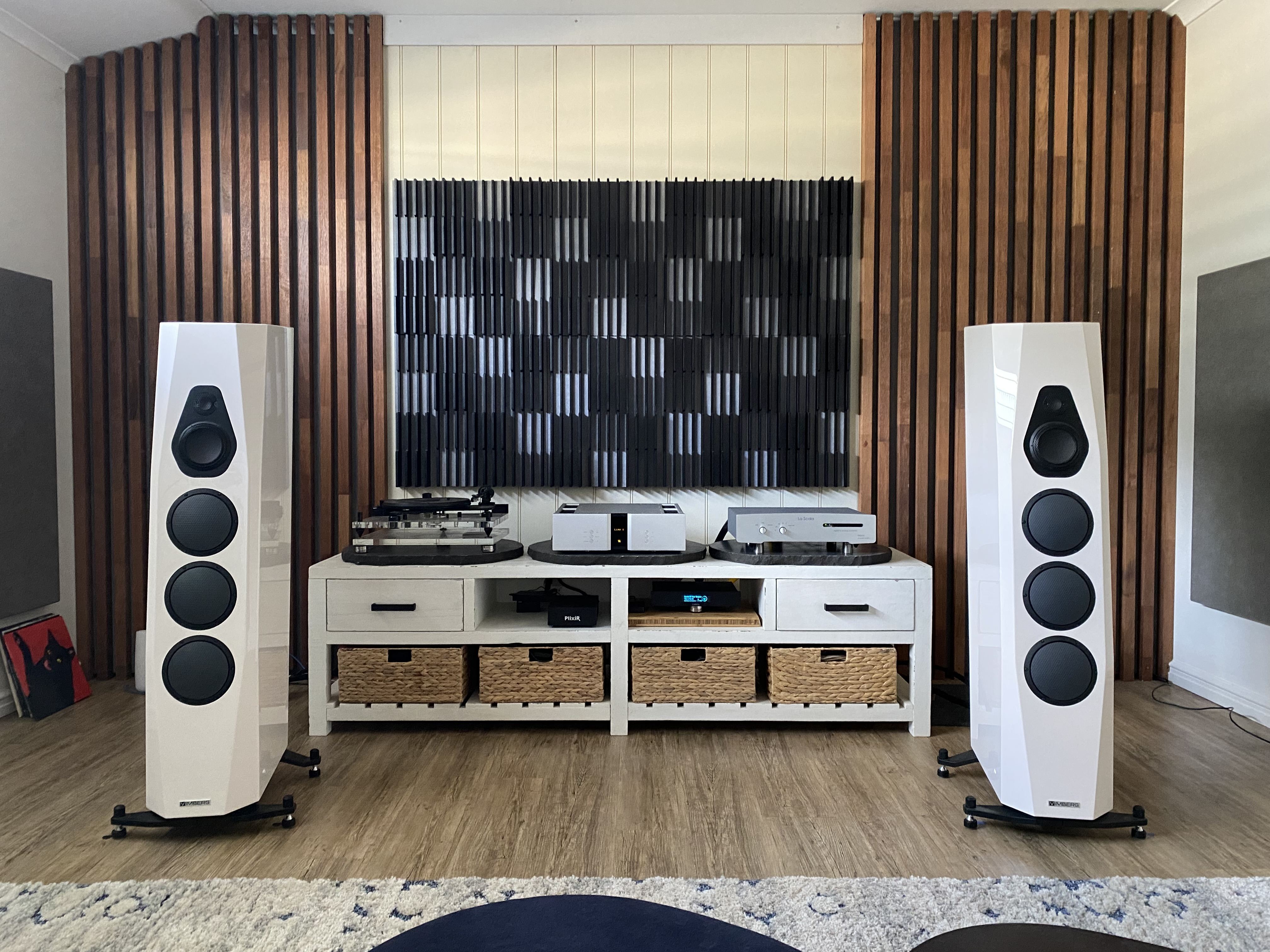

Piddi Posted July 26, 2023 Posted July 26, 2023 I used 2400x1200 sheets if CSR Martini for absorption. Two 50mm layers cut into a wooden frame , covered with breathable linen and finished off with Merbeau wooden slats. Diffusers behind speakers (Artnovion) and managing first and second reflection points (Artnovion) made all a massive difference whilst meeting the WAV. The sonic improvements are mind blowing to say the least. https://www.csrmartini.com.au/wp-content/uploads/2021/05/Martini-DataSheet-Absorb_0421.pdf 2
