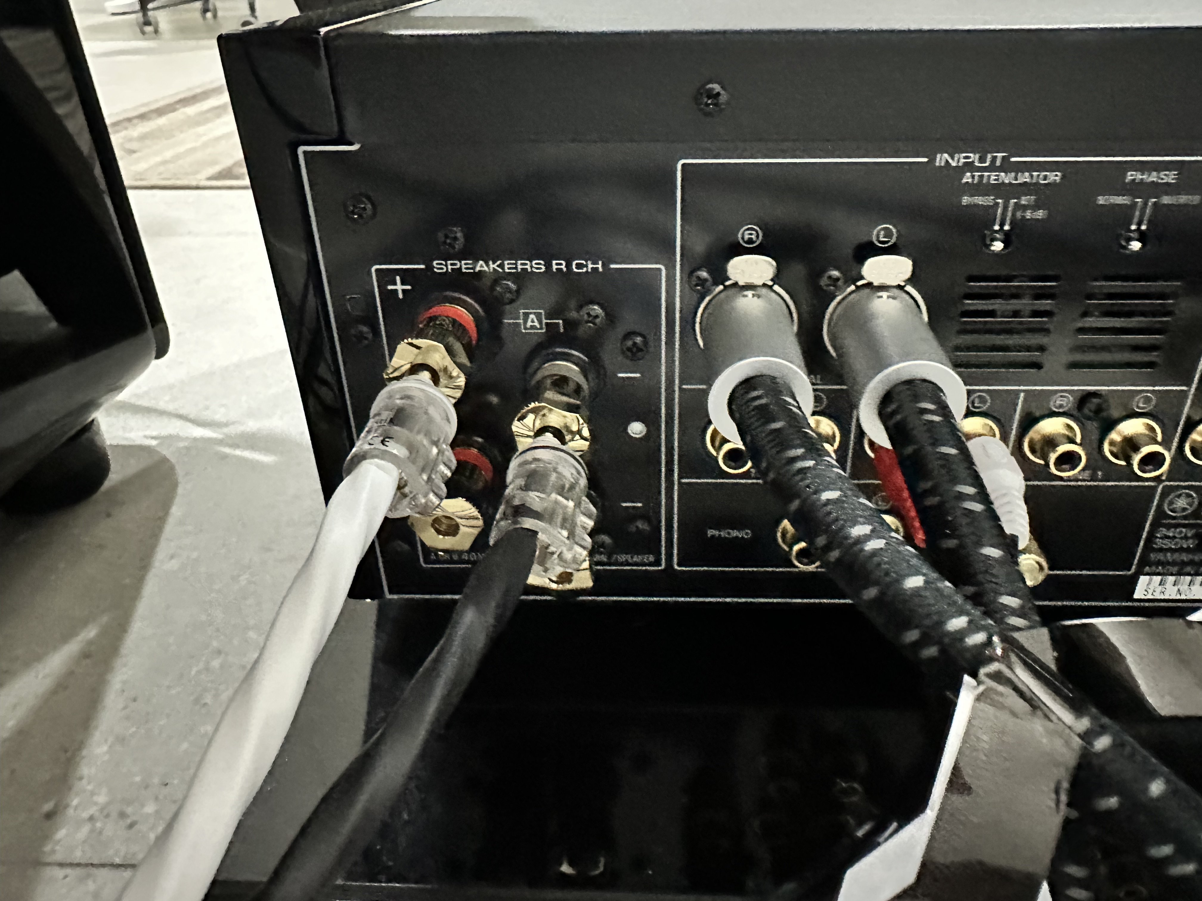

Neo Posted October 31, 2023 Posted October 31, 2023 On a separate note, do post some pictures of all your gear, how it’s set up and all the connections. While you checked it etc, fresh eyes and there’s many here, may see something that you don’t. Neo

Damranger Posted November 3, 2023 Posted November 3, 2023 (edited) 13 hours ago, Simranjit said: Sad news, the store guy gave me a different unit which he was using of the eversolo. Still the same issue The next step is to try RCA connection instead of XLR to rule out the issue with Amp. There are talks of trying a power conditioner as well. I've just found this thread and your photos of the cabling have given me a lightbulb moment. I have an A-S2200 also and although mine is fed by a Denafrips DAC, the symptoms were the same. The balanced inputs on the Yamaha are sensitive and you should try switching the attenuator (above the balanced inputs) to -6db (rather than normal). That fix the intermittent crackling / distortion that I had. I actually found the answer (and reasons) here on SNA at: Hopefully this helps Scott  (edited for early morning spelling) Edited November 3, 2023 by Damranger (edited for early morning spelling) 8 1 1
Simranjit Posted November 3, 2023 Author Posted November 3, 2023 Thanks Scott, this looks like the exact issue. I will give it a try. Based on this thread and manuals - feels like this should fix it.Â
