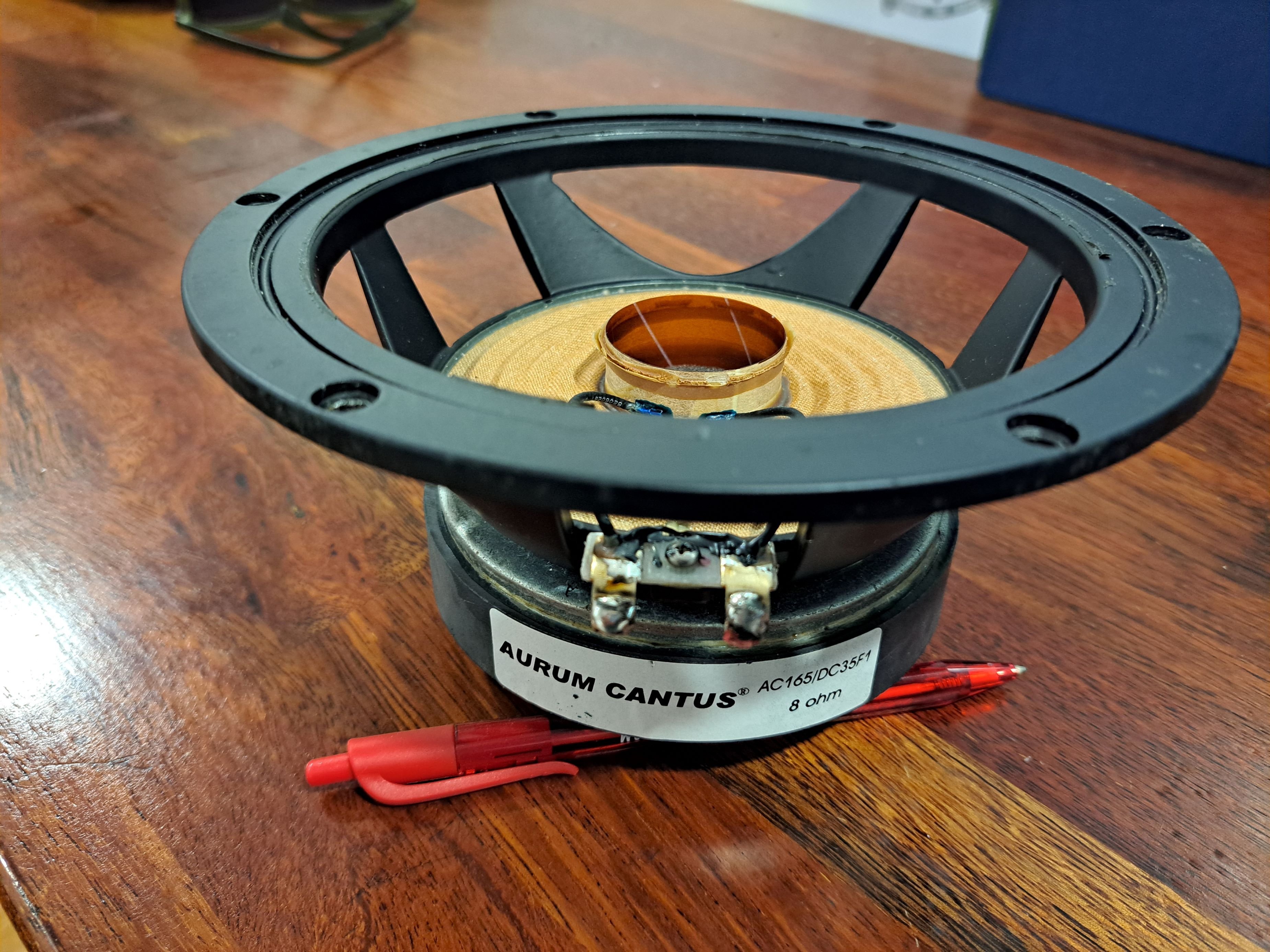

Banana Posted November 26, 2024 Posted November 26, 2024 Hi Hoping someone can point me in the direction where I can find a replacement driver. Model: AC165/DC35F1 (Aluminum frame, the compositecone(PP, carbon and mica), 35mm (1.38?) copper clad aluminum voice coil with flat wire, the special magnet system, 120mm×20mm Y30 Ferrite magnet.) Can't find anything with the 6 hole fixing pattern. Cheers Pete
andyr Posted November 26, 2024 Posted November 26, 2024 (edited) 6 hours ago, Banana said: Hi Hoping someone can point me in the direction where I can find a replacement driver. Model: AC165/DC35F1 (Aluminum frame, the composite cone(PP, carbon and mica), 35mm (1.38?) copper clad aluminum voice coil with flat wire, the special magnet system, 120mm×20mm Y30 Ferrite magnet.) Can't find anything with the 6 hole fixing pattern. Cheers Pete Are you sure this isn't an equivalent driver, for your Arum Cantus spkrs?: Sure it's only got 4 screw-holes ... but that won't be a problem. The specs are what is important. Parts Express may be able to definitively answer your question. Edited November 26, 2024 by andyr

Banana Posted November 26, 2024 Author Posted November 26, 2024 Will give that try. 2 hours ago, andyr said: Are you sure this isn't an equivalent driver, for your Arum Cantus spkrs?: Sure it's only got 4 screw-holes ... but that won't be a problem. The specs are what is important. Parts Express may be able to definitively answer your question. I was happy to see that one when I searched .... how would you modify and make it look good?

andyr Posted November 26, 2024 Posted November 26, 2024 2 minutes ago, Banana said: Will give that try. I was happy to see that one when I searched .... how would you modify and make it look good? I don't understand your question! You screw it into the rebate which contained the previous driver. You will have to drill 4 new holes in the rebate - but, because the rim of the driver hides the old holes ... you won't see them. The only thing that matters (in terms of the existing XO) ... is how the specs of the new driver compare to the original driver.
Banana Posted November 26, 2024 Author Posted November 26, 2024 (edited) 6 minutes ago, andyr said: I don't understand your question! You screw it into the rebate which contained the previous driver. You will have to drill 4 new holes in the rebate - but, because the rim of the driver hides the old holes ... you won't see them. The only thing that matters (in terms of the existing XO) ... is how the specs of the new driver compare to the original driver. But you would still see them Edited November 26, 2024 by Banana
andyr Posted November 26, 2024 Posted November 26, 2024 1 minute ago, Banana said: I would have to drill 5 new holes, not 4. Ummm - this shows 4 holes: And why would the no. of holes be a problem, anyway?
andyr Posted November 26, 2024 Posted November 26, 2024 I still don't 'get' your problem? Either: * replace *both* drivers * or put the grills on.
