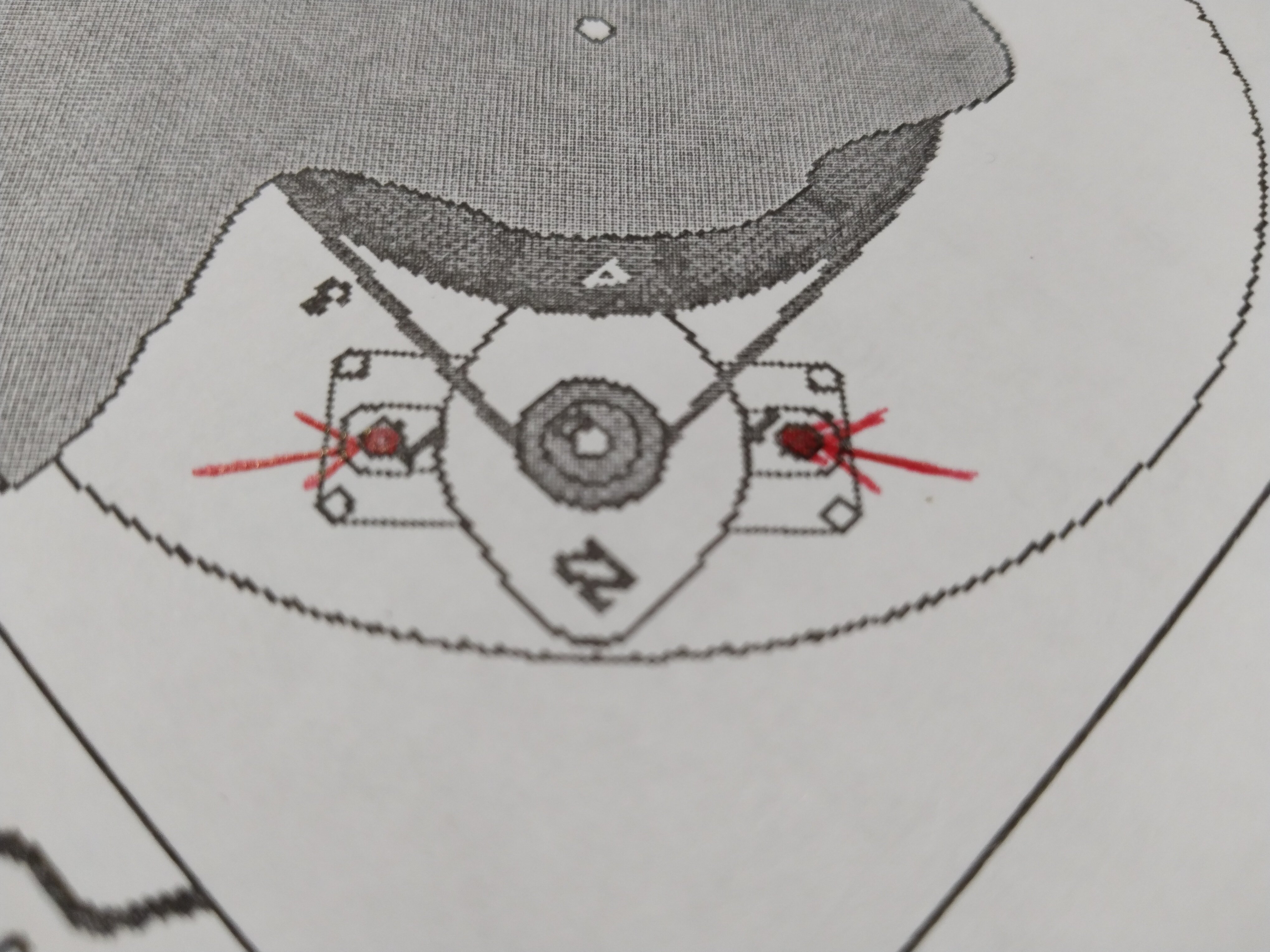

Anyway, I'm currently packing the turntable for shipping to Selby, and I'm stuck at the start trying to work out the Motor Transport Screws.
Typically, I can't remember what I did when unboxing and setting up.
The manual indicates 2 RED screws to be removed...
...but, I don't remember them, and don't have them in the box.
The TT has black screws in that location...
...which I never removed.
There is a YouTube video where these black screws are visible and not removed either...  seen about 1.10

7 minutes ago, aussievintage said:
Transport screws need to be removed.  From the photo, it appears the motor should then sit isolated on the rubber mounting.
Thankyou.
I don't know how I missed it, I know about transport screws, I read all manuals.
I think that the manual indicating they are red screws has thrown me off, but I should have removed something.  I am slapping my own head... very hard.  I listened to the TT as was, for at least 2 years.
Thanks again for a prompt reply and saving me a lot of time.
I've removed the 2 black screws, lo and behold, problem solved.
