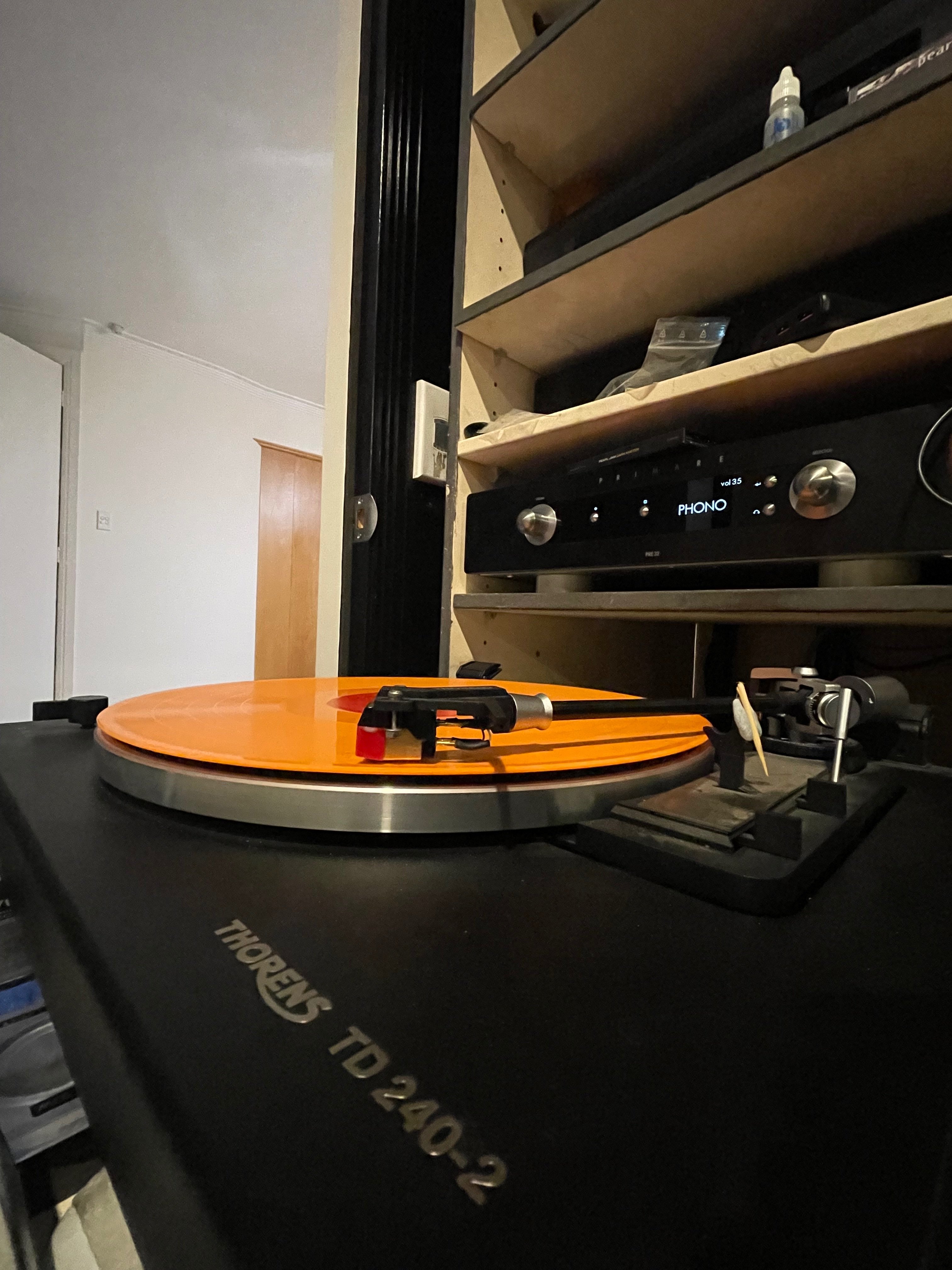

e83cc Posted April 2 Posted April 2 38 minutes ago, Kaynin said: Bulltish. There you go mate - I put structural uprights inside the wall. The floating shelf could take 2 guys standing on it without moving. There are some on this forum who actually do stuff, no tish. 2 1
Kaynin Posted April 2 Posted April 2 (edited) 1 hour ago, e83cc said: There you go mate - I put structural uprights inside the wall. The floating shelf could take 2 guys standing on it without moving. There are some on this forum who actually do stuff, no tish. Great work Nick, I love it. Over-engineering at its best, just my style. Very impressive. Edited April 2 by Kaynin 1
