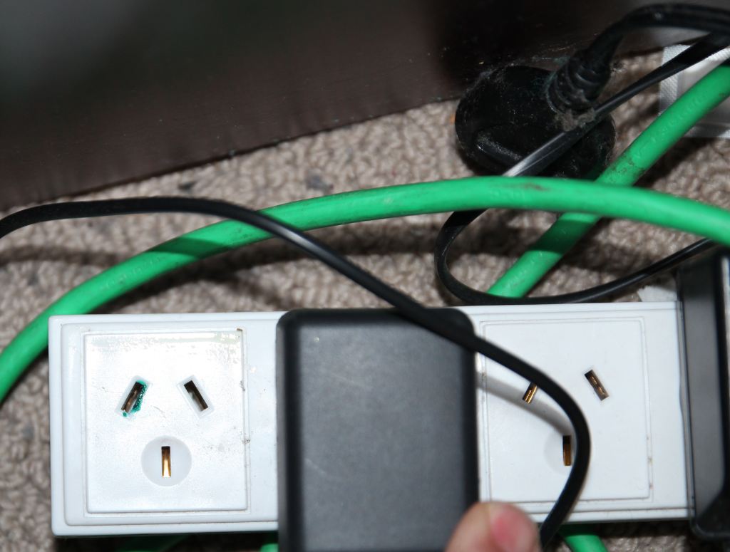

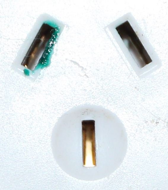

rocky500 Posted June 28, 2014 Author Posted June 28, 2014 (edited) There was one power board that looks suspect. In the bedroom wedged under the bed that had some green goo on it and the cable plugged into it is oily. Will do some vacuuming and replace that one before I pug it in again. Did have a cat recently......., I wonder. Edited June 28, 2014 by rocky500
Sub Sonic Posted June 28, 2014 Posted June 28, 2014 The green goo looks like something that comes out of some older mains cables (house wiring) from maybe around the 70's. It was apparently a reaction between the copper and a powder that was put in between the copper/insulation to assist with stripping the wire, or something like that. It is commonly noticed around switches in some older houses but also at power points. Was the plug possibly plugged into a power point like this at some stage, not necessarily in your house? It may have transferred the green goo to your power board. I have tested the green goo with an insulation resistance tester (1,000V) and not found it to be a problem but if anyone does see it at their switches or power points it might be a good idea to get the switch or power point (power board?) replaced, just to be on the safe side. Cheers! SS 2

rocky500 Posted June 28, 2014 Author Posted June 28, 2014 (edited) in some ways its great have found a likely suspect ! we have had an intermittent issue at our place. and am still on the hunt ! subsonic I wish you were in melb, I'd have you over to pick your brains in our case its always when we get up...ie 5:30am-6am the power has tripped and it happens spuratically... with weeks between the occurrence... 3 occasions so far... been keeping a log. 28 may...8june ... 25th june cant blame the heater...or ac... nothing much else is on before we wake up. only thing can think of so far is fridge going on a defrost cycle. if becomes too regular ...maybe we need a new fridge We had a problem like that at around the same time in the morning. We would wake up to no power. (Not that early of a riser) We had a older outside fridge for drinks and since we replaced that one, it has not reappeared! That was a good 5 or so years ago. Edited June 28, 2014 by rocky500 1
rocky500 Posted June 28, 2014 Author Posted June 28, 2014 The green goo looks like something that comes out of some older mains cables (house wiring) from maybe around the 70's. It was apparently a reaction between the copper and a powder that was put in between the copper/insulation to assist with stripping the wire, or something like that. It is commonly noticed around switches in some older houses but also at power points. Was the plug possibly plugged into a power point like this at some stage, not necessarily in your house? It may have transferred the green goo to your power board. I have tested the green goo with an insulation resistance tester (1,000V) and not found it to be a problem but if anyone does see it at their switches or power points it might be a good idea to get the switch or power point (power board?) replaced, just to be on the safe side. Cheers! SS It was the pins of the plug from a very vintage clock radio that were also going this green colour. I cleaned the pins with metal polish and have replaced the power board. 1
