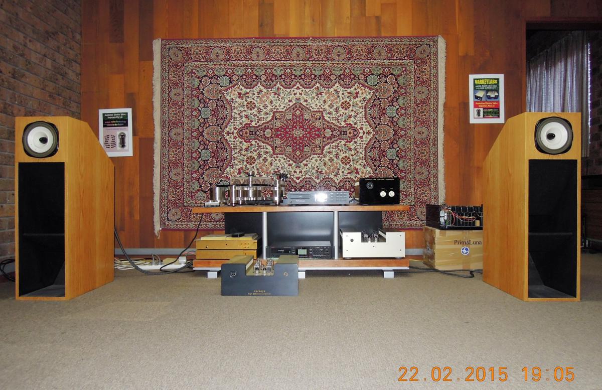

Owen Y Posted February 16, 2015 Posted February 16, 2015 Hi Ken - I have similar 140Hz Tractrix midhorns (Oris were 150Hz Fc). I used Lowthers for over 10yrs - PM2C, PM4. I gave up on them in the end. One of the problems with Lowthers (& also an appealing aspect) is the shelved-up upper midrange - 2.5kHz - 8kHz.. The midhorn lifts the 200+Hz region, which helps tonal balance, but ultimately the peaky upper range will always tend to overshadow the lower octaves. The EX drivers have the new whizzer & 'holey' phase plug, which attempt to ameliorate these issues. Newman's angling recommendation is mandatory with Lowthers as off-axis response is flatter. And I concur with Mohan, IME too, Lowthers are unforgiving with many amp types. Your 10" Mini Onkens are smallish drivers & the vented cab probably drops off like a cliff below maybe 70-80Hz(?). You could try wall and/or corner loading them, which will help extension. However IMHO the main problem is the Lowther. Psychoacoustically, the ear will always be drawn to the upper range 'presence'. Some folks add a notch filter - I haven''t gone down that road. I found that the inexpensive SEAS FA22RCZ driver to be much warmer, flatter response & forgiving. It still has some whizzer upper range problems, but I cut off the upper end with a simple xover & add a tweeter. Sorry, this is disjointed information, but if anything strikes a chord, I can elaborate a bit. (You can see my midhorns at the link below.) Cheers, Owen Dark Lantern blog - http://darklanternforowen.wordpress.com/
Mohan Varkey Posted February 17, 2015 Posted February 17, 2015 Hi Owen, nice pictures. Quite a few of our Lowther Club members are into photography as well. A common trait perhaps. IMHO Lowther is like a Ferrari. You cannot drive it on dirt roads and expect good handling. The Front end is very important. LPs are the way to go. Koetsu Rosewood and Goldbug Brier are my preferred choices. More recently, I am listening to an expensive Lyra cartridge.There are only a handful of CD players that mate well with Lowthers. I have been using Cambridge CD3 player (made in England) for more than 15 years. Other CD players that mate well with Lowthers are Stax Quattro, Copeland, DCS, an old Nakamichi etc.. In the early days with Lowther, It took me some months to figure out why Lowthers sounded better in the next room. Never toe-in as yourself and Newman have pointed out. I am a Lowther person and I would not compromise on the musical detail, transient response and dynamics of Lowthers. Quad ESL57are slow by comparison. My Stax F83s at home are ever so slighty more responsive than Lowthers. I am talking about Piano recordings. Regards, Mohan
