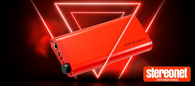

iFi's iDSD Diablo reference portable DAC/headphone amp is dressed in devilish red and, like a lightweight, high-performance sports car, kicks the non-essential features, such as sonic tailoring options and Bluetooth connectivity, to the curb. Instead, the focus for the ultra-high-quality circuit components here is pure sonic power, and the ability to drive any headphones. All you need to do is connect your digital source via USB or S/PDIF, plug in your headphones and hold on.

Along with a standard 6.3mm single-ended headphone socket, you'll also find a 4.4mm Pentaconn output for headphones offering balanced connection at the front of the unit. In terms of power, the balanced headphone output delivers 12.6V/4980mW into 32 ohms and 19.2V/611mW into 600 ohms, while the single-ended output supplies 8.8V/2417mW into 32 ohms and 9.6V/153mW into 600 ohms.
At the back of the chassis are two digital audio inputs: USB-A and a S/PDIF socket that accepts both electrical and optical signals. The former via a 3.5mm connector and the latter via a supplied adapter. A separate USB-C charging port is also provided, along with a fixed line-level 4.4mm Pentaconn balanced output to connect an external amp.
