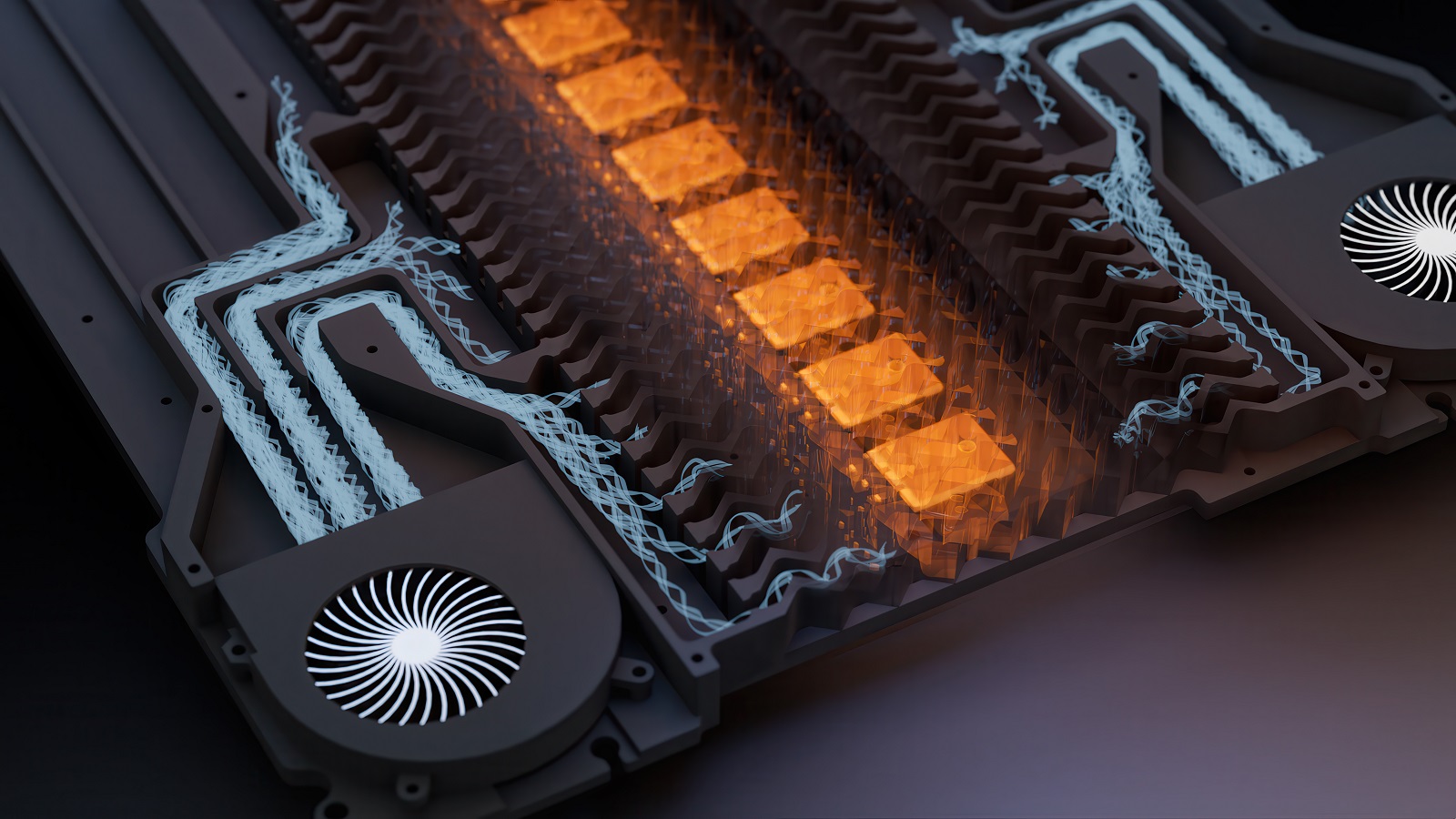

Keeping things cool is a brand-new thermal management system—a hybrid cooling matrix—which ensures that the amplifier can adapt to varying demands while remaining whisper-quiet.
All internal electronics are mounted upside-down to a sub-chassis structure comprising a highly conductive block of hard-anodised aluminium mounted to a thermal plate. This sub-chassis draws heat away from the electronics beneath and is isolated from the amp's main casework.
The thermal plate is adorned with a series of machined fins, the placement of which has been optimised using sophisticated simulation software. This network of fins creates a labyrinth of precisely measured channels atop the thermal plate.
Under normal conditions, this natural convection and radiation system uses the fins to disperse heat upwards and out through precision-cut gills in the amplifier's upper casework. However, when the amp is pushed harder, this is where the Solo 500's hybrid cooling matrix gets really clever and switches to active cooling, employing two internal fans within the product.
The fans, controlled by an FPGA processor in real time, force cool air around the network of channels on top of the thermal plate. The fan speed is determined by the amplifier's measured internal temperature and the input audio signal. This ensures the fans run inaudibly at the lowest speed possible while providing ample cooling to avoid overheating and maintain ideal performance.

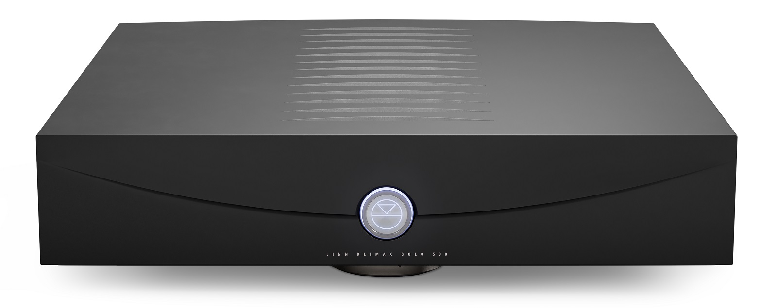

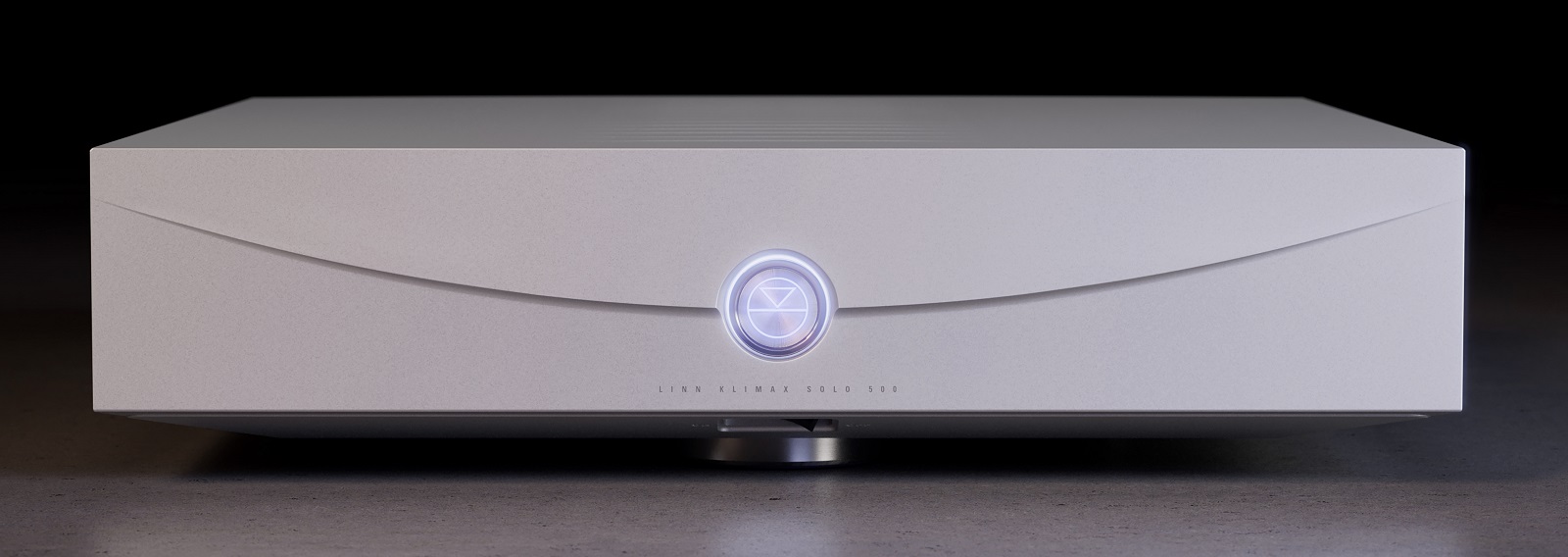

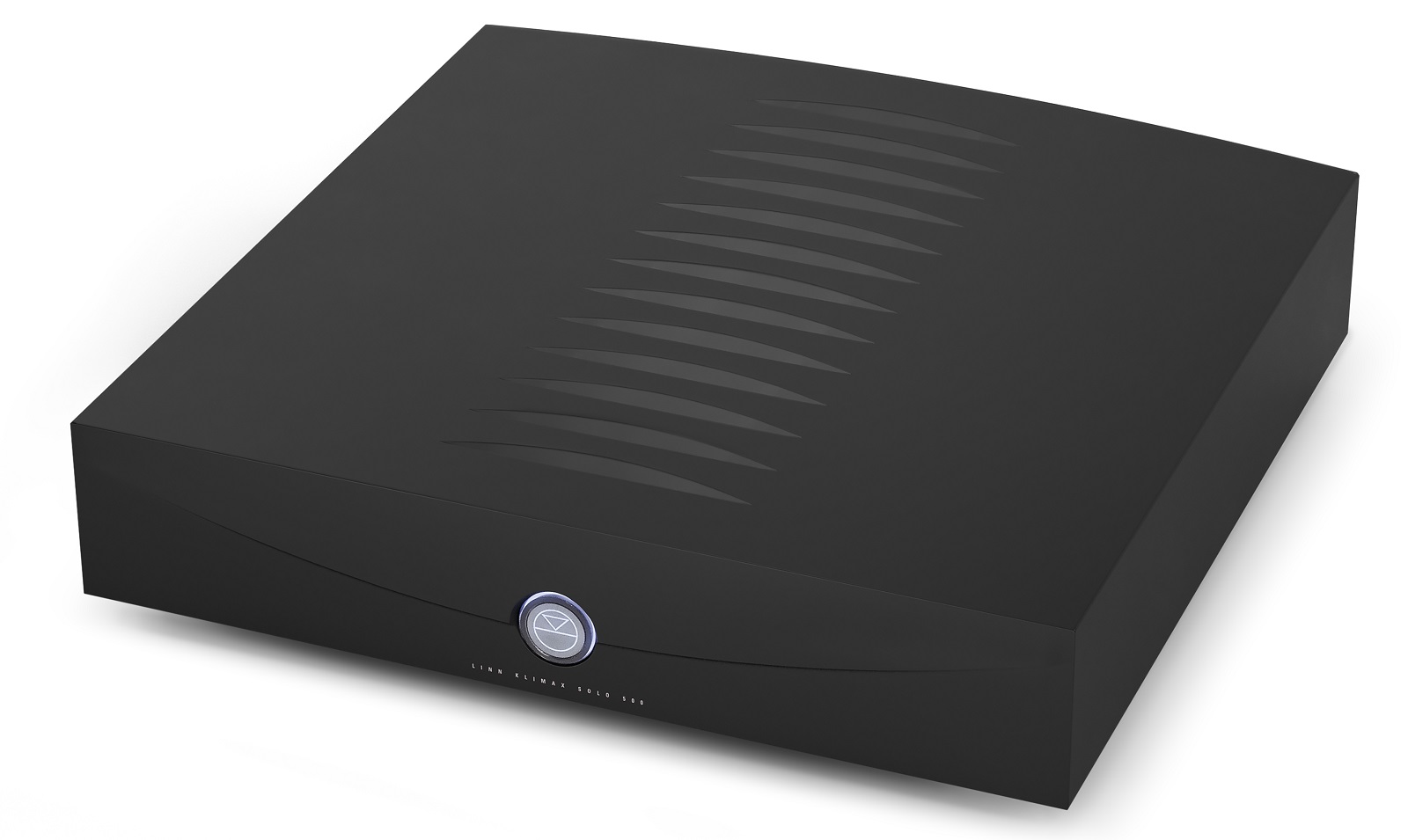

The Linn Klimax Solo 500's aluminium casement is a seamless construction composed of three precision-machined pieces—baseplate, enclosure and rear panel.

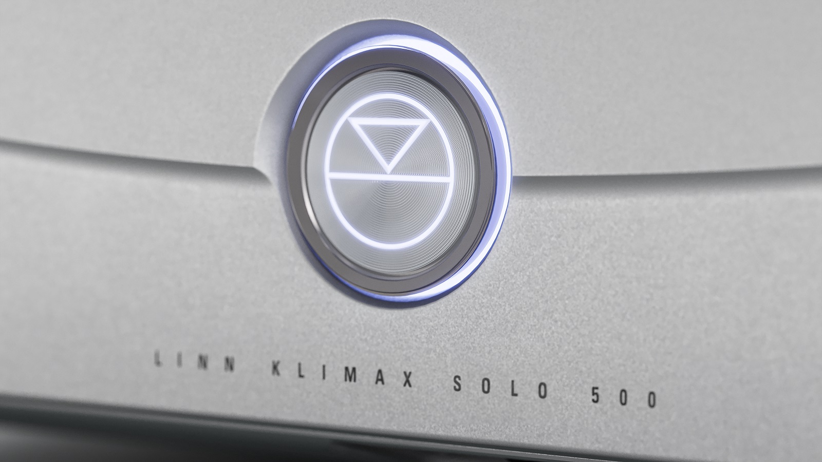

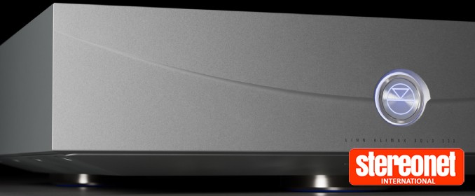

The shape of its face is new, a modern evolution of the signature Linn 'smile'. Below the smile is a completely flat face, whilst the top half is machined with a compound curve on two axes. Linn states this "precision-machined detail produces a pleasing variety of reflections" in different lighting.
A variable fillet cut in the aluminium grows towards a chamfered edge and eye-catching centrepiece; a back-lit Linn badge in the centre of a miniature roundel, with radial-grooved chrome trim and a steel outer ring.
Gentle animations of the LEDs behind the mini-roundel communicate the amplifier's status. When operational, white light diffuses, producing a soft glow around the outside of this attractive and fine detail. The badge assembly also has depth, reflecting light dynamically when viewed from different positions.

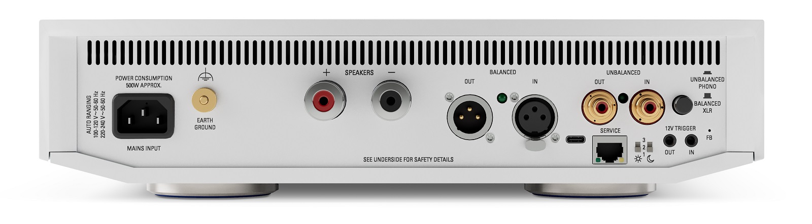

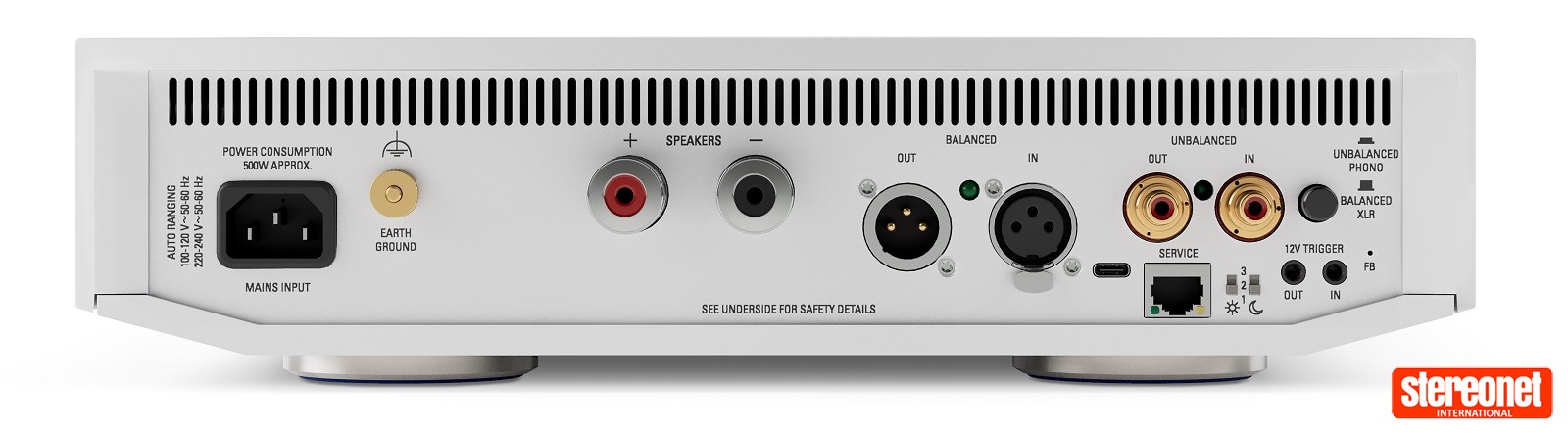

The rear I/O panel features RCA and Balanced inputs alongside RCA and Balanced passthrough connections. The speaker binding posts accept banana and spade connectors.
