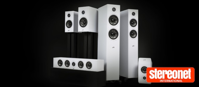

The new range is touted as being a high-performance, versatile loudspeaker line comprising nine models including three floor-standing models, three centre channels, two bookshelf speakers and a wall-and speaker-mountable height module. The Reserve Series should have everything covered for music, movies and gaming, with them boasting IMAX Enhanced and Hi-Res Audio Certification and Dolby Atmos and DTS:X compatibility.
Polk Audio Reserve Series
The Polk Reserve Series is said to borrow the same custom-made transducers developed for the company's flagship Legend Series (first seen at the StereoNET Hi-FI Show in 2019).  However, while they may share the proprietary 1-inch Pinnacle ring radiator tweeter and Turbine Cone midrange, the Reserve also benefits from Polk's latest bass-management and resonance control technologies - PowerPort and X-Port. This is all housed in newly-designed internally-braced cabinets.
