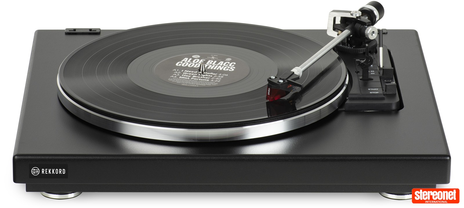

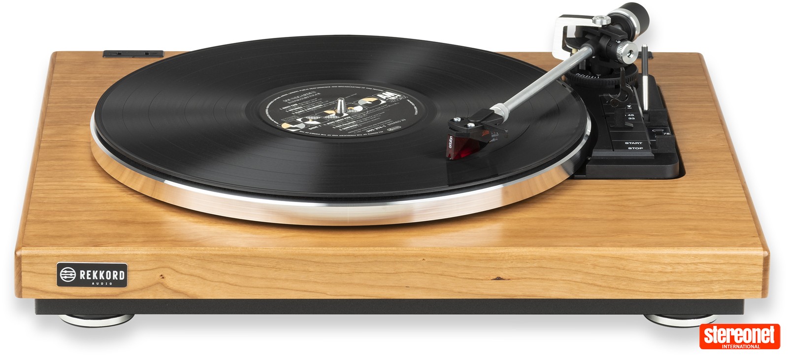

The F400 is the top model of four in this fully automatic turntable range. It uses a belt-driven subplatter that only touches the aluminium platter at three points, to isolate and minimise the transfer of resonances. The subchassis that holds the tonearm, bearing and platter, and the mechanically automated system, is decoupled from the chassis and suspended in a stiff yet squidgy way by means of elastomer, not springs. It certainly doesn't float like an LP12, but it does have some compliance. The platter has a ring of rubber attached to its underside edge to add rotational mass and dampen resonances. A 3mm felt mat sits on top.

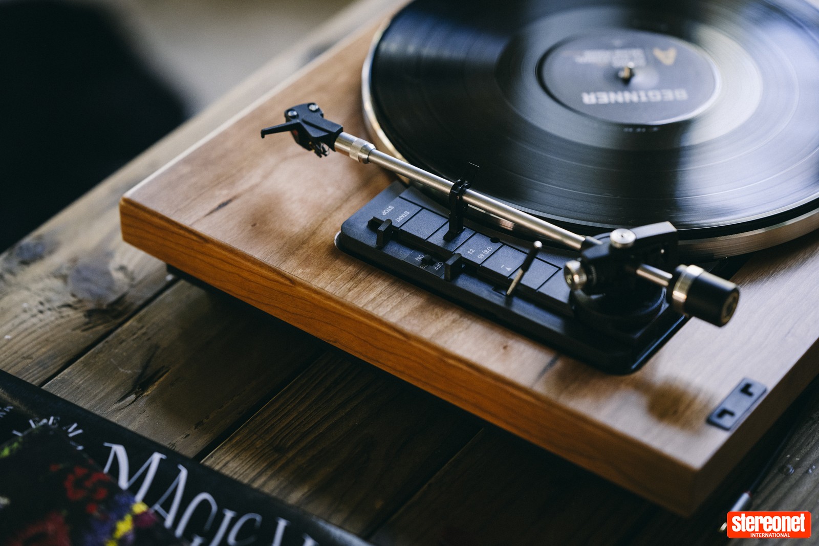

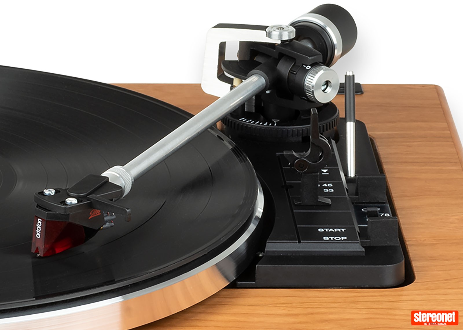

The deck uses a higher quality tonearm than others in the automatic range, one which sports an ultra-low mass aluminium tube with a carbon fibre reinforced headshell fitted with a locking ring. An Ortofon 2M Red moving magnet cartridge is fitted, which tracks at a recommended 1.8g. The effective tonearm length is 211mm, and it uses steel cardan bearings that are made in-house. The tracking force adjustment is massless, and set up so that the centre of gravity lines up with the centre of the bearing. Rekkord uses a precision flat coil spring to apply the force.
Despite the turntable's controls being made of plastic – which doesn't exactly impart a luxurious feel – it is generally well-engineered and uses a time-tested mechanical assembly that's reliable and silent in use. The deck plays 33, 45 and 78 rpm speeds, which are selected via a lever and a switch; as it doesn't require a belt pulley change, it's more convenient than many rivals.

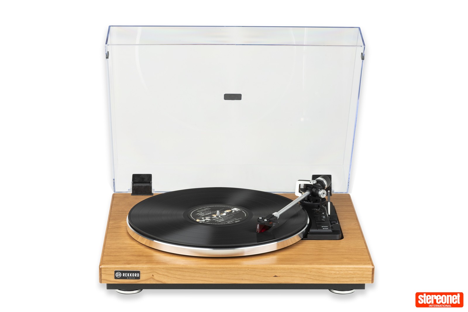

The deck weighs in at 6.3kg, so is more solid than one might expect. The plinth is a single piece of 29mm thick MDF that has been CNC machined and then finished in a choice of satin black, high gloss black, and cherry real wood veneers, some which come at an additional cost. My sample was in gloss black and looked immaculate and classy. A good quality clear acrylic dust cover is included with the table. A 15V DC adapter supplies the power.
