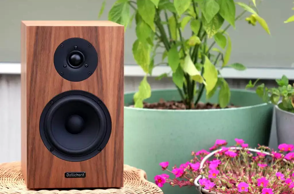

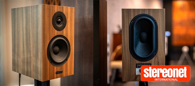

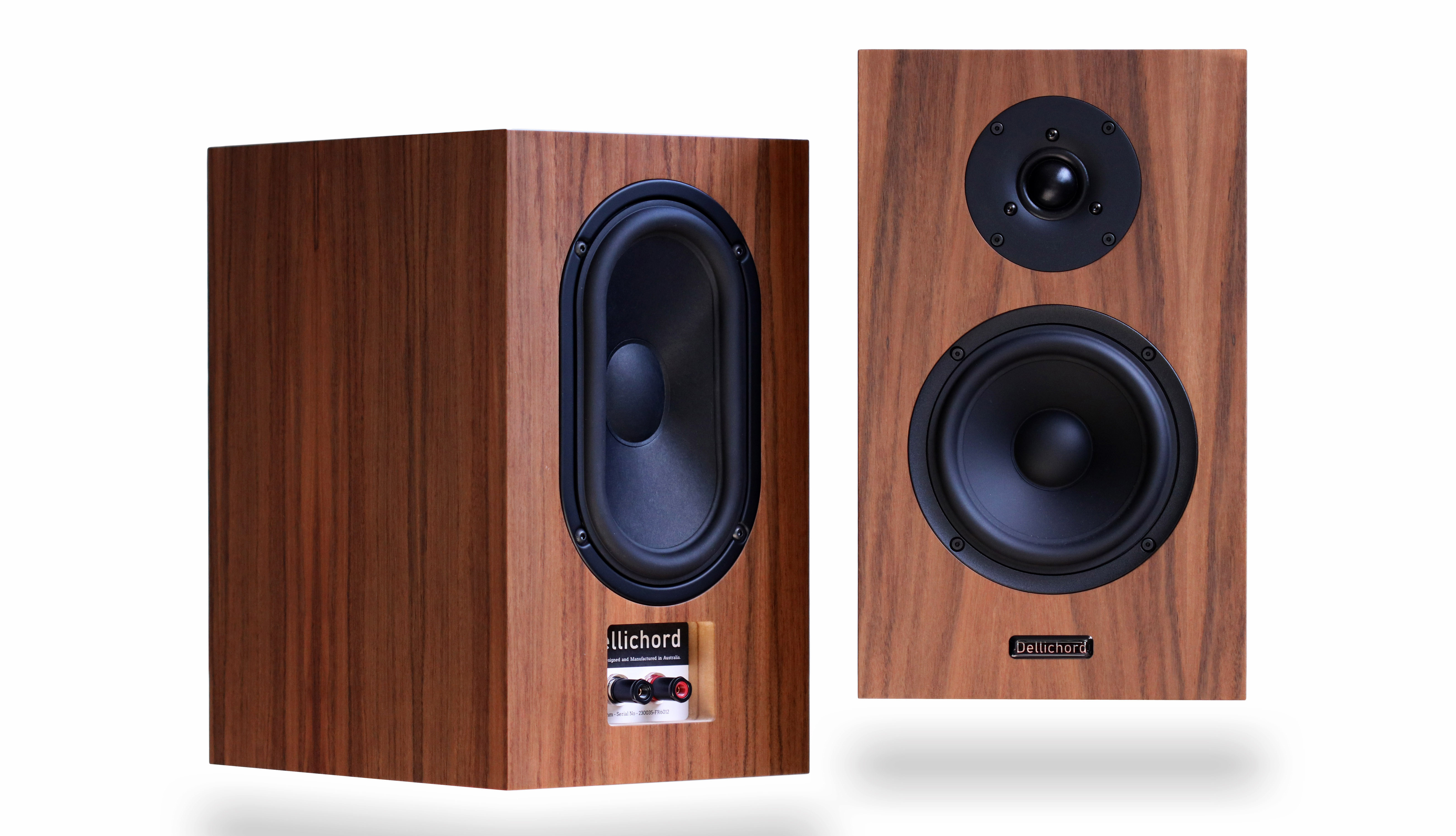

The FR6 is a stand-mount loudspeaker, measuring just 385mm high x 230mm wide x 330mm deep, with a frequency response of 33Hz – 20Khz, and by all accounts to date, its output most certainly belies its compact size.

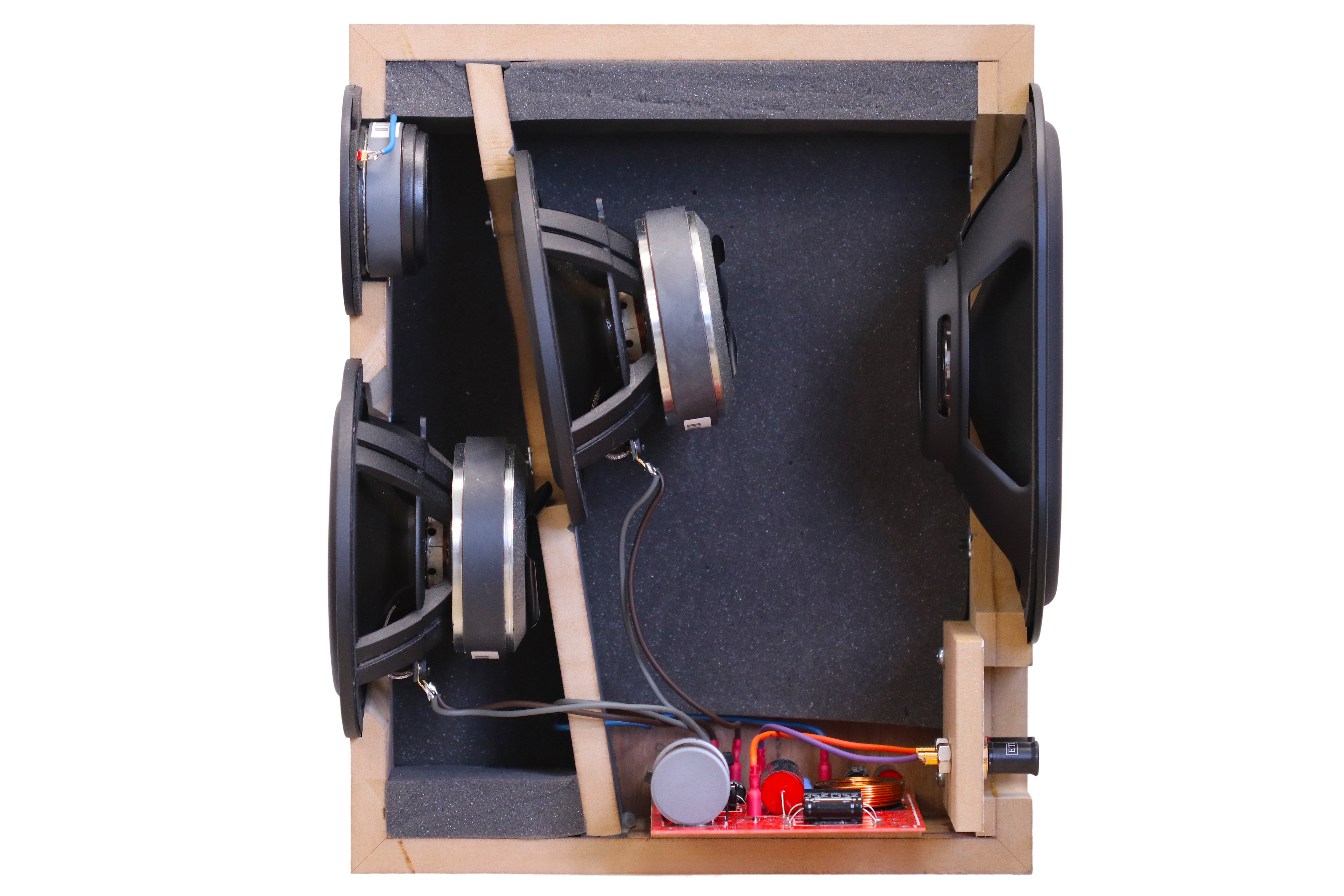

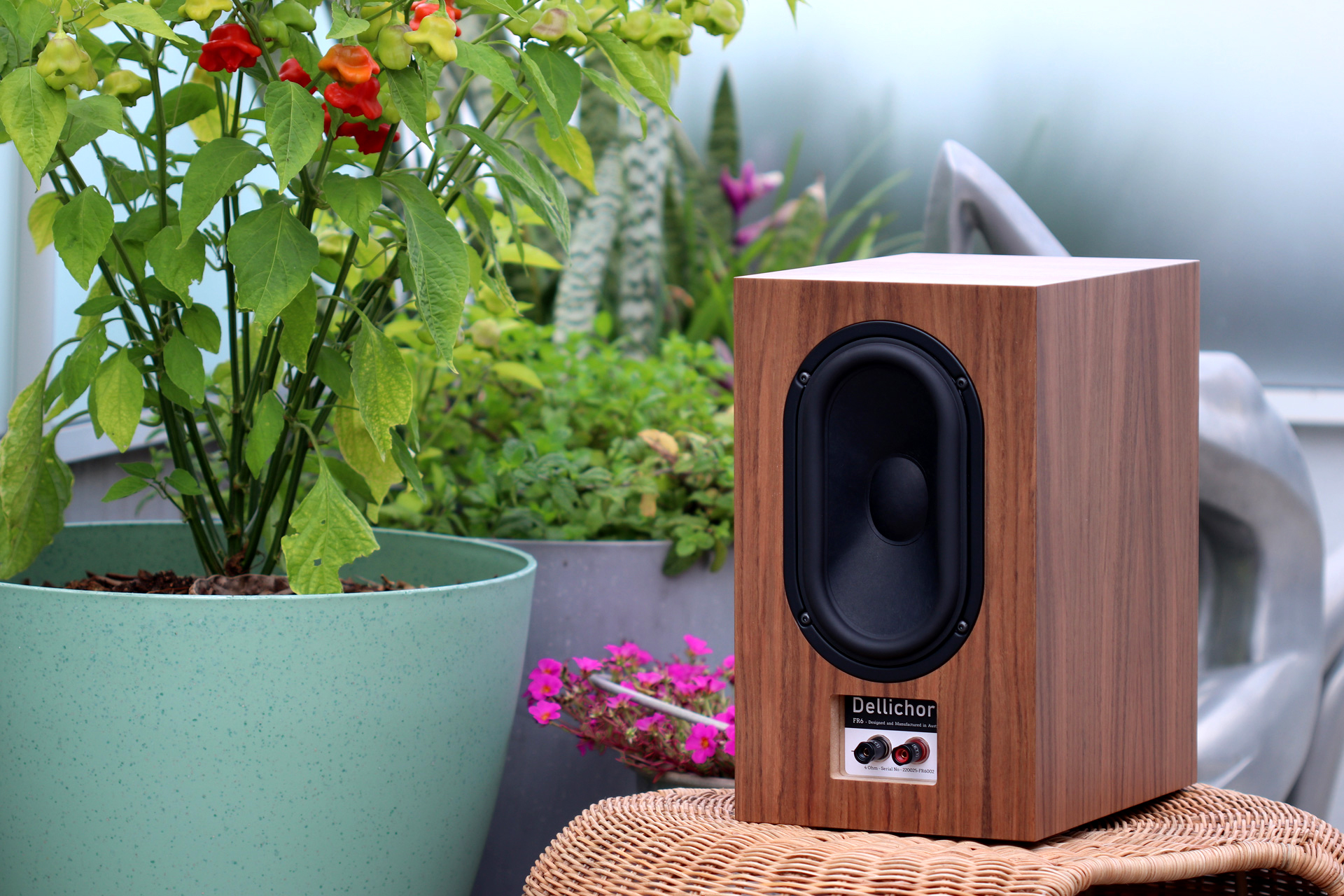

The FR6 is a deceptively complex little speaker. It employs two 165mm mid-bass drive units (one hidden inside the enclosure in a compound arrangement sometimes referred to as 'isobaric'), the other visible on the front baffle as usual. Around the back is an oval passive radiator. For those unfamiliar, it looks very much like another drive unit but is not electrically connected, offering turbulence-free extra deep bass instead of a reflex port.
Hutchison says, "This design was called on for a few reasons. Firstly an isobaric arrangement allows us to make the cabinet smaller for a given amount of low bass extension. Using a passive radiator avoids the 'chuffing' or port noise of a port while, again, avoiding having to make the enclosure larger to contain the port. These are the two main reasons the FR6 reaches deep into the bass like a largish subwoofer and yet can easily sit on a TV cabinet or bookshelf."

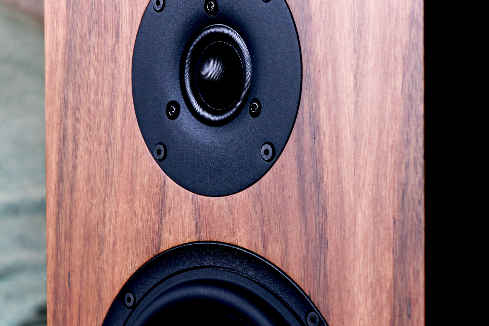

The Dellichord FR6 also employs a wide surround 29mm soft dome tweeter with a dispersion pattern that Hutchison says "at higher frequencies is also less likely to excite reflections in modern rooms". The tweeter also has its own small rear chamber, which imbues it with a very low resonant frequency, as the FR6 employs a relatively low crossover frequency of 1700Hz, we're told.

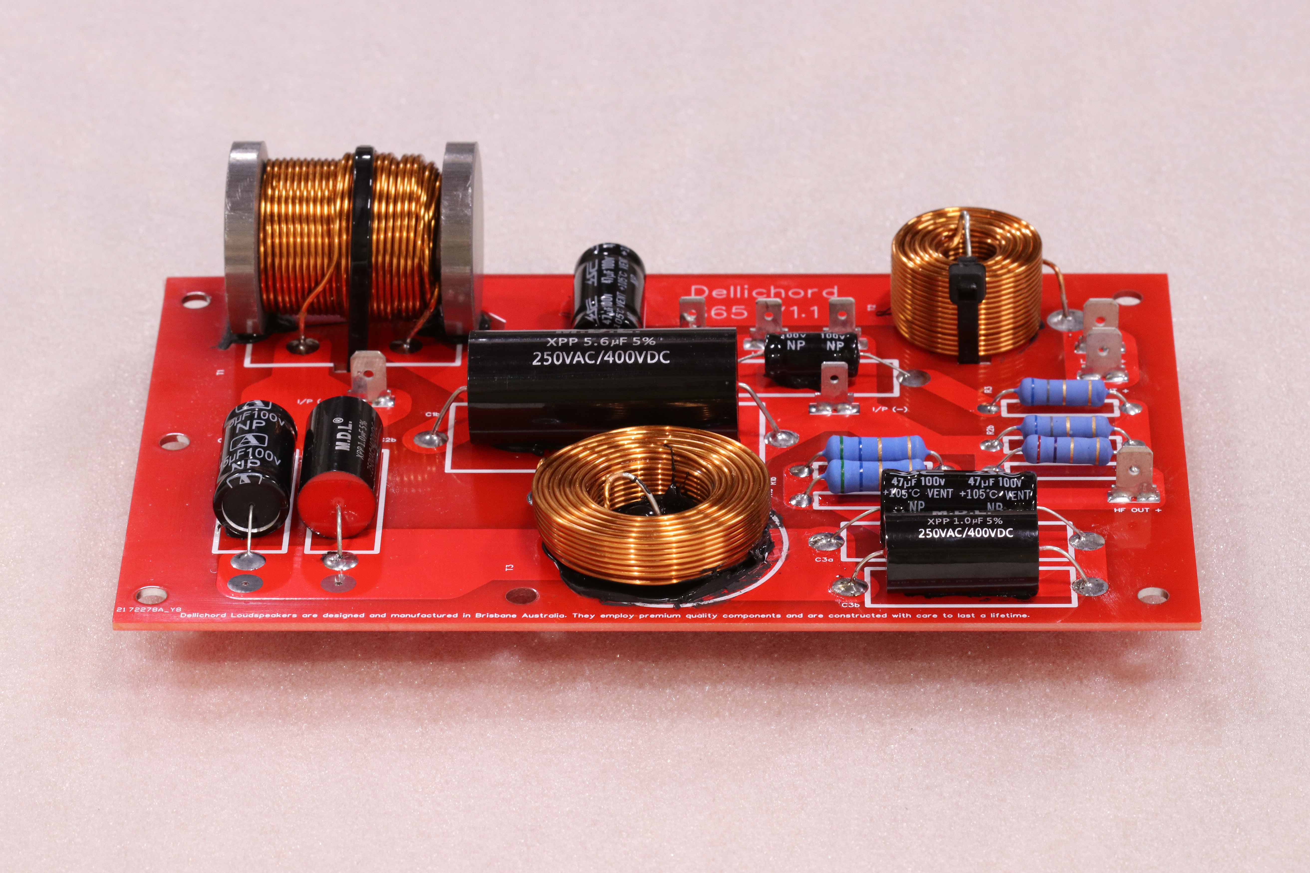

As you would expect, the crossover (designed and assembled in-house) and its components employed are of premium quality, including metal film resistors, polypropylene capacitors and both air-cored and P-cored inductors.
